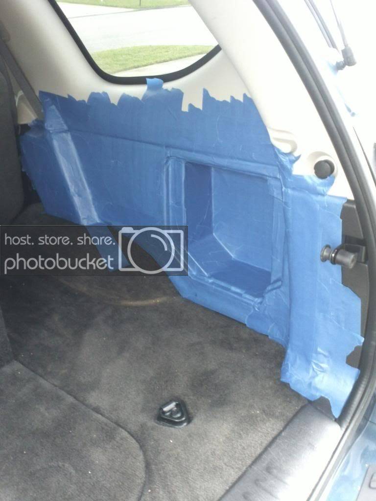

well anyways it has begun... didnt get where i wanted because my drill wasnt charged and died on me. also the blue painters tape i bought wont stick to the plastic panel so i will either have to try another brand of blue tape or come up with another option... anyways here is the start of what i hope will be a nice box.

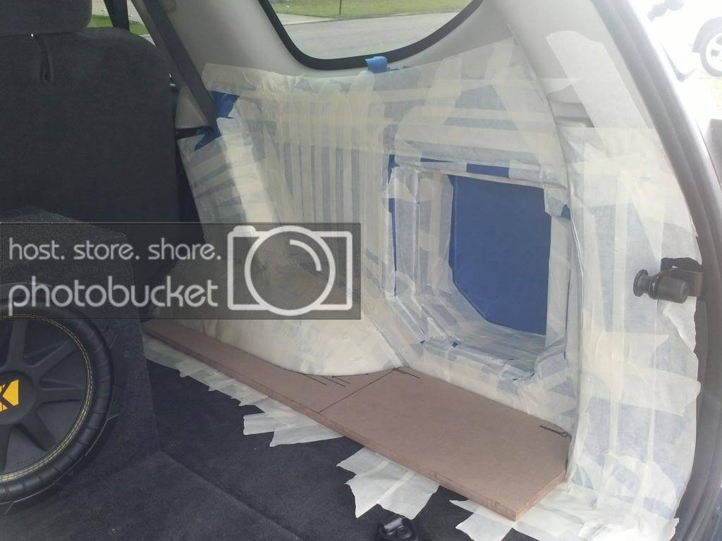

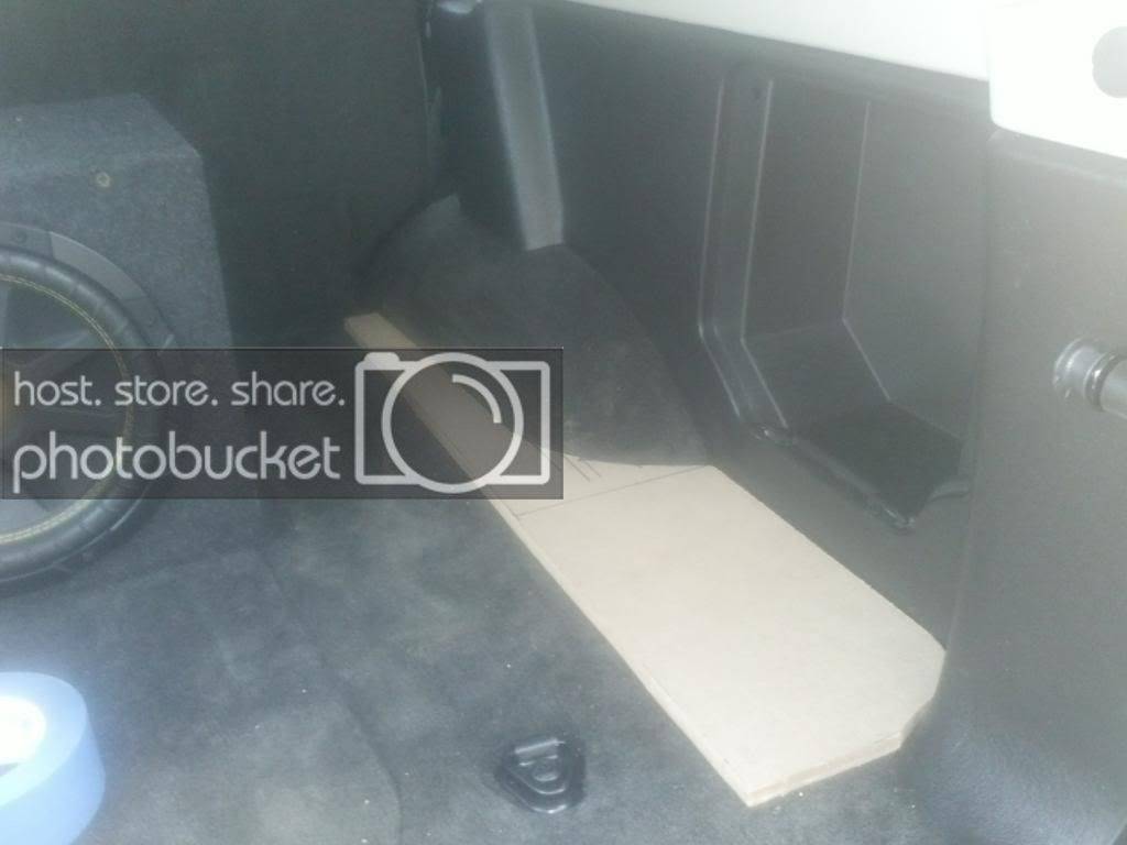

yeah im hoping i can get some decent sound out of it..... i opened up that cubby area to try and get more space for the sub(going to make a mold of it) sub will be place directly in front of the cubby hole and the port on the opposite way of the box facing into the cargo area.

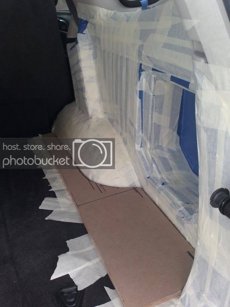

well this thing is almost ready to start glassing the mold.... just gotta lay down some foil and tape to hold it up then can glass... hopefully i will be able to get a layer or two done saturday....

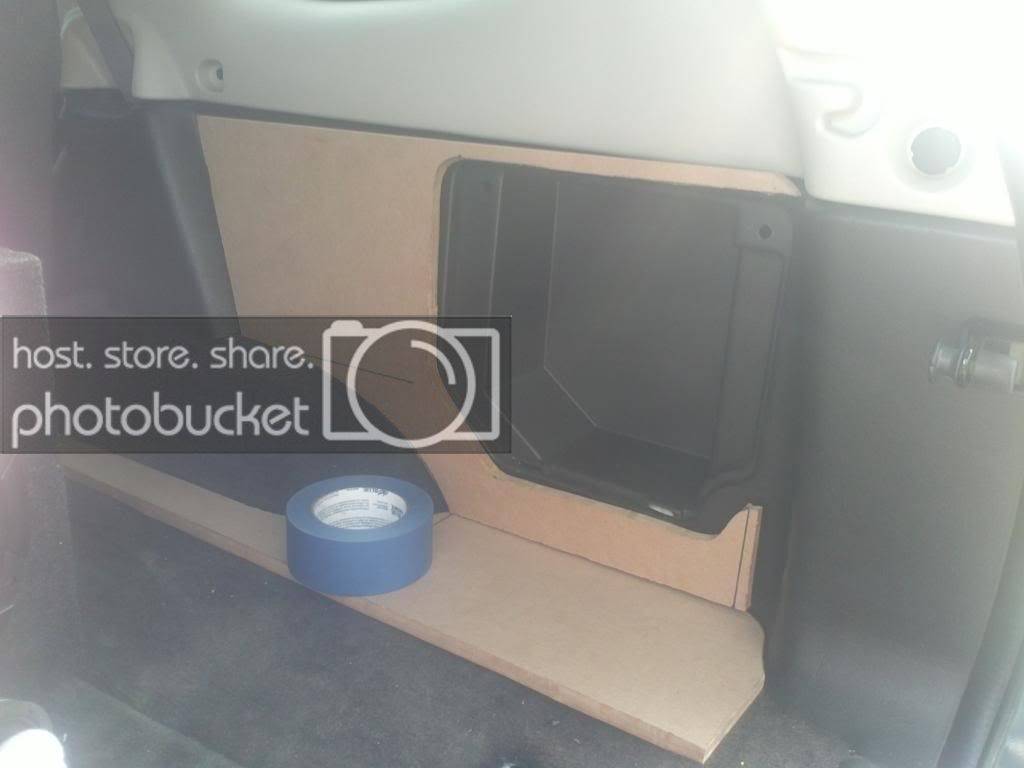

anyways i had a idea of doing the back wall wood and just molding the cubby to it as pictured below but i scratched that idea after trying to get it to line up and the one end breaking on me. so with that said the only mdf will be the base and trying to possibly have a small top piece but we shall see....
the back wall i tossed to the side
start of the tape job(which btw ***** lol)
had to pick up masking tape for the floor and well i got carried away lol

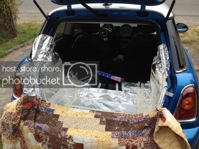

Instead of tape everywhere, I use tin foil with tape on seams. Covers easy, no gooey tape mess, fiberglass sticks just fine, mold pops right out.

my next step is to lay down foil then start the mold. how may layers did you lay down before popping the mold off and trimming?
Not many, 4 or so. You might want to do more, but I dont think it needs to be 1/2 thick or anything crazy, especially for a piece with a lot of curves. If you have big flat areas and are worried about flex, you can use mdf in those places or fibergass some rope in for structural support.

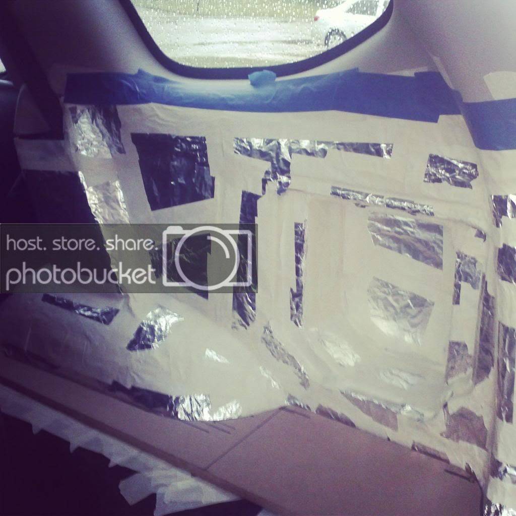

anyways i wasnt going to let that stop me on making some headway on this project so i brought the foil out and did my thing

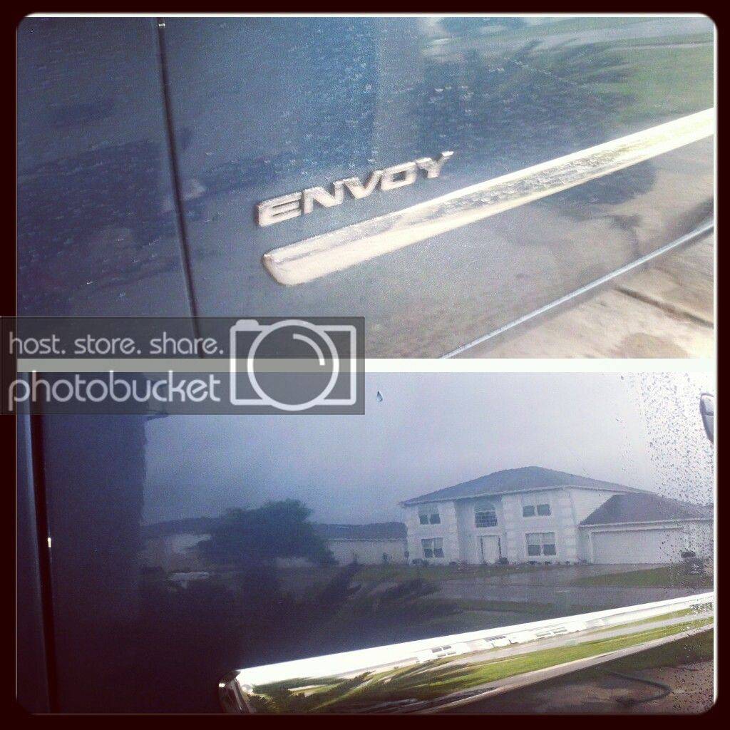

also i started shaving my emblems on the truck.... had to do some wetsanding and buffing to get rid of the shadow. anyways here is a before and after of the drivers side(still gotta do the rear gate and passenger's side....need fishing line)

Foil is always the way to go...much faster and easier to work with for sure. Just be sure to tape any/all seems.
