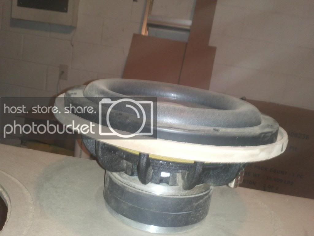

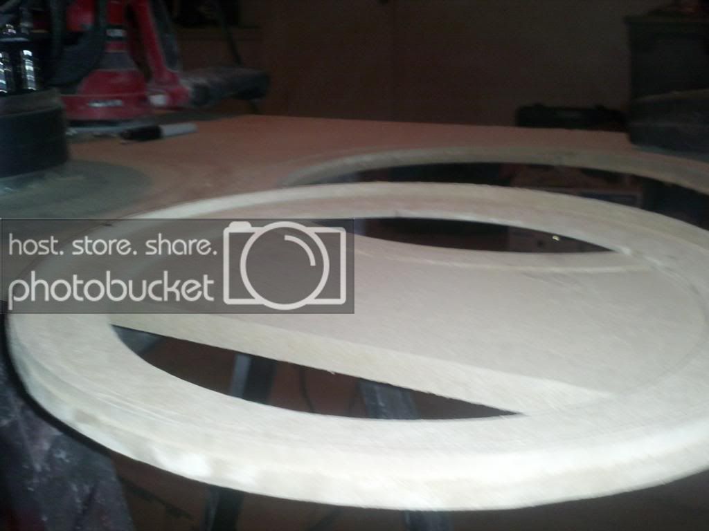

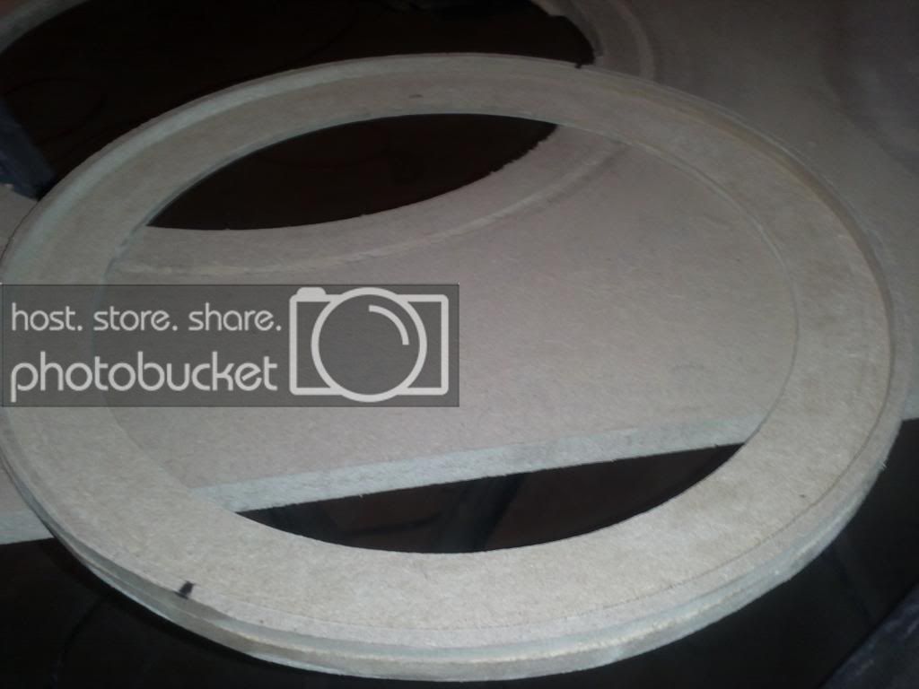

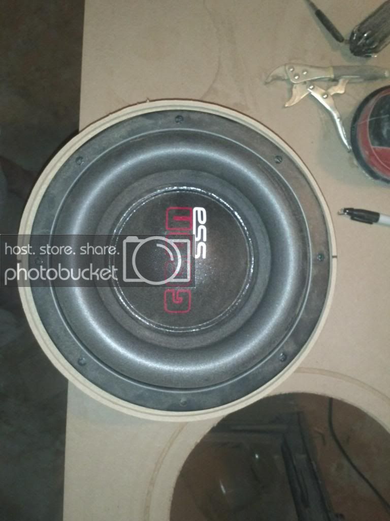

ok so i attempted a speaker ring..... keep in mind i didnt have a jasper circle jig(definitely going to buy) but did make a make-shift one to do this one. i made the ring out of 1/2" mdf reason its not sitting "flush"
anyways enjoy the pics
sorry for the dusty pics but man does the router make alot of saw dust lol. it has a port for a shop vac but dont have one of those yet.
also im thinking about making another ring to help with the mounting surface of the sub...give it alittle thickness for the screws to hold onto something...

Yeah definitely make another ring below that one, thats a REALLY small amount of wood to keep the woofer in place. As for bagging a Voy, look at Ridetech (Air ride technologies). They make some killer stuff and reliable. I got a Full FBSS air ride setup with 4 Viair 480's, 8.5 gal tank, 1/2" airlines and 8 1/2" valves. RE6 bags on the rear, air ride technologies Shockwaves single adjustables up front. Dakota Digital 4+1 guage for 4 corners and tank pressure, cant go wrong with that setup.

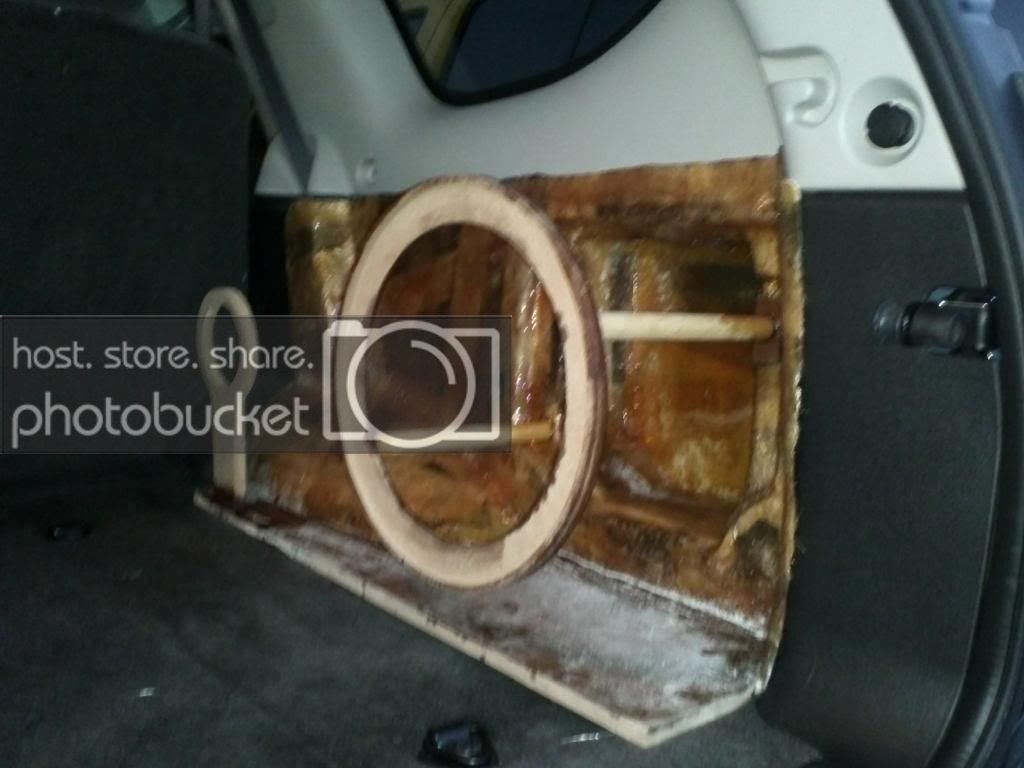

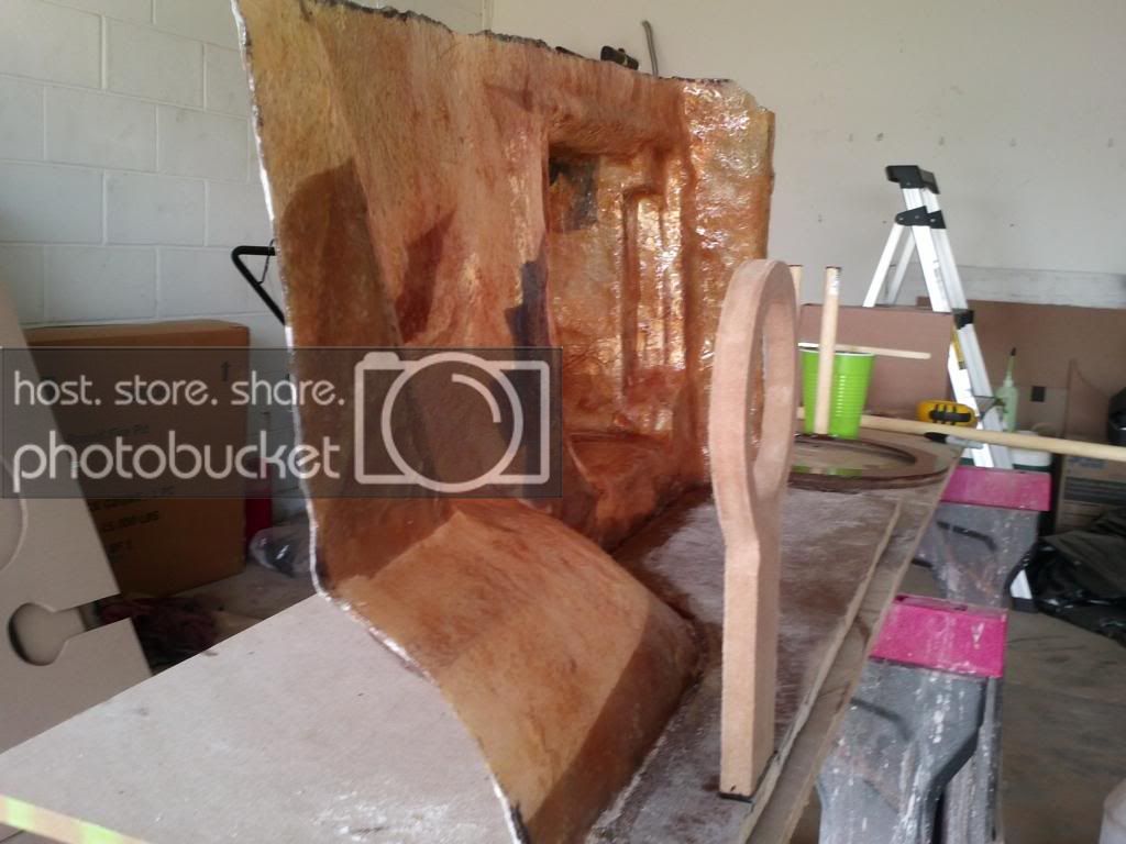

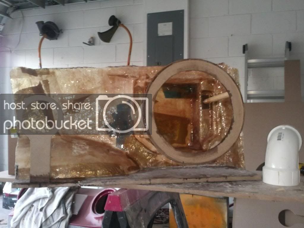

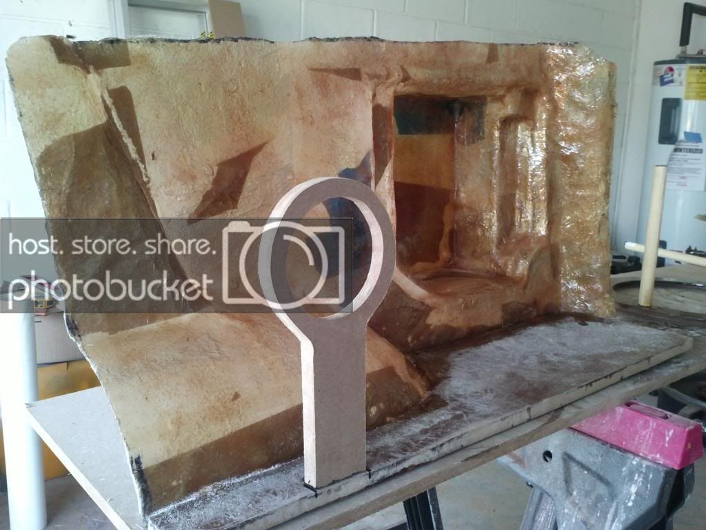

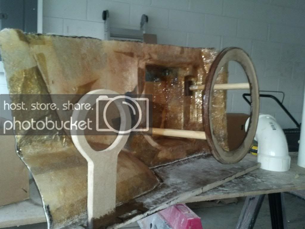

ok well snapped a few photos... like i didnt get where i wanted to this weekend due to "the players" but oh well i got it to the point its ready to be wrapped. also i got my port dilemma figured out....almost thought i wasnt going to beable to run a port but oxsign helped me figure it out. anyways here are the pics.... enjoy

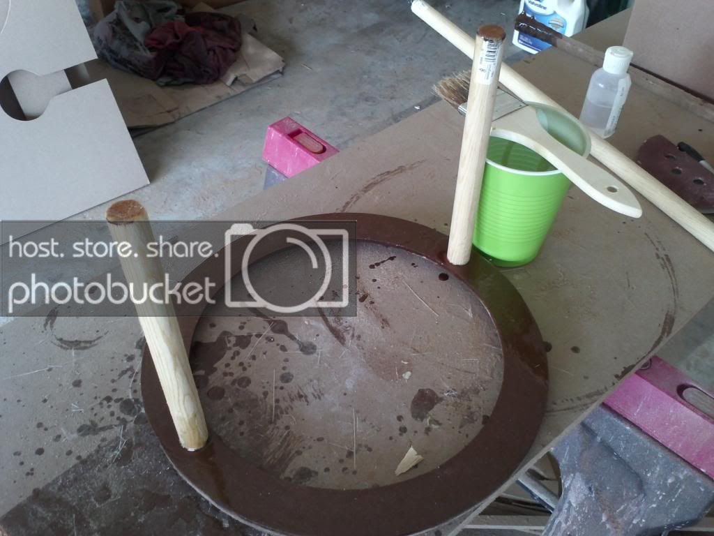

glassed the dowels to the ring.
figuring placement of the port mount...ended up moving it more left
mounted both.....

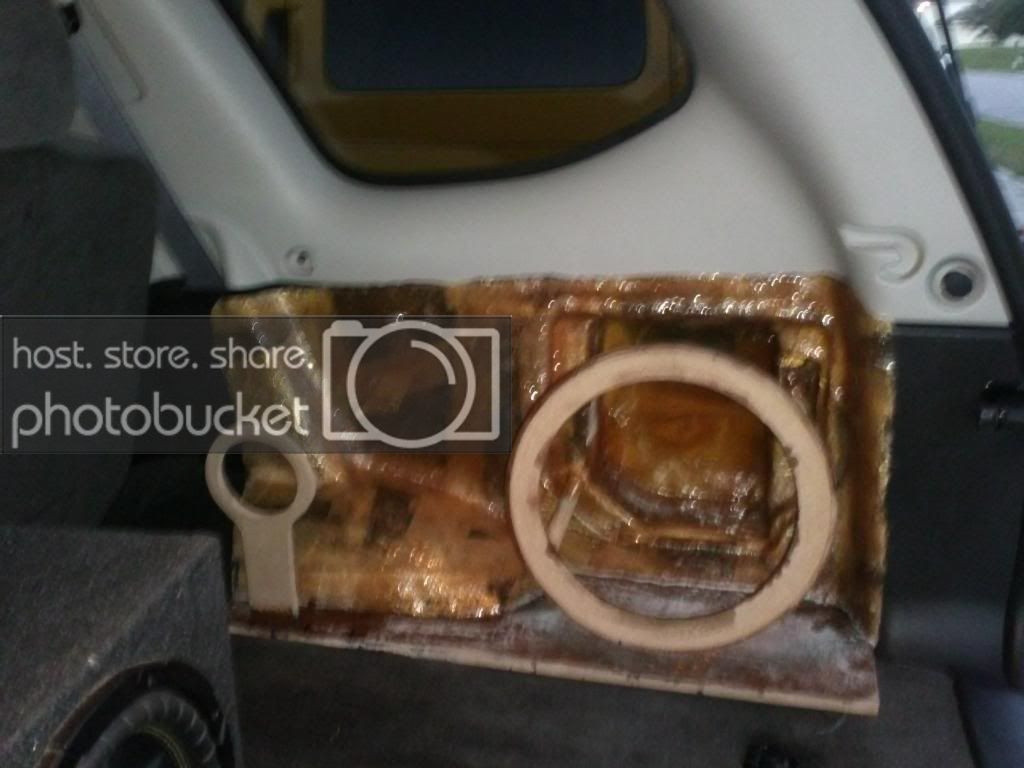

test fit in the truck...
im going to round the edges of the base so they arent at a point.
