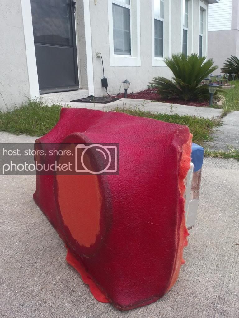

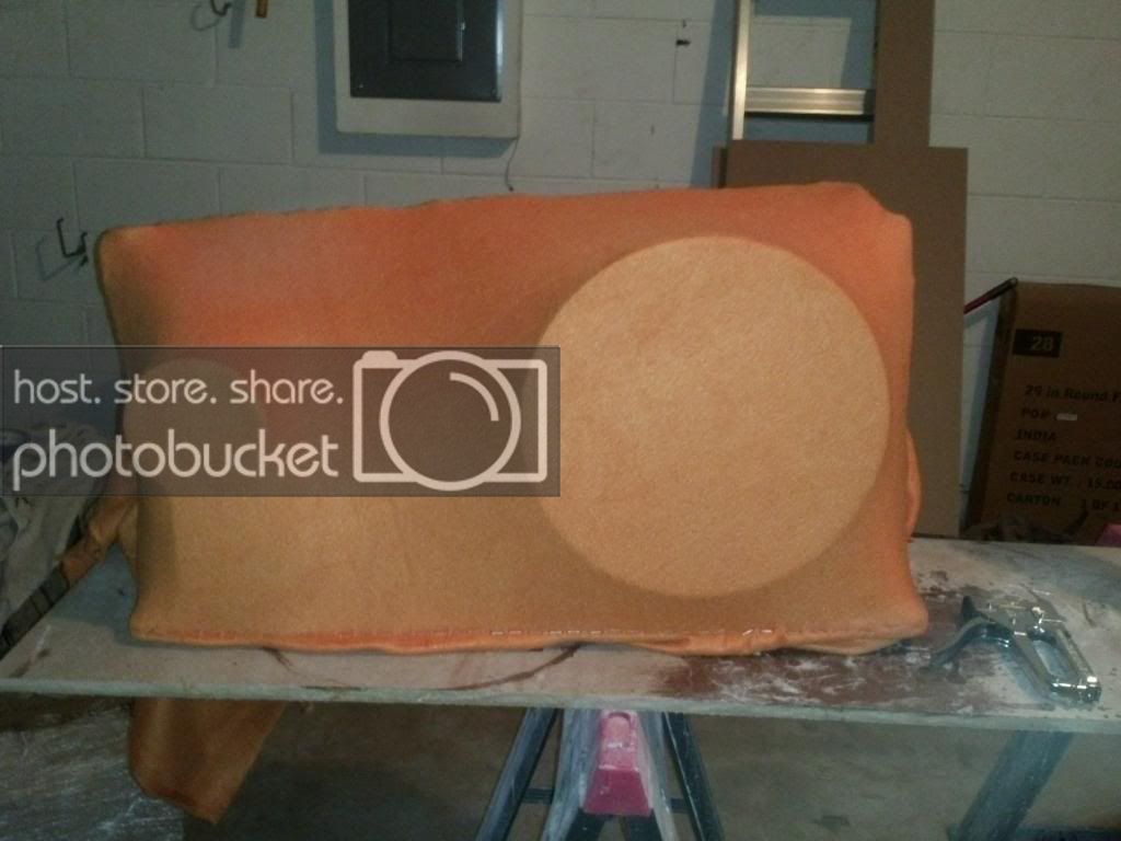

finally got some resin down.... one heavy coat to soak in and then i just did a lite coat. not its time to build it up.
after it dried and second lite coat was brushed on...

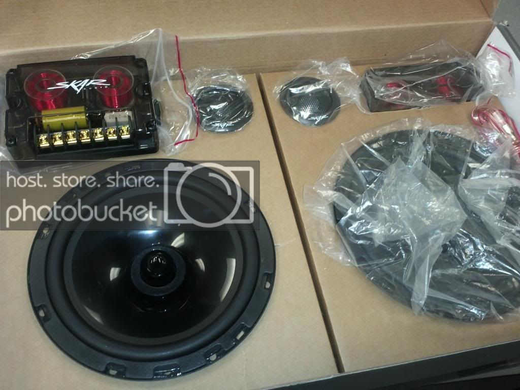

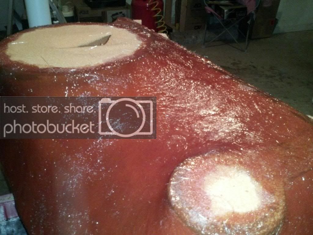

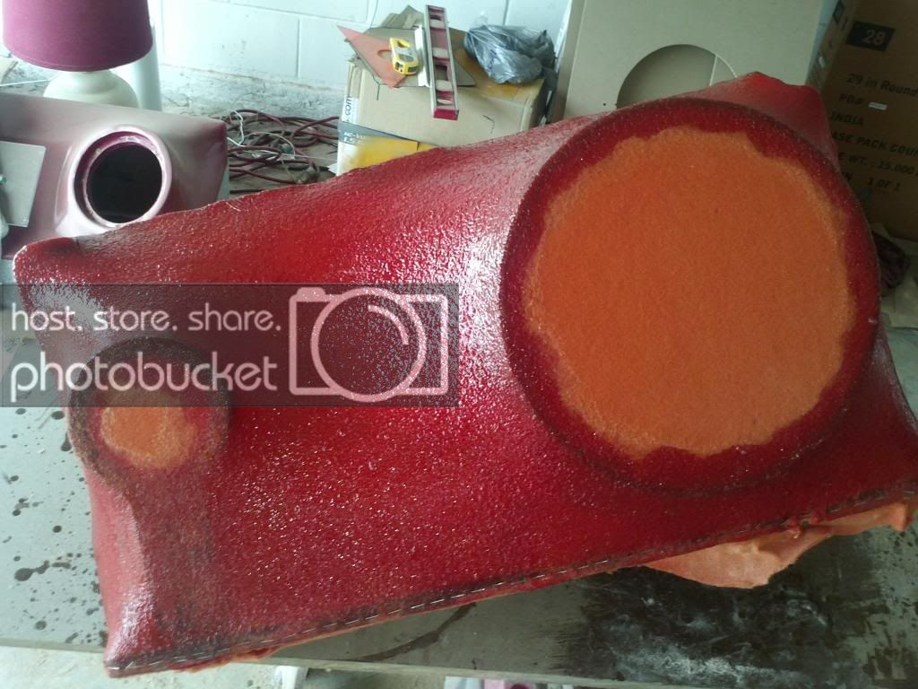

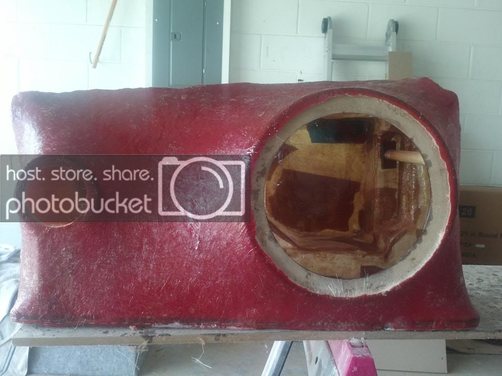

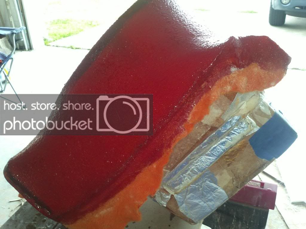

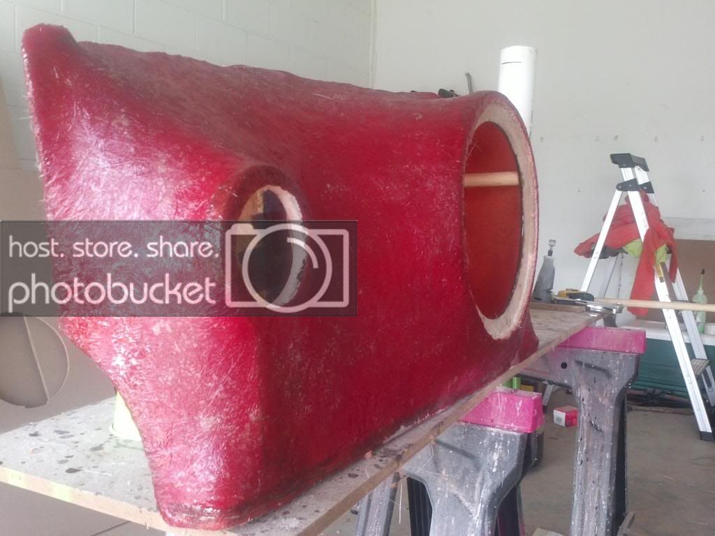

well the other day i put in "alittle" work and was able to trim up the excess fabric away from the box, sand it alittle, trim out the port hole and speaker ring and then i added another layer of mat and resin making it 3 total.... have about 1-2 to go on the outside then its onto the inside corners where i will do about 1-2 layers. also got my sound deadner, body filler, and paint gun in the mail as well as my skar audio comps. anyways here are some updated pics

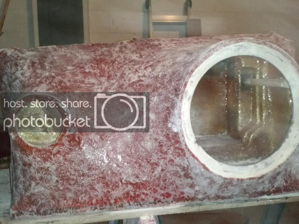

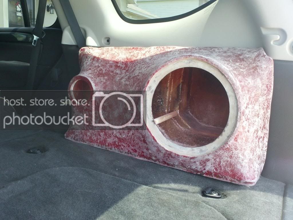

ok so i started to sand this bad boy and did a test fit as well.... my only issue with the test fit was port issue. the big *** elbow i have doesnt go in place now. it did before i wrapped it so im thinking it might have shifted alittle during wrapping but not by much. so now i gotta see if i cant find a different less bulky elbow or i may have to step down to a 2" port //content.invisioncic.com/y282845/emoticons/frown.gif.a3531fa0534503350665a1e957861287.gif other than that everything is going good with fitment.
