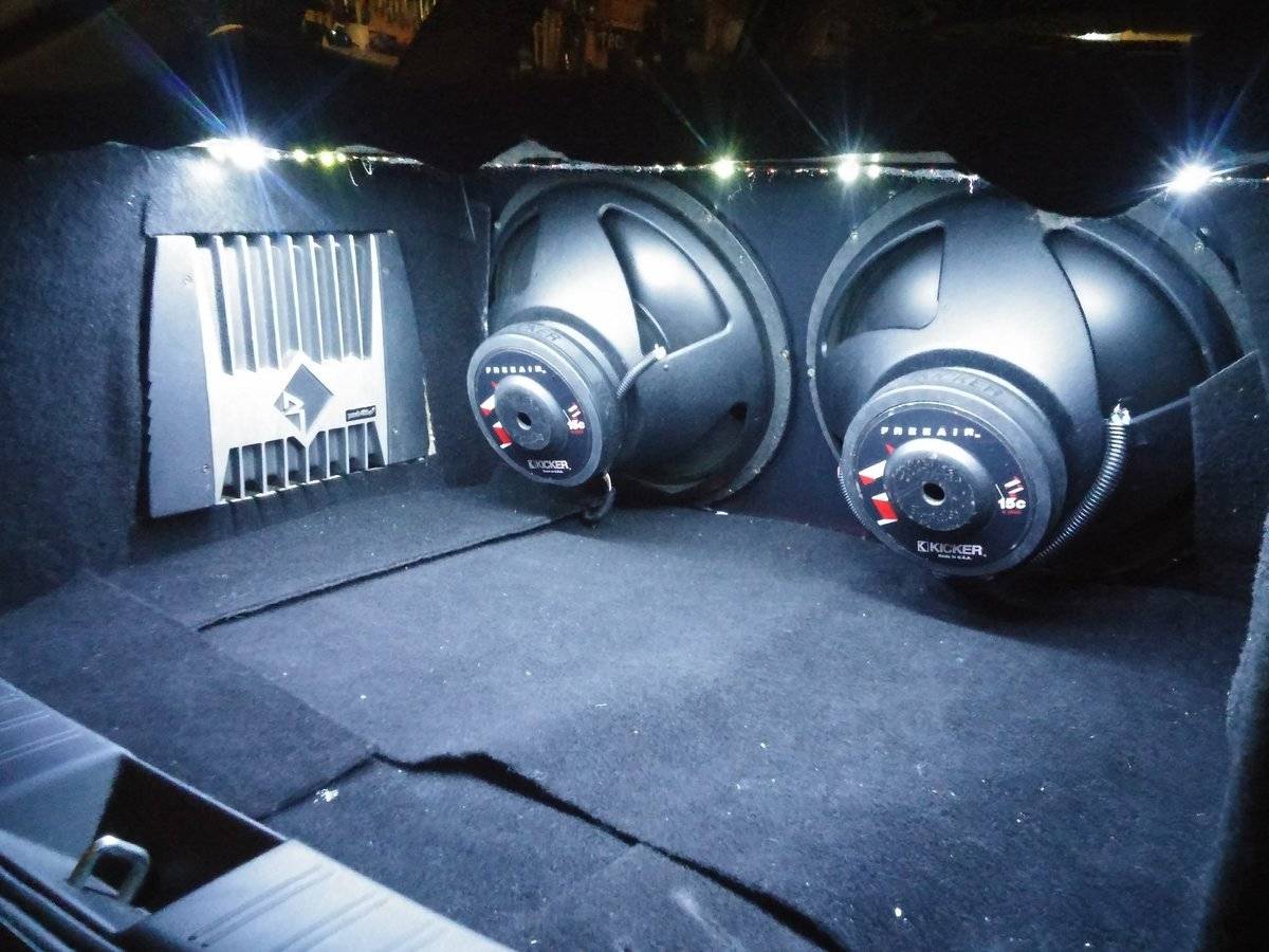

Mate, if your hobbies, require trunk space then seriously consider infinite baffle.  Its very efficient as long as you have a subwoofer with low FS and high QTS, basically most subwoofer would suit this category.
+1 for the infinite baffle, only if it's done properly.

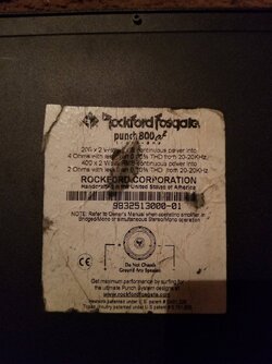

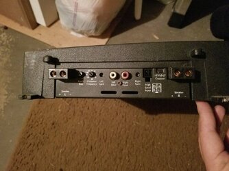

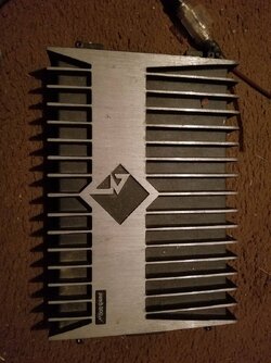

This is the kicker impulse sub I have and Rockford fosgate 800a2 amp. I've used the amp on my first car with 2 12s but they were stolen while I had them in my room at my college house. The kicker is a 10", for some reason I thought jt was a 12". Is the 10" gonna be too small? Should I buy a 12" instead or could I buy a 2nd 10" and run the 2 10s together? Which option would be best if the 10" kicker isnt enough alone?

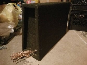

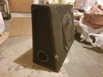

By the way is that box considered an infinity baffle? Since the face is not enclosed? Or does the rear have to be open more? I read you need wood extending out from the plane of the sub face but when you mount it in a sedan trunk it creates an enclosed space behind the sub anyways. The last box I had with 2 12s the faces were enclosed as well as the rear.

It's just a ported truck box.  Infinite baffle (IB) has no box.  IB is typically done in the rear deck of a car or walling off the trunk using the entire trunk as the box effectively resulting in an "infinitely" large sealed enclosure.

FWIW - i don't think anyone has commented on that amp -- It's a classic.  Way under-rated and built like a tank.  It's like a 69 Camaro -- Old school American muscle.  It's not very efficient by today's standards, but at ~400w it's not a problem.
Box: https://www.ebay.com/itm/Rockville-RSV10B-Single-10-1-0-cu-ft-Bedlined-Vented-Subwoofer-Enclosure-Box/352415423331?hash=item520d989b63:g:j4MAAOSwhilbWu1X
I put it in winisd pro -- the plot looks really good.

I thought the plan was run the 4 ch active (2 ch on mids, 2 ch on tweets) and use the RF bridged to run the sub.  I may have missed something -- I just skimmed through all that yesterday.

It was clear Jeff was recommending using the Pioneer 4 ch to run the mids and tweeters -- commonly referred to as "active" -- in that the power and frequency control for the woofers/tweeters is being done by an active component (the DSP) vs the more traditional/basic (and slightly less desirable in terms of SQ) practice of using a passive 2-way crossover after the amp which filters hi's for the woofer and lows for the tweeter.
He never mentioned a 2nd amp, but did account for running sub signal through the DSP (channels 7-8), implying a 2nd amp and sub would be used.
