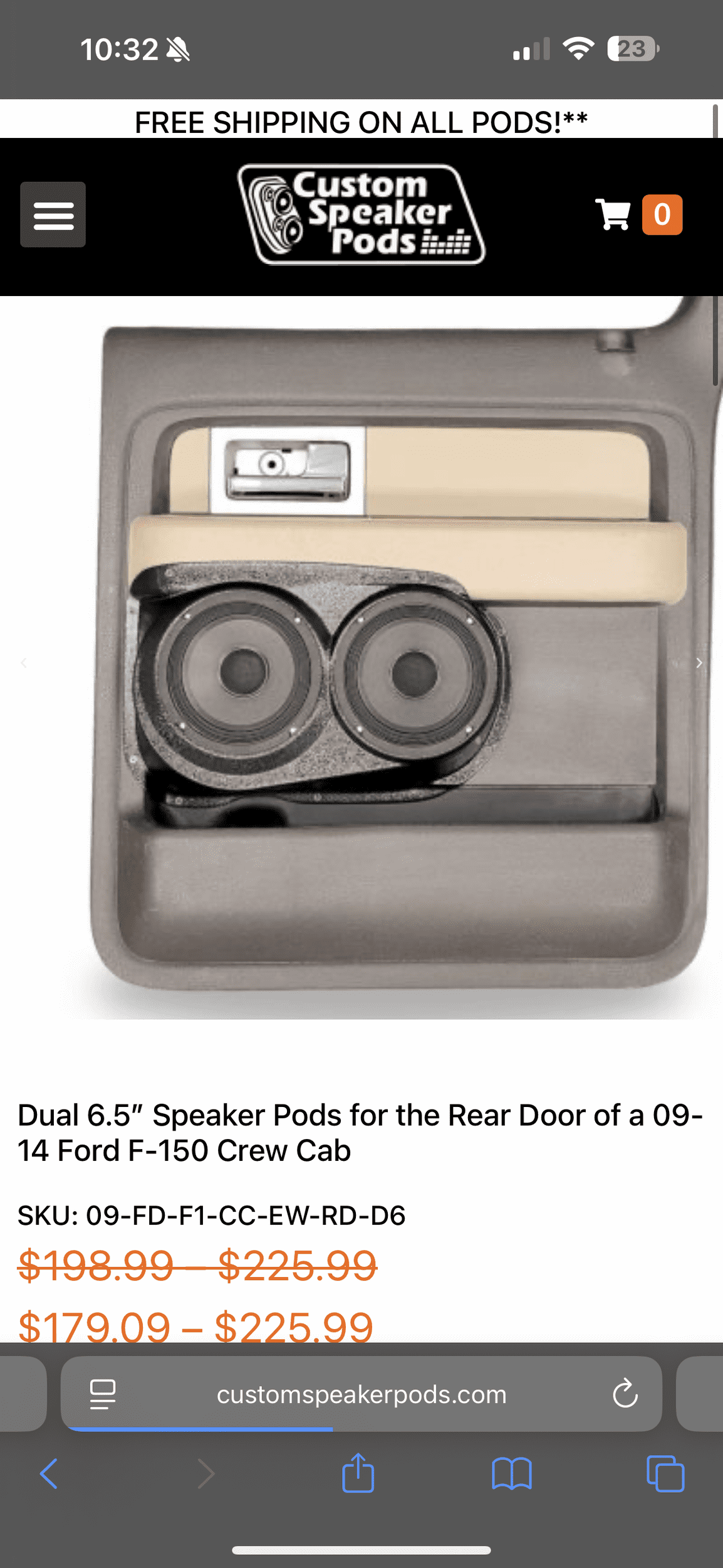

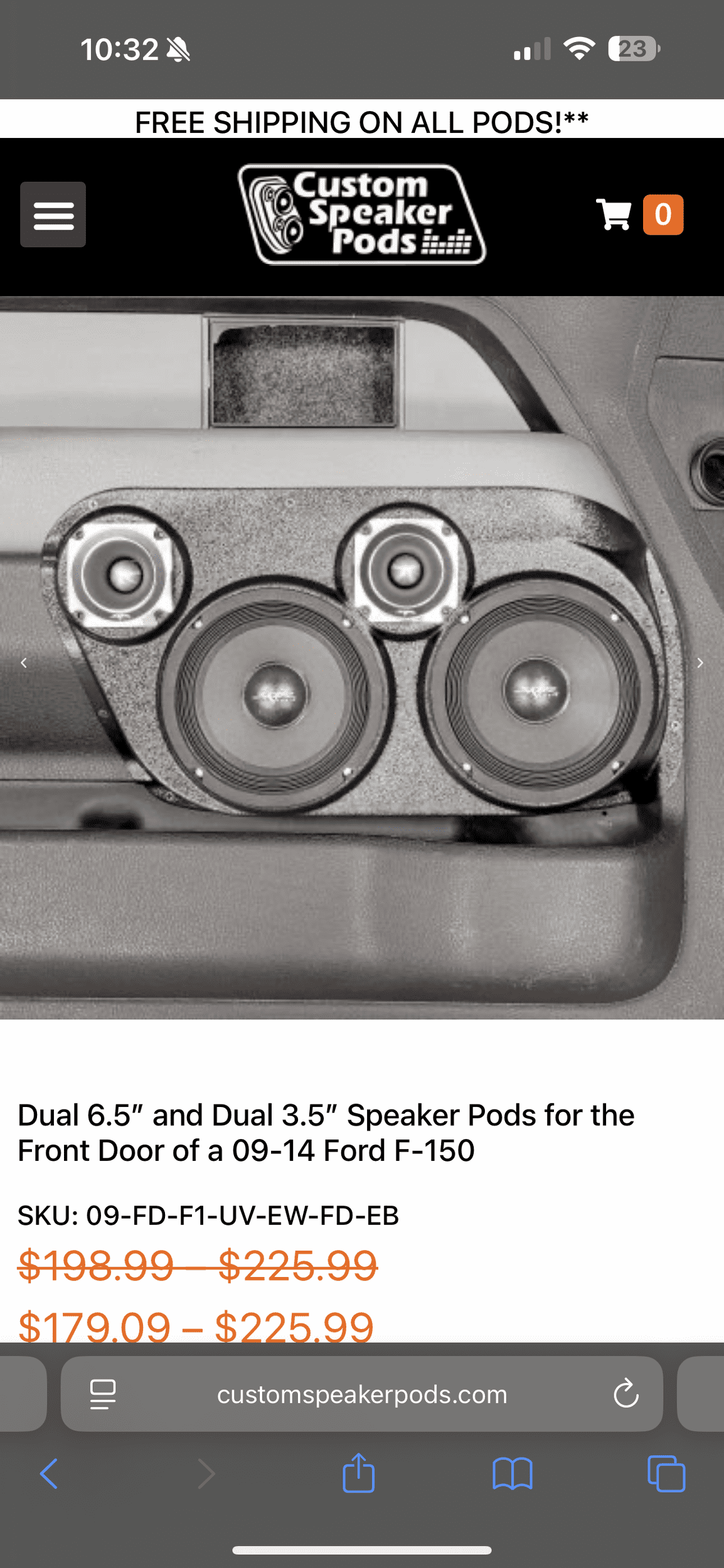

I’m trying to set up a new system in the 2010 f150 I just got. I’m familiar with subs I’m gonna put 4 8” subs in a custom ported box and I have the amp and all ready to go. I want to buy speaker pods and drive the speakers off of another 4 channel amp. I’m attaching the photo of the pods. I’m looking at help deciding what speakers to run and help powering them properly while trying to be as cost efficient as possible. I’m not trying to do car comp I’m just doing this as a hobby and for trips just having quality sound. I was thinking maybe 4 mid-range 6.5” loudspeakers, 4 mid range bass 6.5 speakers. Then for the 4 3.5” speakers in the front, run a coaxial full range set and power these from head unit.
I was looking at DS18 6.5” mid loudspeakers which run at 200w 4 OHM
Also looking at DS-18 pro 6.5” mid-bass at 250w 4 OHM
My idea was to pair these with 4 channel DS18 amp which runs 320w @2 ohm per channel. I would be able to run 1 mid bass & loudspeaker per pod. Tie them in to make them 2 OHM. Speaker RMS would be 450w total for both speakers and amp could output 320W. This is under powering but would this work? I always match my subs up properly with my output of amp, so for speakers I was trying to get as close as possible. Also don’t know much about mid-bass vs mid loud + coax and etc looking for advice

It sounds like you're putting together a solid audio system for your 2010 F150! Here are some thoughts on your setup:
### Speaker Selection
1. **Mid-Range Speakers**: The DS18 6.5” mid loudspeakers (200W RMS) and DS18 pro 6.5” mid-bass speakers (250W RMS) are good choices. Pairing one of each in each pod could give you a balanced sound, with the mid-bass providing more punch and the mid loudspeaker offering clarity.
2. **Powering**: Using a 4-channel DS18 amp rated at 320W @ 2 ohms per channel is a reasonable plan. Wiring the mid loudspeaker and mid-bass speaker in parallel to achieve a 2-ohm load per channel should work. While the amp may be slightly underpowered for the combined 450W RMS of both speakers, it's generally better to underpower than overpower, as long as you’re cautious with volume levels.
3. **Coaxial Speakers**: For the 3.5” speakers in the front, a coaxial full-range set is a solid choice. They’ll provide good sound quality for higher frequencies and can be powered by your head unit, which usually has enough power for smaller speakers.
### Considerations
- **Impedance Matching**: Make sure the amp can handle the total impedance load you are planning to run. Mixing different impedances can sometimes lead to an uneven power distribution.
- **Volume Levels**: Since you’ll be underpowering the speakers a bit, keep an eye on the volume levels to avoid distortion. You can gradually increase the volume to find a safe operating range.
- **Sound Quality**: Experiment with speaker placement and settings on your head unit to ensure you’re getting the best sound quality.
### Final Tips
- **Installation**: Make sure that your installation is secure and that there's no rattling from the pods or other components.
- **Sound Deadening**: Consider adding sound deadening material in the doors and around the pods to enhance sound quality and reduce road noise.
Overall, it sounds like you’re on the right track! Enjoy your audio project!

If you want to dig down a bit lower than the DS18 midRANGE (not a midbass driver) pro style drivers, AND still have high efficiency with sound quality too, look at Steven's audio MB6s, MB8s. whichever will fit.
You can actually have good-sounding LAF, it's possible, but mount your tweeters up on the door or in a dash or pillar, on either withot without a pod, tweeters **** when mounted low like that in the doors.
Here are the PODs:
If your "A" pillars already have the tweeter setup, use them, or-
Get a pair (1 on each door) of the 2-ohm version of these 8" 450-watt RMS drivers; they will walk all over a set of the DS18's, and they are on sale for $98.00 each.
To those, mount a set of these up in the door, or in the "A" pillars, they are a 150 watt RMS silk dome with a low fs of 640hz, chambered back high power handling tweeter that actually sounds good while getting very loud too.

The only issue I’m looking on the down4sound website and a few others. The only variation of 09-14 f150 pods I’m seeing is dual 6.5” with dual 3.5” for front pods, or dual 8” and dual tweeter front pods, they also have just a dual 6.5”. For the rear I see dual 6.5” or single 8”. That’s the only reason I was looking at getting so many speakers that are a little bit cheaper on ds18 due to the quantity I’d be having to get.

what do you think about getting the single 8” rear pod and putting the Steven’s audio you suggested in the rear. Using a 4 channel amp that outputs 320w RMS @ 2 OHM. Wire those 2 on a seperate channel alone. Then take the 6.5” dual up front and do some cheap ds18 loud speakers and get 2 4 ohm per side and tie them together into the other 2 channels. Run the 3.5” coax I was thinking off of the head unit then maybe add Apillar tweeters in.
I’m not sur on car audio that’s why I came here yall probably forgot more than I’ll ever know 😂. I see these mid-bass on ds18. It says they have
Me thinks you have got it backwards! Lol,
Concentrate on the front stage, use the rear as fill.
That said, I believe that you have 5x7/6x8 openings front and rear, pillar-mounted tweeters. Before you jump in and use pods, have you considered just modifying the door panel to accommodate a 6x9"?
Midbass is hands-down the most difficult thing to tackle in the auto environment, and 6x9s have roughly the same cone area as an 8" (slightly more usually), and cone area is king for all things bass or midbass; it's just physics.
The DS18 lineup, except for just a few, are not midbass, and the midbass they do sell is around $200 a pair, not exactly inexpensive.
What specific models were you looking at?
