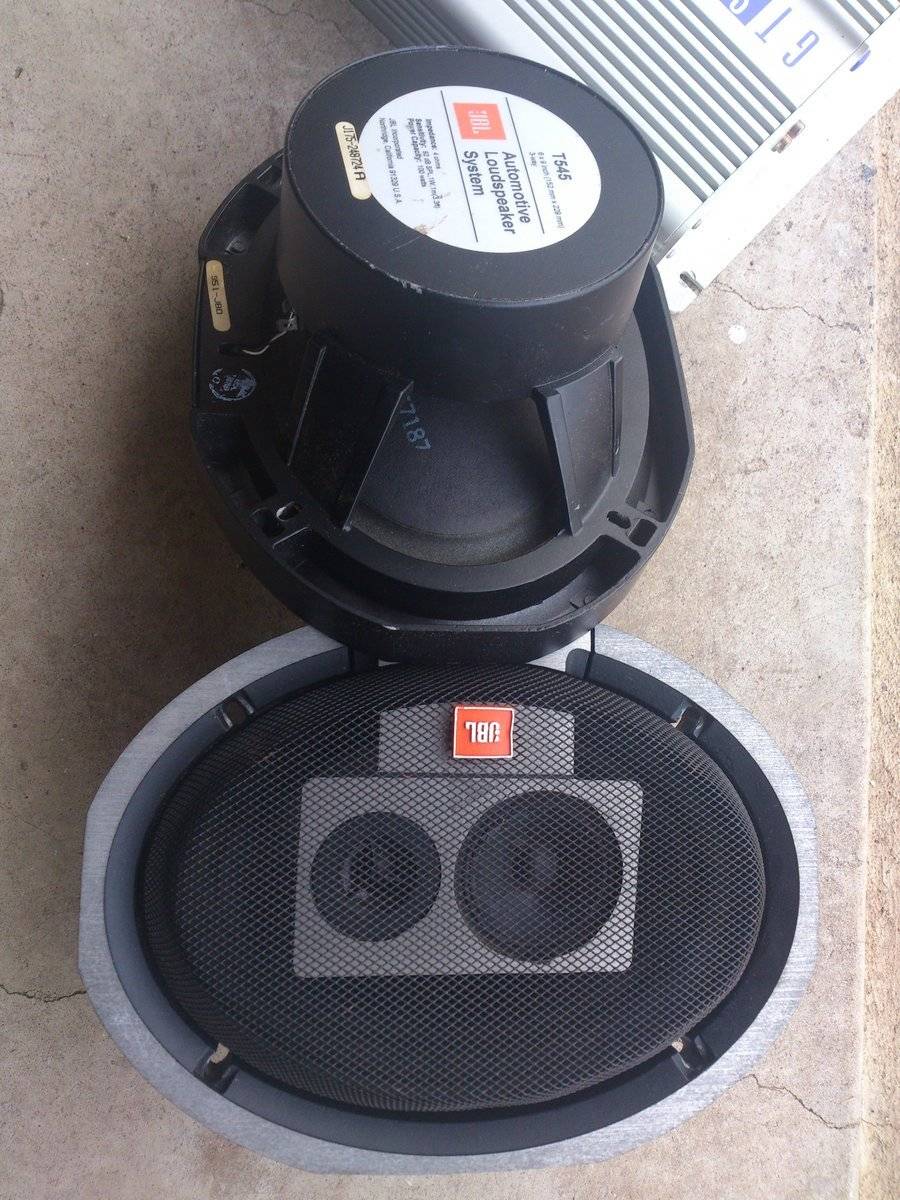

Im not sure if this helps or is the correct way but I have 6.5 mids in the front doors and tweets in the pillars I used 2way 6x9s in the rear...
