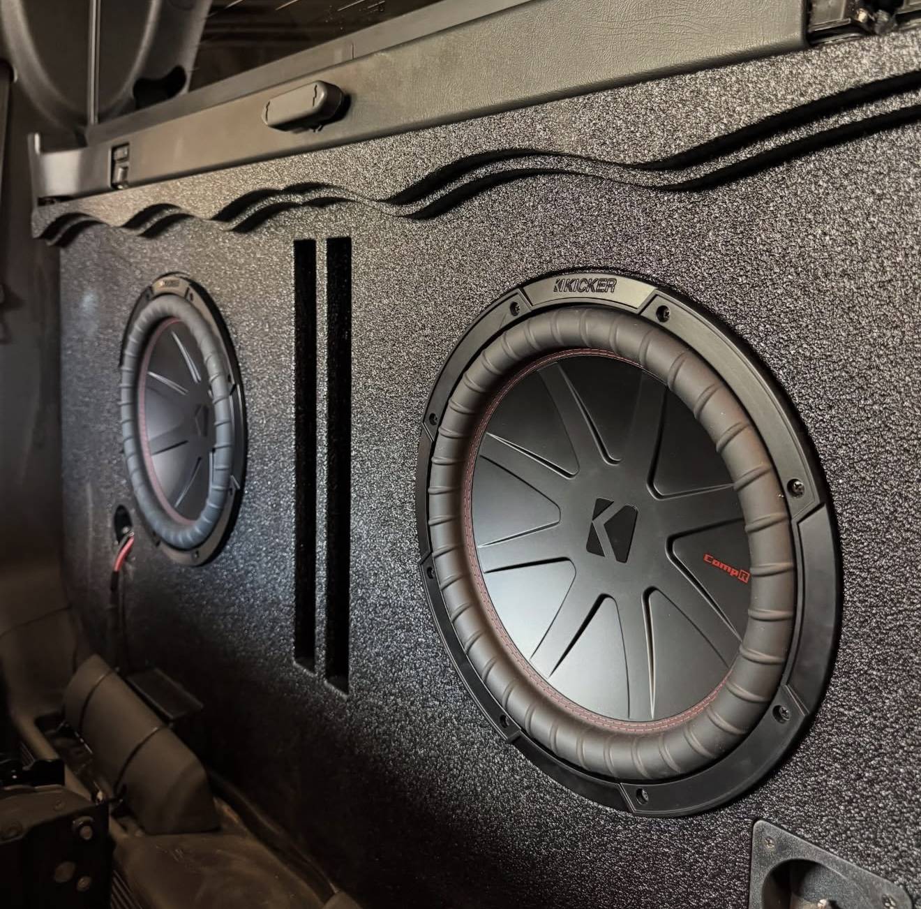

Hey guys,
I recently had a system put in my 09 avalanche. Here’s a quick breakdown of what I’m running.
2 12” Kicker CompR’s, 4.4 cuft ported box, DB drive WDX 1000 watt amp, (Subs are wired to 1ohm) 6.5” DB drive mids and 1” tweeters ran off the the stock bose amp. And a new kenwood head unit.
It all sounds pretty good but you really need to crank the volume on the head unit to get the bass going (28+ out of 40) and by then the mids/highs are screaming in your ears. At half volume with the bass knob at max the subs are hardly even working. It also just seems like the subs want to skip over low notes compared to any of my previous set ups. I purposely went with a ported box this time around to get more air moving, plus everyone says if you want a louder set up to go that route. The excursion of these subs looks nothing like the YouTube videos out there and I can’t see these being underpowered.

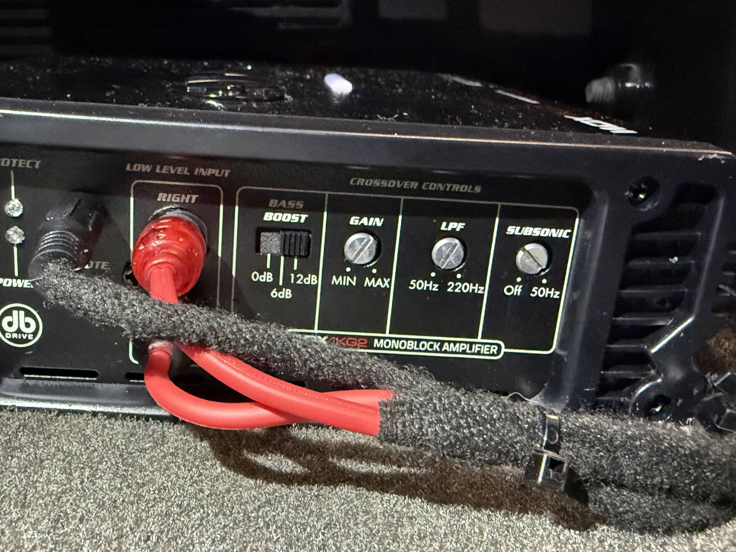

The shop had the amp gain set at 60% of the dial and the bass boost at +12db (I have an external bass remote). They also had the LPF set at the 50hz minimum which I later found out was way off. I moved it to 80hz. Subsonic is at 18-20hz for reference.
I figured this set up would absolutely pound. My previous 4 8’s walk all over it, especially on the lower notes which I can’t understand.
Thanks for any help and I apologize for the long post!

Thanks for the quick reply. I thought the bass boost and gain was a touch high but wouldn’t turning the bass boost to 0 and dialing the gain back a touch hurt the bass even more? Also isn’t the external bass remote tied to the bass boost? I made sure the head unit was all at 0 gain across the board. The issue is I don’t want the mids/highs screaming in my ears just to get bass. I could get the wipers to move on my last set up at half volume.
They used 4 gauge wiring for the subs. I had 0 for the 4 8’s I use to have.
As for the box, there isn’t many options for these trucks unless you have a custom one made. I got quotes from 4 different shops and they all wanted $2000 minimum. I figured this box was perfect for the CompR as it looks like it’s happy in a pretty wide box configuration (1.75-2.25cuft per sub). I can’t find what the box is tuned to but I’d imagine it’s in the 30-35hz range.

They’re 4 ohm subs wired down to 1ohm. They don’t have the tuning frequency listed on Q powers website for the box. And it’s the Kenwood Excelon DMX709S head unit.
I listen to mostly hip/hop, rap and some dance music. I tried the classic bass song Put on by Young Jeezy and it doesn’t play the lows at all. I don’t see any weird amp settings unless there’s some setting in the head unit. But I agree, 2 12’s, ported box and 1000 watts @ 1ohm should really bang. Especially without having the bass boost at 12db and the gain a little past the halfway mark.
The amp picture is before I adjusted the LPF to 80hz btw.

Try these things:
1. Disconnect the speaker wires form the amp. Assuming it's just two. Hold one wire to the the negative end of an AA battery. Very quickly tap the other wire to the positive end. Make sure both subs move in or out together when you do so. You'll hear a slight "thump" with each tap.
2. Set your amp gain to 100%, crossover to ~80Hx, bass boost to off, infrasonic ("subsonic") filter to off.
3. Go into your Kenwood settings, and check that all EQ is flat, crossover for sub output (if one exists) is set to as high as it will go, and sub output (if adjustable) is at around 90%
Play a track that has good bass, but not just a one-note drone, or a higher-pitched "false bass" (like 60Hz that makes smaller systems sound good). I'm not into rap/hip-hop/dance, but if you Google "best rap (hip-hip, dance, etc) song to evaluate subwoofer", you'll get some good suggestions.
Start with volume low, and increase slowly just until you start getting some solid bass fill. Then, dial it back down.
Let us know what happens, and we can go from there. Also, give us an idea of what your head unit software is capable of, regarding sub management.

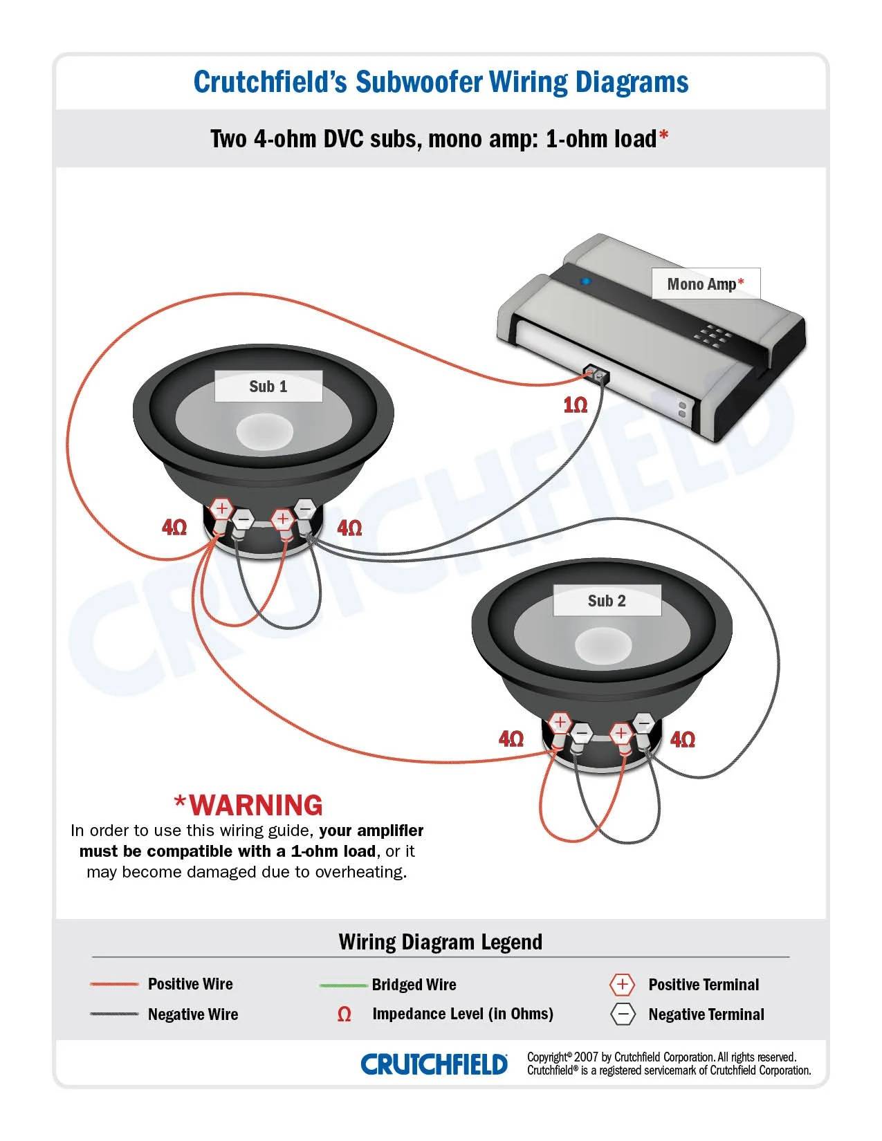

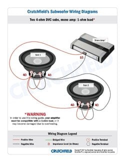

It doesn't hurt to pull the subs and verify they are wired to 2ohm per sub - 1ohm at the amp. Have a multimeter? Measure the ohm load at the box's terminals.
Turn the sub amps crossover ALL the way up and the Subsonic OFF!!! Use the crossover in the Kenwood for the subwoofer output. 80hz is fine for a starting point. This IS an eXcelon you can usually max the head unit volume all the way without distortion through the RCA outputs. There is a 13 band EQ in most Kenwood head units as well as several sound shaping features. There IS a subwoofer level control in the Kenwood head unit. At volume 28 the RCA's are putting out way less than 2v If I recall. This would certainly explain low sub output.
Make sure the sub amp is connected to the sub out on the head unit.
Make sure (VERIFY) 1ohm at the amp (2ohms per sub) (4-4=2 + 4-4=2 --> =1ohm)
If the subs are set up correctly they should be pounding hard at near full volume on the head unit. At this point neither the BOSE amp or the Kenwood internal amp will be able to keep up and WILL BE OUTPUTTING DISTORTION to the door speakers, which is the #1 killer of speakers. (Clipping/Distortion)

Not 100% sure, they just wanted me to buy the 4ohm version of the subwoofer so they could wire them to 1ohm. If they're out of phase, wouldn't it be obvious by watching them move?
Not necessarily. They could be wired out of phase with themselves. Or maybe just one is, but the other is not.
