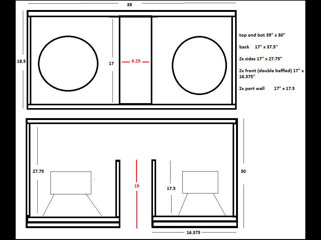

I'd go with a 34 hz tune with those woofers if you are going with 4 cubic feet net each. It looks smoother on winisd. Along with lots and lots of bracing.
Take a look at the port area per cubic feet, usually want that within 12-16 range. You were at less than 10 before with the other design.

Thats the design and dimensions man. Its a center ported box with a straight shot port
wood cuts are:
top and bot 39" x 30"
back is 17" x 37.5"
sides are 17" x 27.75"
front face pieces(double layered baffling) are 17" x 16.375"
both port walls are 17" x 18.25

I always thought the baffle was the port? What is the baffle? Sorry for being a noob xD

Thanks, I feel like an idiot lol, Ill model the dimensions you posted and post back tomorrow
Looks sorta like this plain and simple front and top view(MS paint so what lol). Just remember to add plenty of bracing or you'll be tuned lower.
Also reviewed your other design again.. Dont you dare used 0.5 thickness for subs this beefy. 0.75 wood thickness man no lower than that.
Alright man, thats what i figured^ and thanks so much for making that, alot simpler now haha.

When i say excessive bracing, it'll look something like this. These subs will flex a box apart if its not built right.
