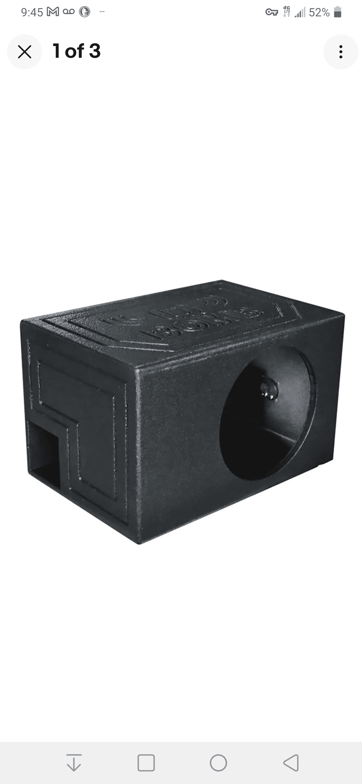

Featured Good day guys i need a little help, i have a 12" American bass 1200 rms 2400 watts max n a boss 12" 1600 watts max , wats the w×h×l of the box?
Hey gd day bro, 1 question, now u said 15 5/8" lenght of the pipe rite? But i see d pipe is really close to the back of the board, is that too close or not?
This thread is full of confusion, now op is quoting himself.
Manufacturer recommends a 2.5ft3 32hz tuned enclosure I believe, I linked where to find a design.
