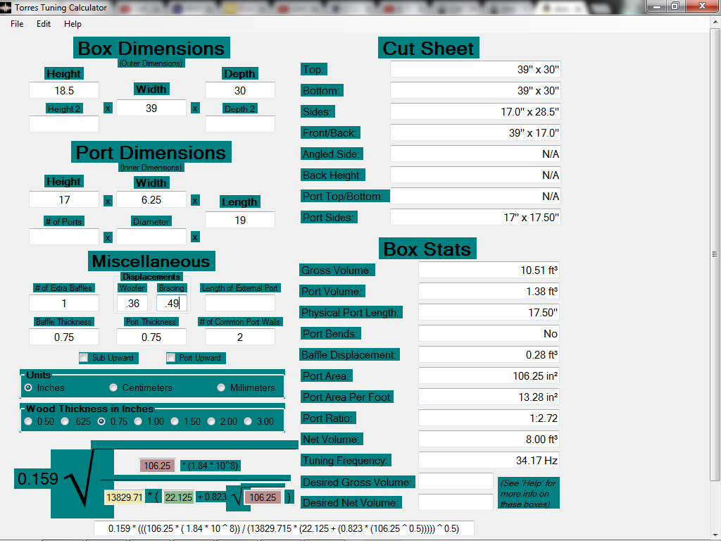

That is EXACTLY what i want to do, seal the entire trunk off and fire it back to the front. Ill give you the dimensions and see what you think and any design you might come up with, It can be up to 39 inches wide, 19 inches tall, and up to 32 inches in length. Ill also post a picture of what i came up with, it has 8 cubes of volume inside , and is tuned to between 35-36 hz.

I modeled that and took into account all of the thicknesses of the walls as well as the subs being mounted and it has 8 cubes of volume inside and around 10.8 cubes if you count the airspace in the port area
your center port is wrong. You dont make a T in the middle of the box like that. You can do a plain straight shot or a little kerf but not a T. Only when the port is long enough to reach the rear wall and needs to bend to keep the same width is when you need to make a T intersection. Your port area is too little. You'll want to add a 2nd baffle and a lot more bracing.
I'd suggest downloading torres box calculator and crunching proper numbers before putting in a box design.
I'd go with a 34 hz tune with those woofers if you are going with 4 cubic feet net each. It looks smoother on winisd. Along with lots and lots of bracing.
Take a look at the port area per cubic feet, usually want that within 12-16 range. You were at less than 10 before with the other design.
