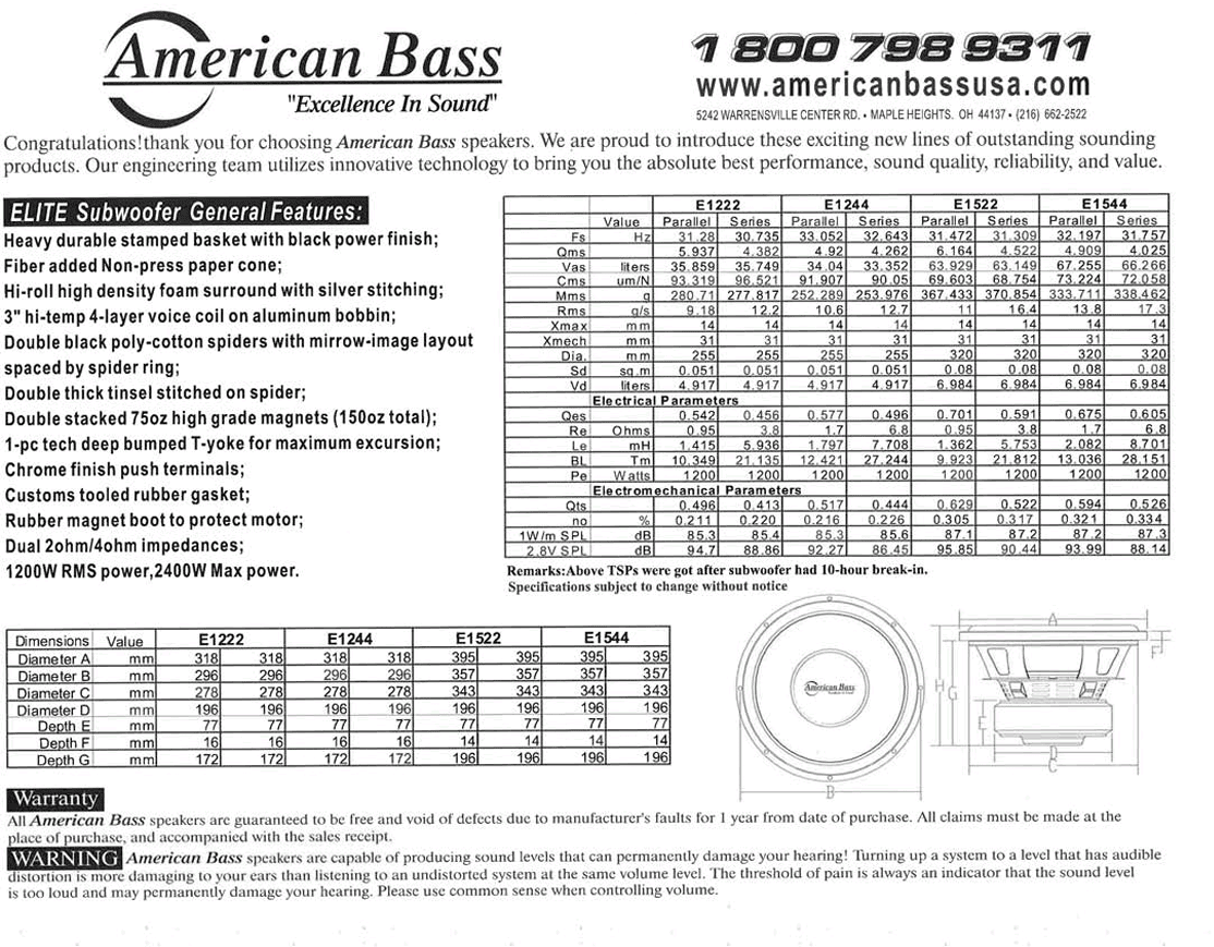

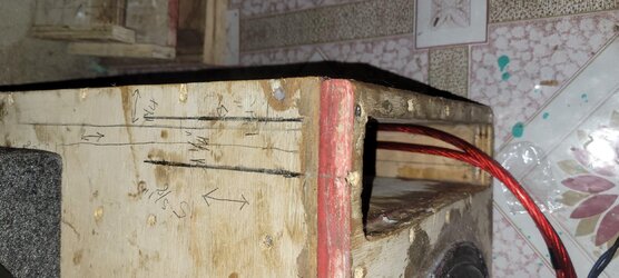

Featured Good day guys i need a little help, i have a 12" American bass 1200 rms 2400 watts max n a boss 12" 1600 watts max , wats the w×h×l of the box?
but why the box face is so big? What i usually do at times is like if its a 12" the height is gonna be 13 or 13 1/2 so so it won't look all that, but just asking a question
Reason is so the box would not be so deep or wide. You could reshape it as long as you get a total of 4,940.87 cubic inches inside the box. That volume has already taken into account the sub, port, and a little bracket for the port.
Can i see a picture of your box?

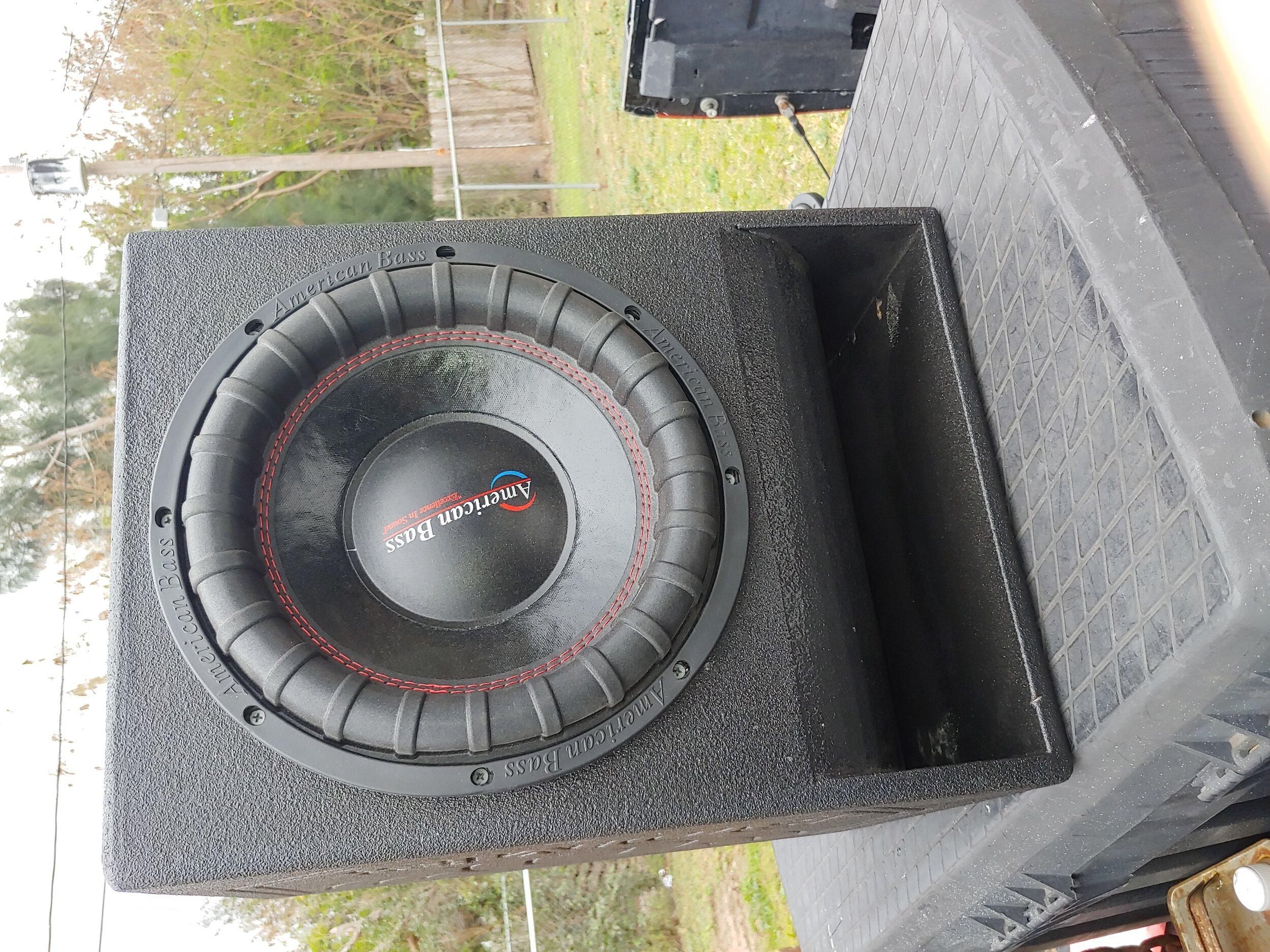

I did not build a box for it. I put it in a box I already had. It sounded fantastic..... until it finally broke in. Once broken in, it sounded like crap.
I did not build a box for it. I put it in a box I already had. It sounded fantastic..... until it finally broke in. Once broken in, it sounded like crap.View attachment 60205View attachment 60206
This what you have now or the one u just told me to build?

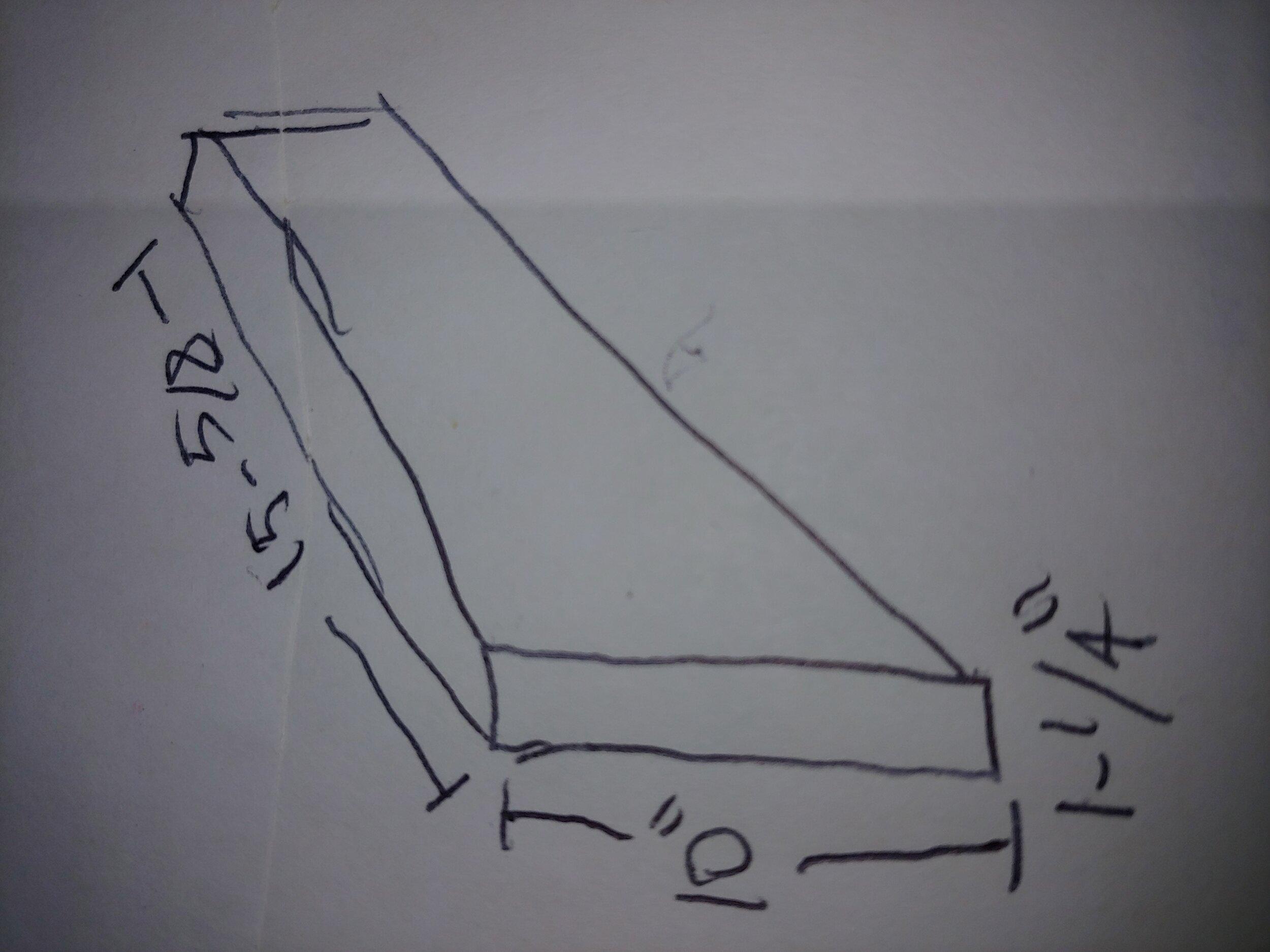

No. The slot port is 1 1/4 wide by 10 high. The length is 15 5/8. I have been advised to do the port on the side of the box.View attachment 60224
Lol wait i know your trying to help me out i do appreciate but hold up, if the 10" is the height, isn't the box 16" high? So how it gonna be 10" hight am confused there sorry, and do u hv whatsapp? Maybe we can talk there
