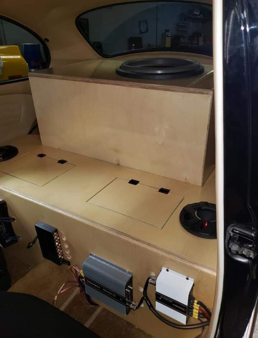

I had a single 15" AB HD15 on a Taramps MD3000 in a 65' VW Beetle and it was crazy. The box design was by @Shedder2. He blocked me a long time ago. 🤣 He's a good box designer. I built the box and the rest of the woodwork.
