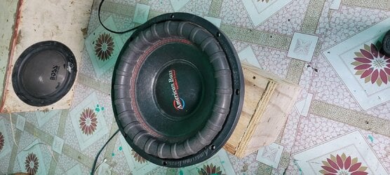

Featured Good day guys i need a little help, i have a 12" American bass 1200 rms 2400 watts max n a boss 12" 1600 watts max , wats the w×h×l of the box?
Haffar Isaacs
CarAudio.com Recruit
Need help building a box for 2 12" subs, both sub i wanna put in d same box,. 1 American bass 1200 rms n a boss 1600 watts , can u give me the measurements of gow i should do this

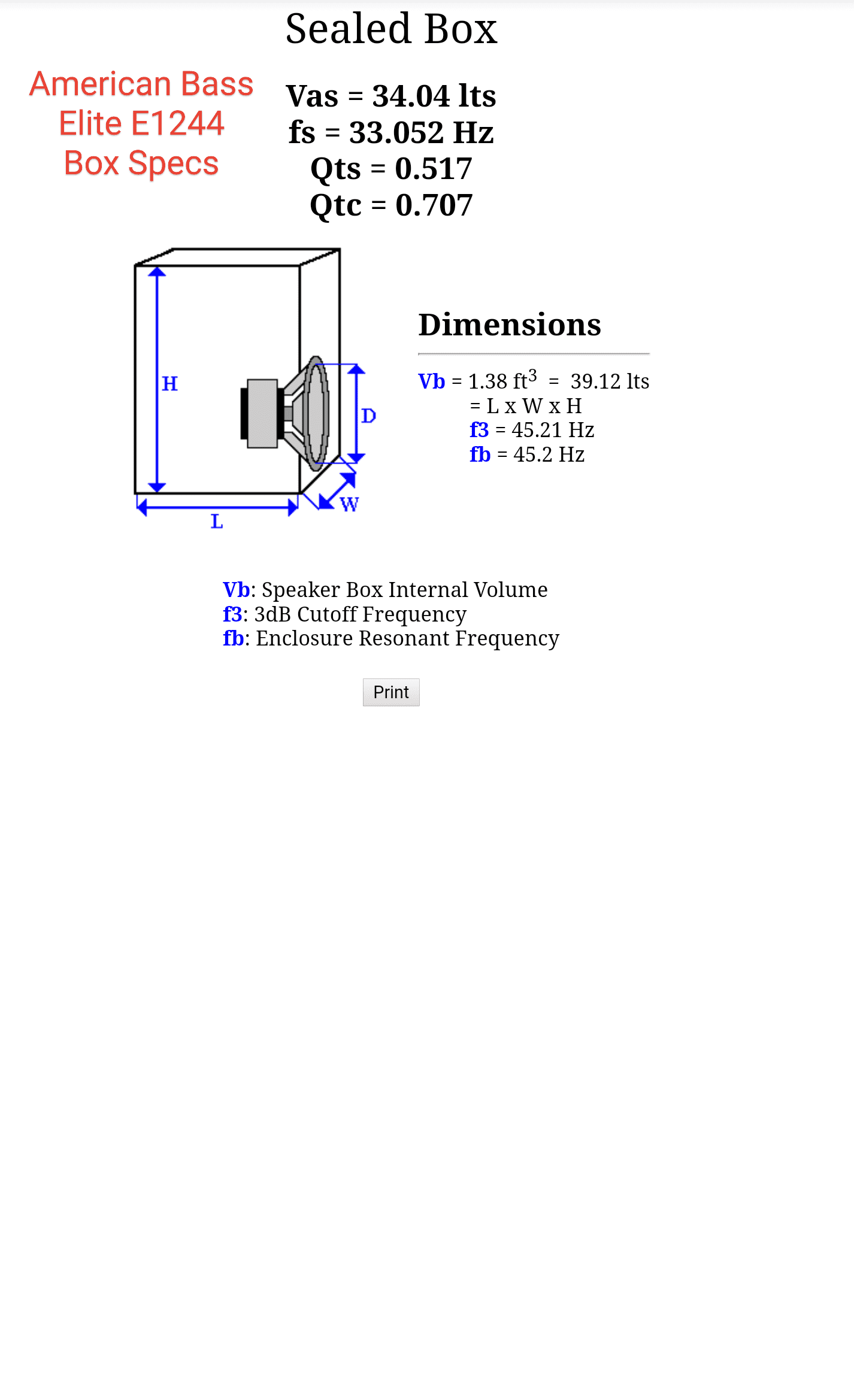

For the American Bass these are the parameters for a sealed box.
I do not know what Boss sub you have.
If you put them in one box, go sealed and use a divider.

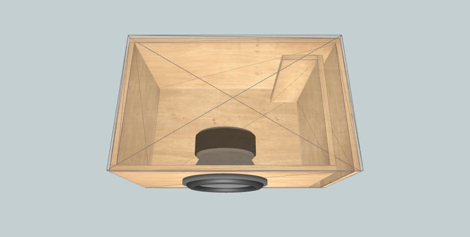

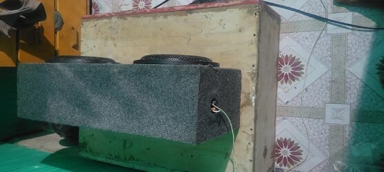

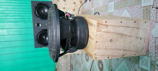

This the box i have them in but like its not the right build am not sure, h13" × w32" × d25"
A sealed box is up higher and this looks really close for ported
Ok, i have a single 12" box i used to play it in dimensions are , w31" h13.5" d17.5" n the port is long inside its 3" wide port
