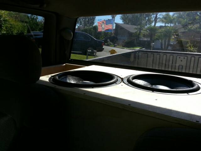

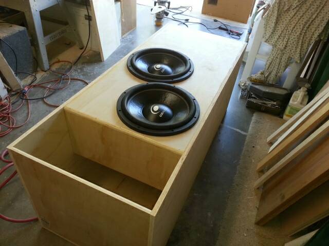

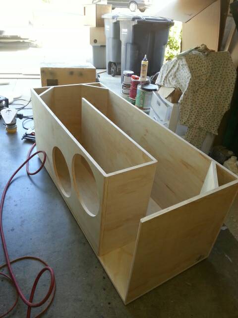

Got 2 1544's in a tline @28Hz with port extension. Plays from 18-70hz and is loud af. Bout to jump from an xtr2200 to an fsd3800 next week and see what kind of numbers I can put up.

[quote name='CSCStang']Got 2 1544's in a tline @28Hz with port extension. Plays from 18-70hz and is loud af. Bout to jump from an xtr2200 to an fsd3800 next week and see what kind of numbers I can put up.[/QUOTE]
Whats the specs on the box? Size and all? And whats the difference sound wise between a Tline and a ported box? Isnt it just SQ?
60x24.5x23.75. Difference is output and bandwidth. This box plays from 18-80+hz. It's definitely SQ as well as SPL.

T lines are generally loud all around. CSCstang's setup is extremely tight and punchy, double bass pedals are wicked in his box. Most ported cannot hope to play that region cleanly without sacrificing a lot of low end with the ported box size and tuning. However his is loud and clean all across the frequency down low and up top along with moving great amount of air.

That is absolutely beautiful Lol. Im trying to come up with a design for SPL in the dimensions i stated above^. I plan on taking up my entire trunk and running the port through a hole between the seats.
Thanks man. Forgot to add that it's 247 sqin of port with 121" port length for 28hz.
