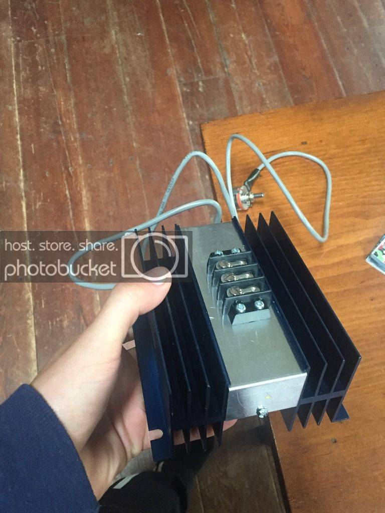

Well, the wall has been torn out for a while and I just got the external voltage regulator for my new alts. They should be ready in a couple weeks. There was a delay because I requested an extra special paint job. //content.invisioncic.com/y282845/emoticons/up2something.gif.dd110ecf3ae4b76050d87598f2f8de7c.gif Going to be sick!! I am a little worried if one regulator can handle three alts though. I saw some people online had problems externally regulating multiple alts with one unit. I might be going up to Minnesota for a month, which would really throw off my plans. One of my other uncles lives there and was putting in a huge retaining wall when he hurt his back. He offered to pay me quite a bit to finish his landscaping project. It would finance the majority of my build. If that happens, my 7k's will sit out in the shop for a while, just collecting dust
One blue box for 2 alts... don't run three one one box.
I've got one of those regulators here I'll sell you on the cheap if you wind up needing more.

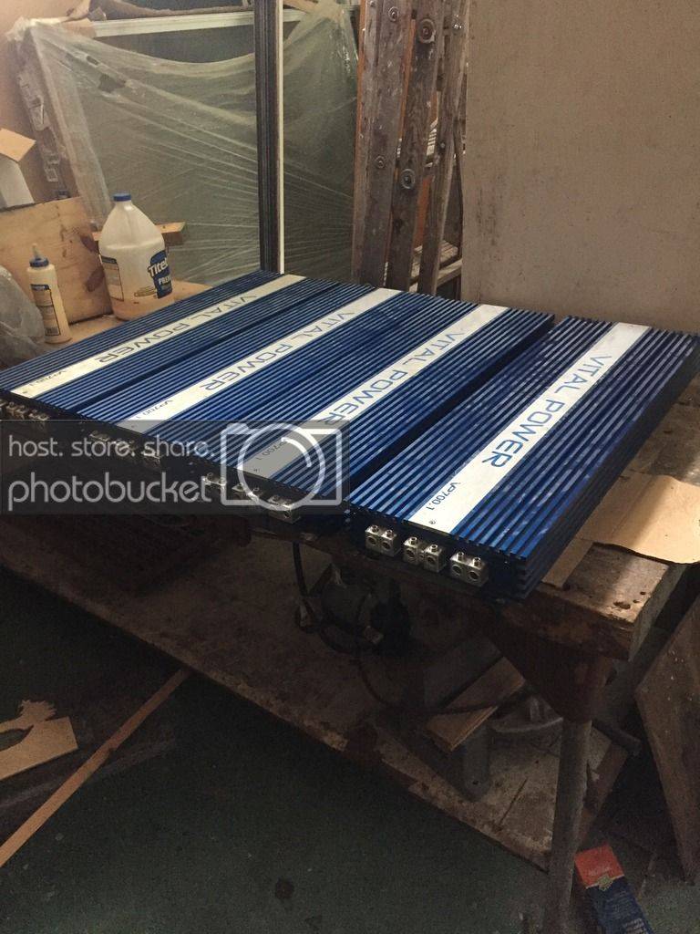

Any gut pics of those amps?
How cheap? Want to PM me?
You know, I have the bottom plate off of three of them, but never took gut pics. I can this next weekend though. Right now, I'm six hours away from them. Here's a stock photo though:
Ok, thanks.

Alex sends me 70$, I ship it to wew_lad who pays for shipping to Alex, provided both of you are cool with that and Alex can wait til you do your testing.
Mine has excessive amperage label on it but it's the same unit
sounds good, im willing to back out at any time if he needs it sooner.
any link to what the specs for it are? i assume it works for any GM alternator but I have 2 wire alts (L and B+ post)
