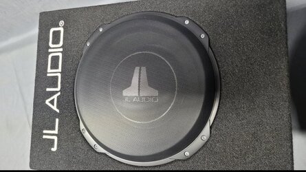

I'm ready to upgrade the crummy bose system in my truck. Not sure if I should get a dsp unit or an amp with built-in dsp. I want simple, good, quality and a good price point/used option of a higher-end unit.
I just bought a single JL 12TW3-D4. I'm not sure if this will be enough or not as I haven't hooked it up yet, but I'm open to getting a second one or even doing 4 8's or some 10s. The sealed enclosure may not be very good on the JL I bought. Any advice is appreciated.
I'm not sure what harnesses I'll need exactly. I've seen some T harness options online.
I could use the existing component speakers in the doors, but I may as well upgrade them while I'm there. Suggestions are appreciated on everything!
Thanks!

The first step is extracting a useful audio signal out of the Bose system, which is easier said than done. You will need an interface to remove factory filters and provide a clean, useful signal. You also need to understand if there are noise cancellation microphones that require bypassing.
Crutchfield is your best resource for getting started, as they can get you the right components to interface with the stock Bose system then amplify your sub.
