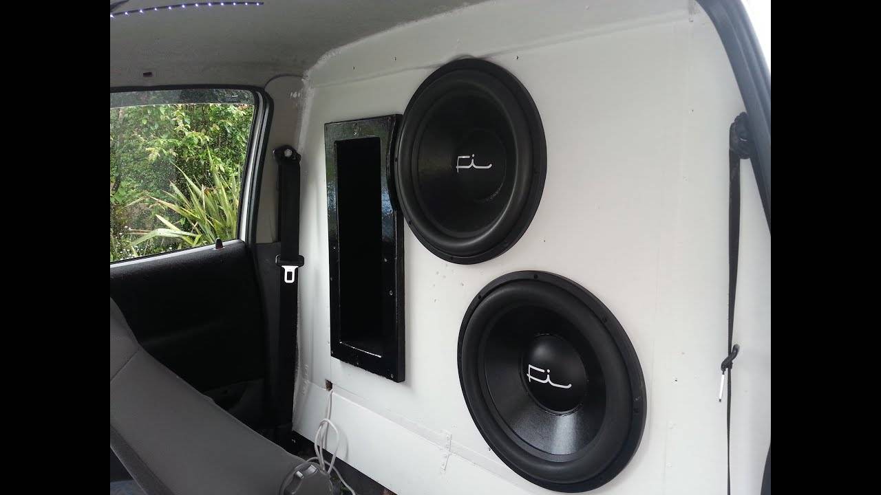

I was thinking about a port something like this screwed to the baffle:
or an aeroport something like this (larger scale of course):
images

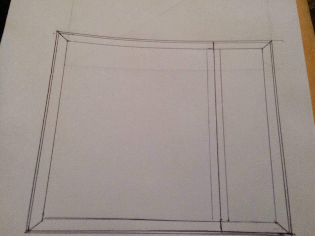

True it wastes a little room for sub placement but more than makes up for it in being able to easily tune ? And yes that port is exactly what i was thinking. I lost sketch up on last pc and never reloaded on this one as I was terrible with it, You know old peeps and there computer skills lol ! I will Old School sketch it up and take a pic in a bit but pretty basic just removable.

You could set it up either way but ya, but not optimal use of space maybe but use of wood ? Really wouldn't be that much more wood ? Really woods the cheapest thing we buy ? But think of all the wood you will save when you go to change things up just a new baffle and port totally saving the shell of enclosure right ? I am just thinking about it and how to do it , I am a builder but no way know anything about designing the enclosure . This is what I was thinking of and this would bolt to front of shell and I was thinking you could also use more angle iron on the backside back to back creating sort of a sleeve to make attaching it easer and stronger ? I don't know if you can see this ?
