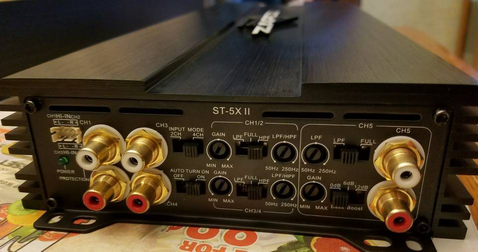

I haven't posted to this thread for a while and things are creeping along. In late November I got a great deal on a Zapco ST-5X rated at 80 x 4 plus 350 x 1 all into 4 ohms for $130 shipped from Woofers Etc. through Amazon. The amp was down to$199 after Black Friday and I took Amazon up on their offer to save $70 by signing up for (but not using??) their credit card that I cancelled shortly thereafter. Amp has what I need with built-in crossovers and high level inputs. Initially wired it to the factory speakers using Honda's HU.
Sent from my SM-G930R4 using Tapatalk

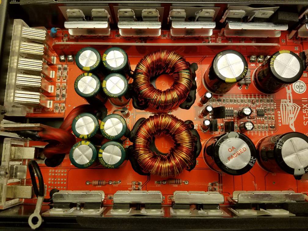

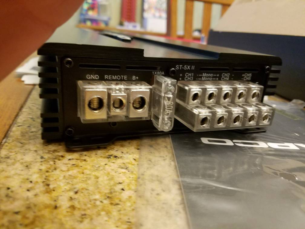

There wasn't anything special about my.install: 4 gauge, 100 amp fuse and high level inputs from fronts/rears and a DIY LOC for the sub input.

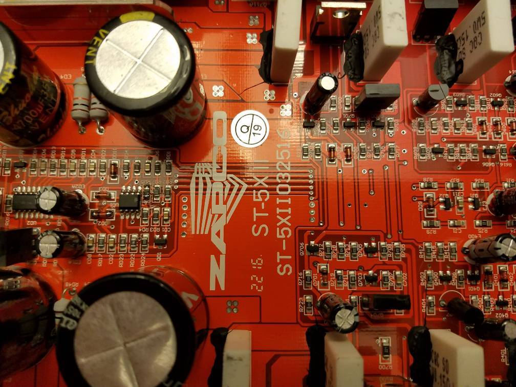

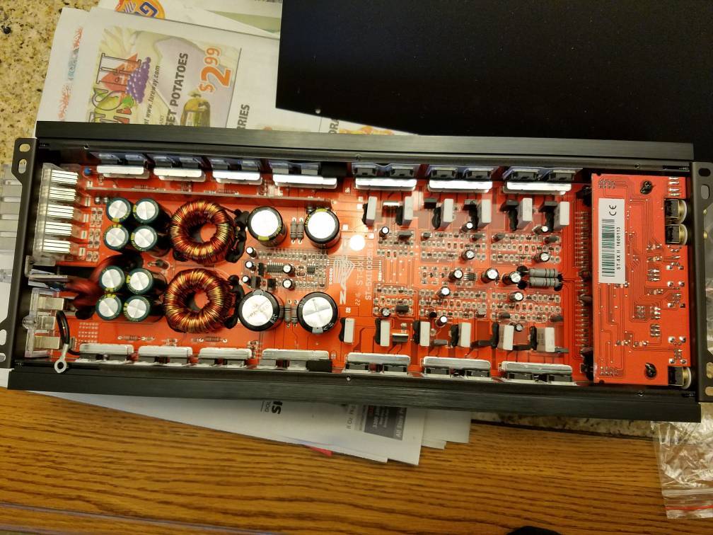

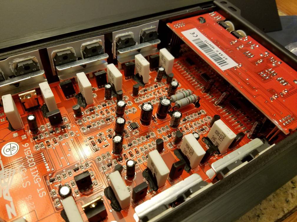

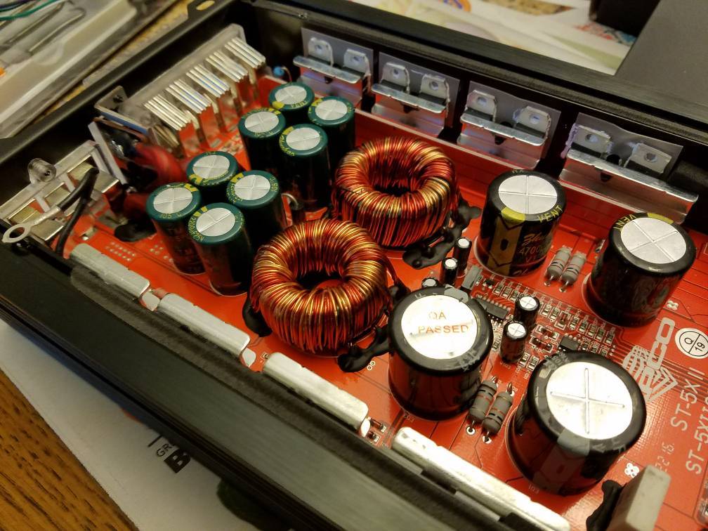

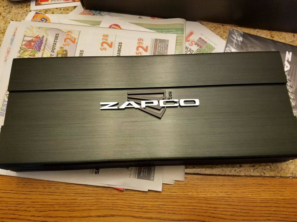

Instead here are some pics of the amp.

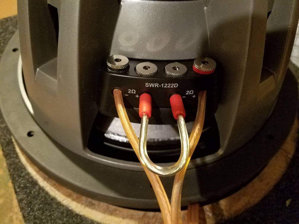

Think these pics were taken December 2nd and it didn't take long for me to want more low end.

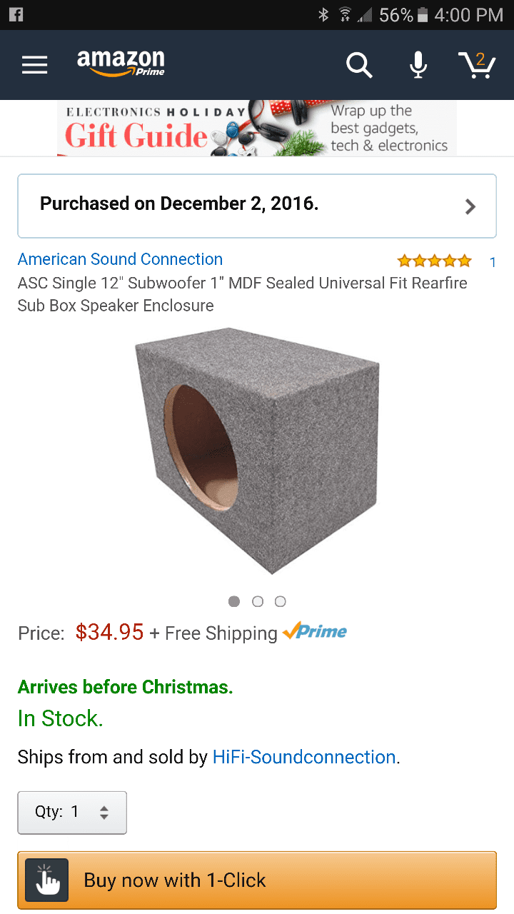

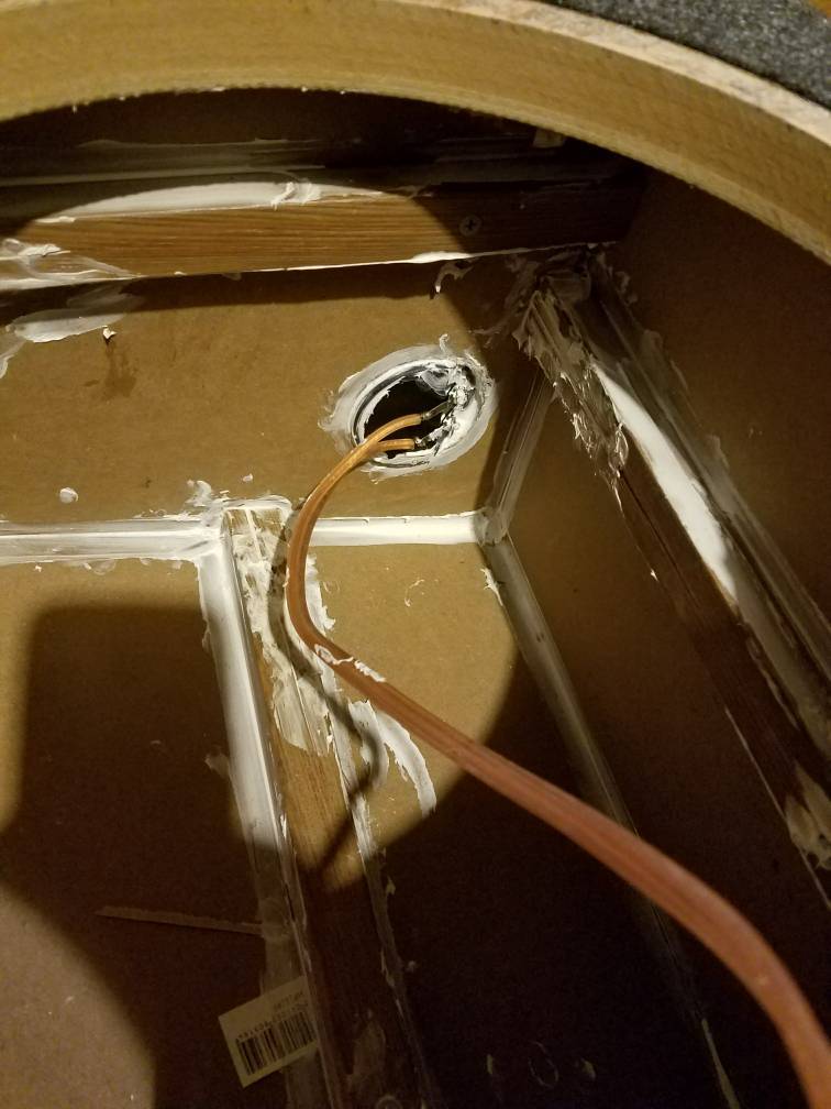

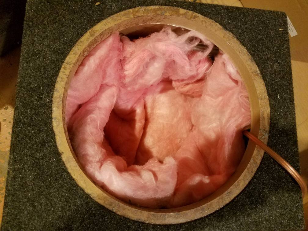

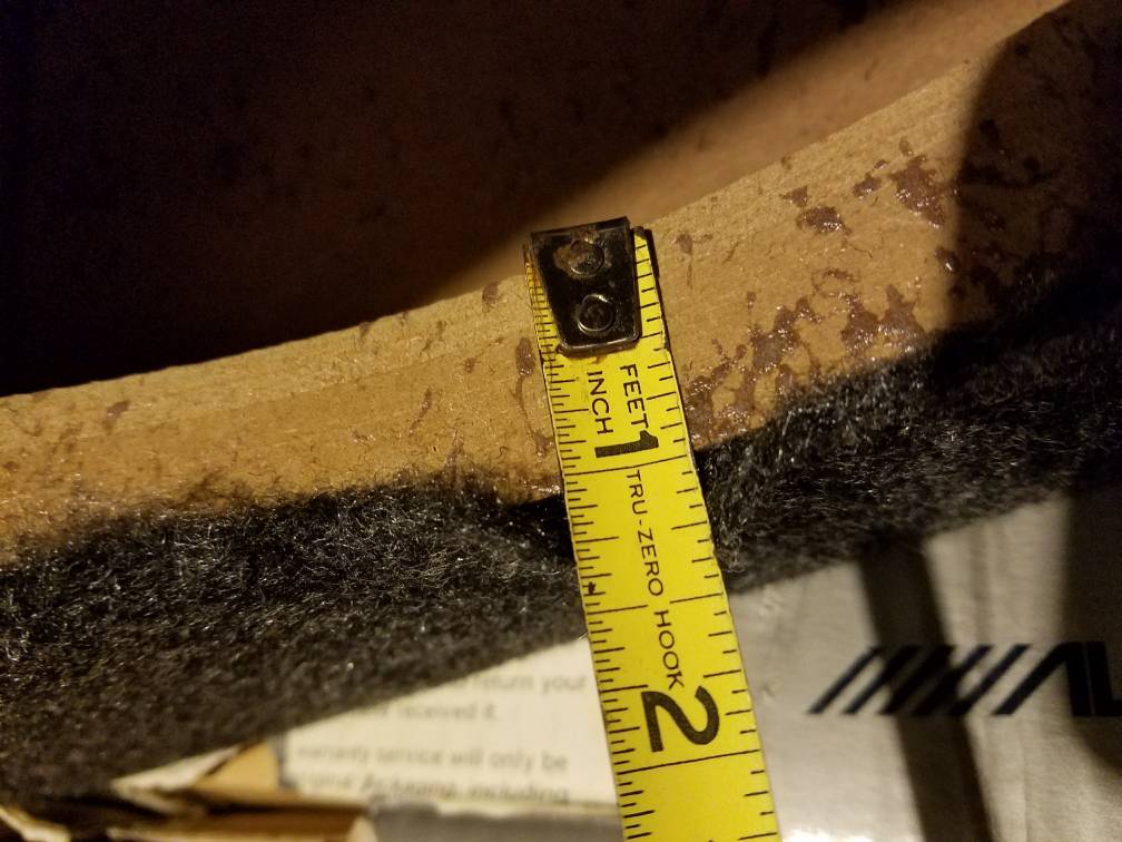

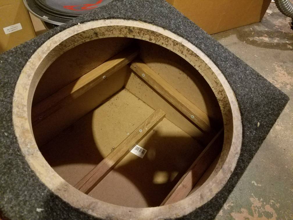

I was able to get an older (grey) NIB 12" Alpine Type R dual 2 ohm sub for $50. As it was getting colder I went for a 0.96 cubic foot prefab sealed box from Amazon that was supposed to be 1" MDf. Turned out only the front​ was 1" so I internally braced, glued and sealed the box then stuffed it with fiberglass.
Whatever needed to fall in place did - the sound is amazing and incredibly low.
Cost to this point: $249 (free labor)

I would've used polyfil instead of fiberglass....but whatever...lol..
I know and that's been an ongoing discussion for years. I only use fiberglass in sealed enclosures and either here or another forum someone posted as link to a well executed comparison of fiberglass, rock wool and fiberglass. Last fall I had a conversation with one of the engineers who helped design the original Alpine Trype Rs who said fiberglass is still the best option with the new soft touch denim insulation being comparable.
-Eric

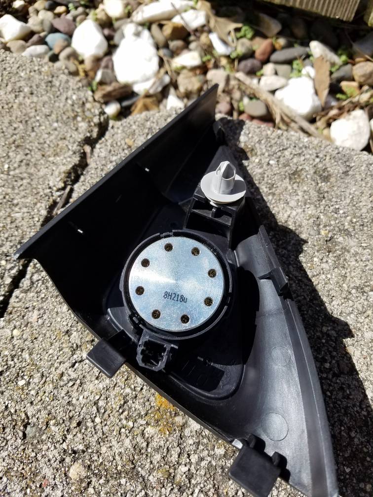

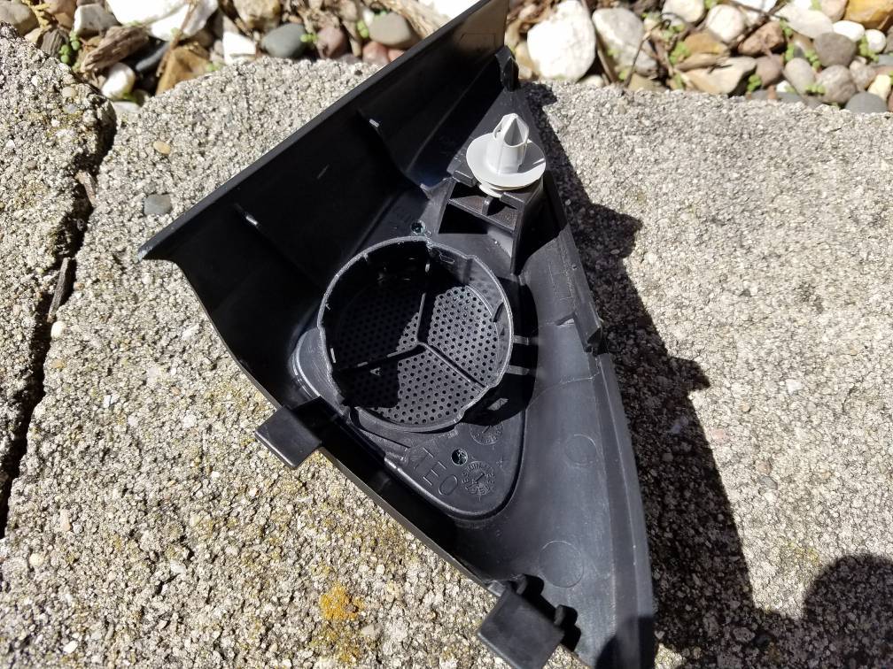

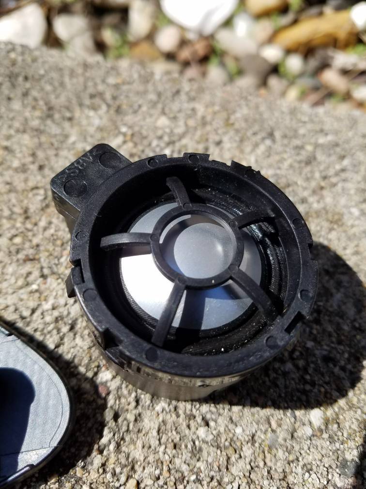

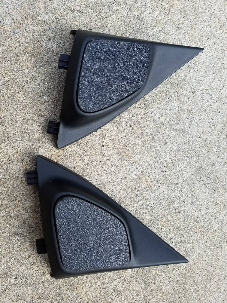

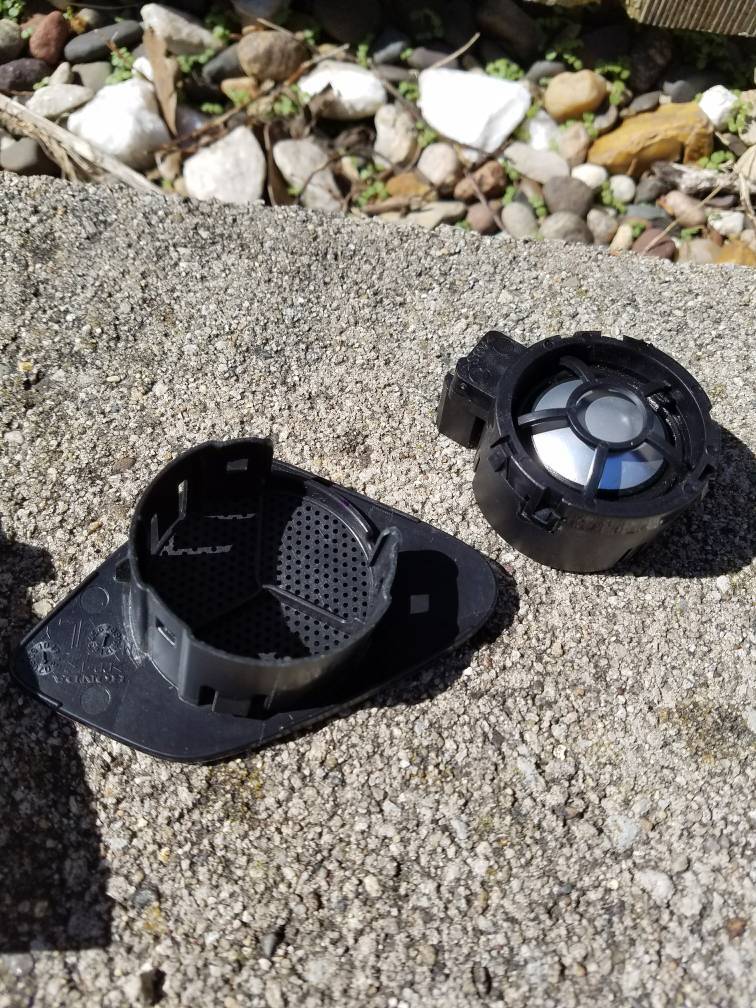

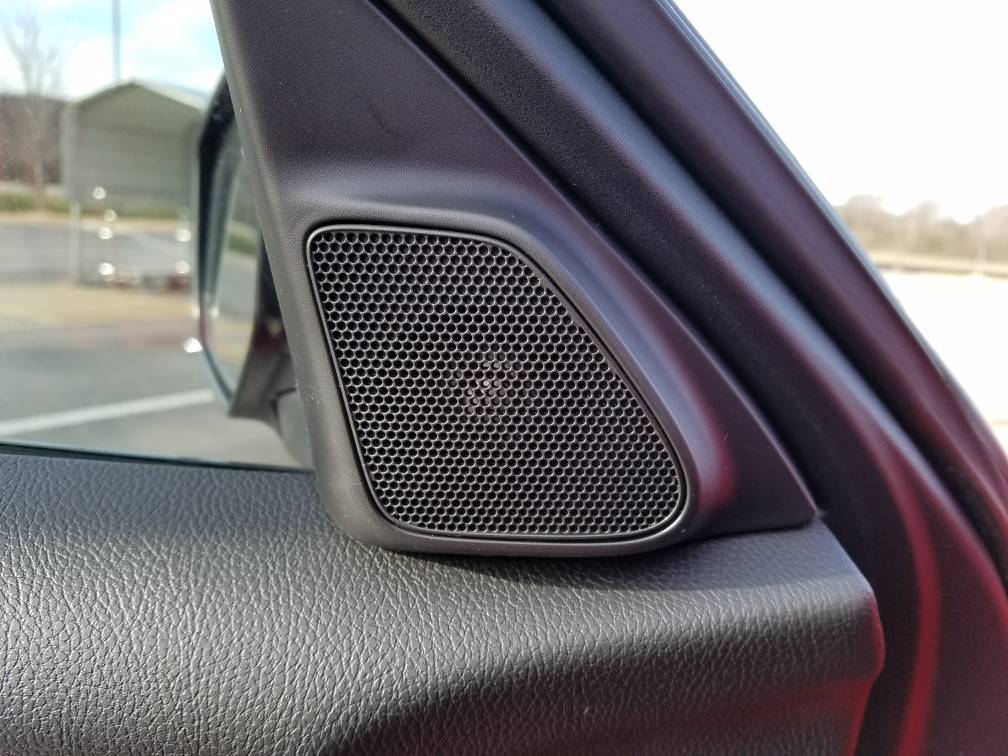

Here's a pic of the factory tweeters - my goal is to be able to easily return everything to stock if I trade the car:

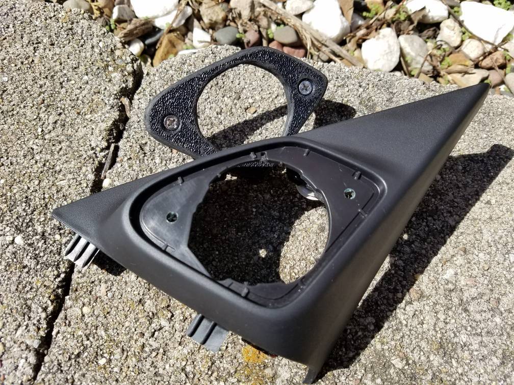

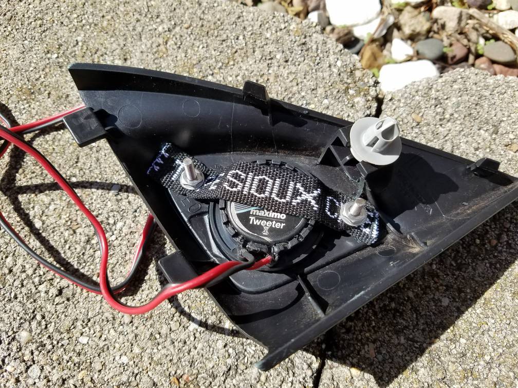

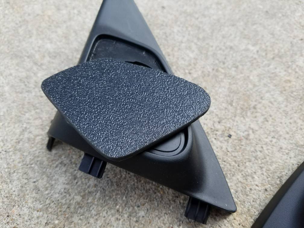

What I decided to do was create a new grill leaving this one untouched. The factory tweeter (metal) snaps out of the back then the grill pushes out the front.

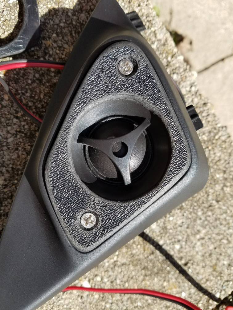

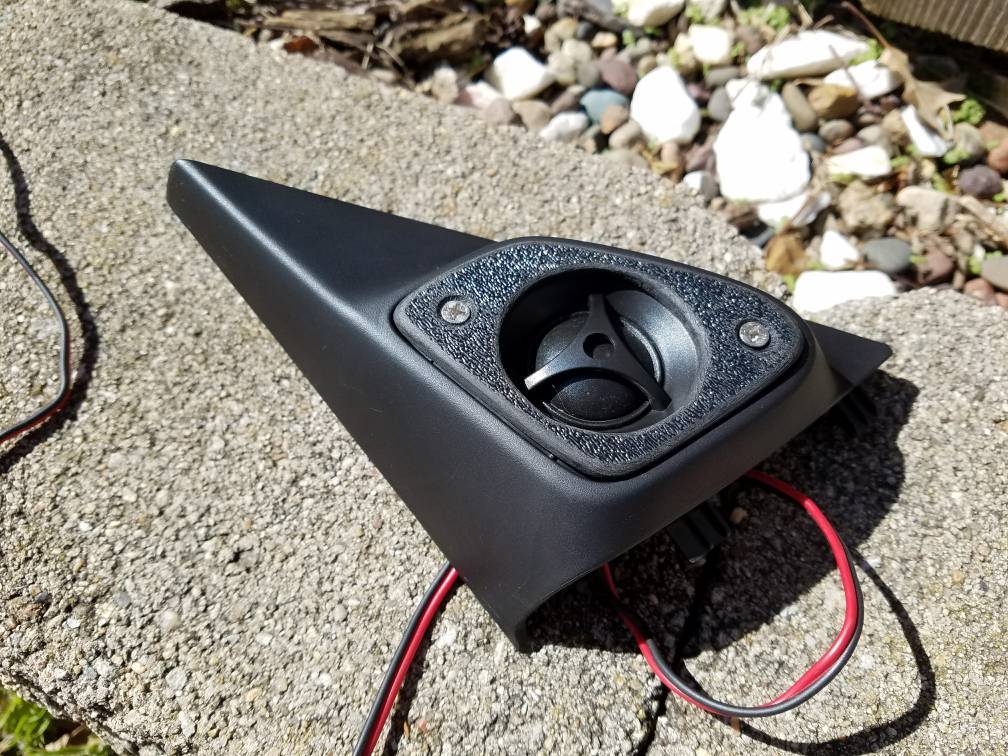

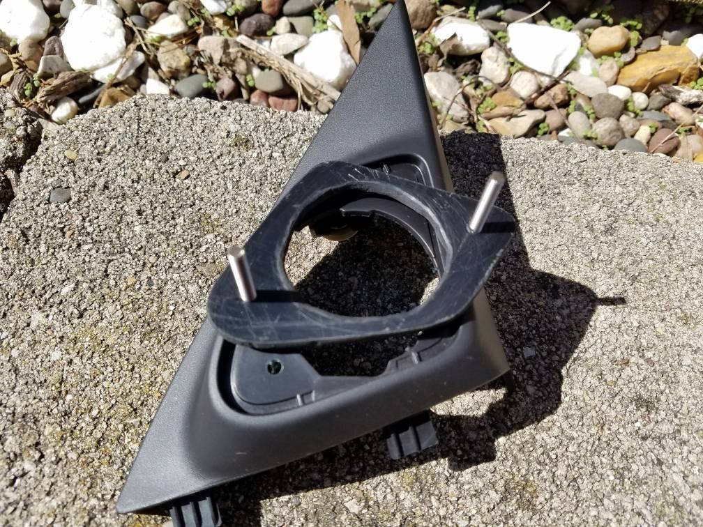

Started by copying the grill with 1/4" ABS and I may redo them with 1/8" as I thought I'd need the extra depth for the protective dome on the tweeter.
Cut approximately a 29mm hole for the tweeter, rounded the edges to minimize defraction, flushed 2 6mm machine screws in and used ape tape (hanger strap) to secure the tweeter.
