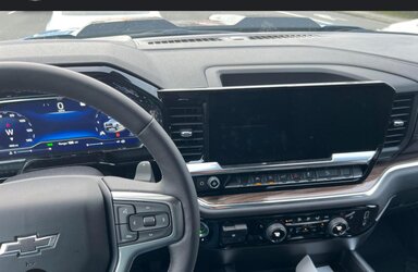

Im really missing a nice sounding system. The Bose systems in the newer GM’s don’t seem nearly as good as one’s pre 2019.

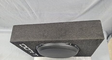

Current sub: JL Audio 12 tw3-d4
(May add a second depending on how it sounds)
AMP: Need solid advice on a pre owned, refurbished, or open box available amp. I hate paying full retail for the latest and greatest. I’d like one that can power the one sub I have but could also power a second without issues if I go that route.
* DSP is needed. Is it more cost effective to add one of the less expensive DSP’s or to get an amp with one built in.
* if I can find the perfect amp in the $200-$400 range that would be great. I would go up to the $700 range if the reasoning made sense.

I'd get a JL fix to deal with the Bose system or you could ask Crutchfield if they have something specifically for it. For speakers, I really like Audison. They have an insane timbre. For something more revealing, go Focal.
