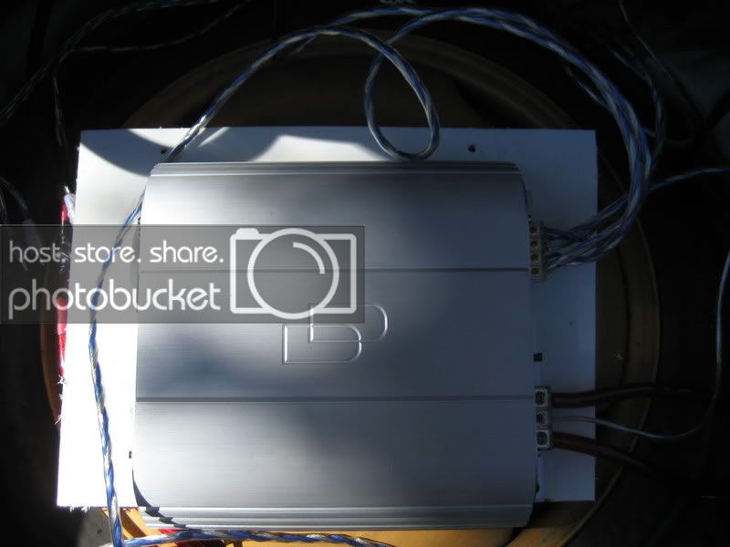

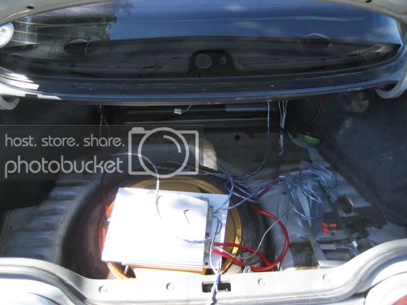

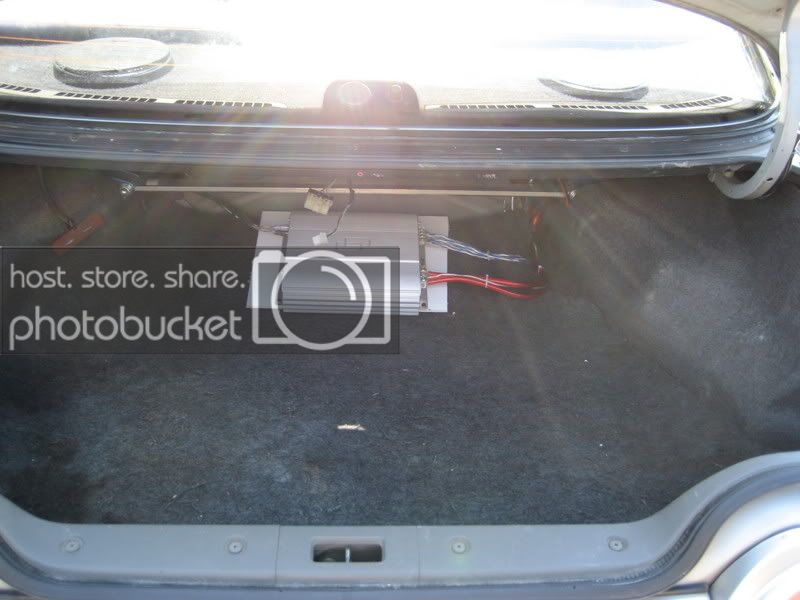

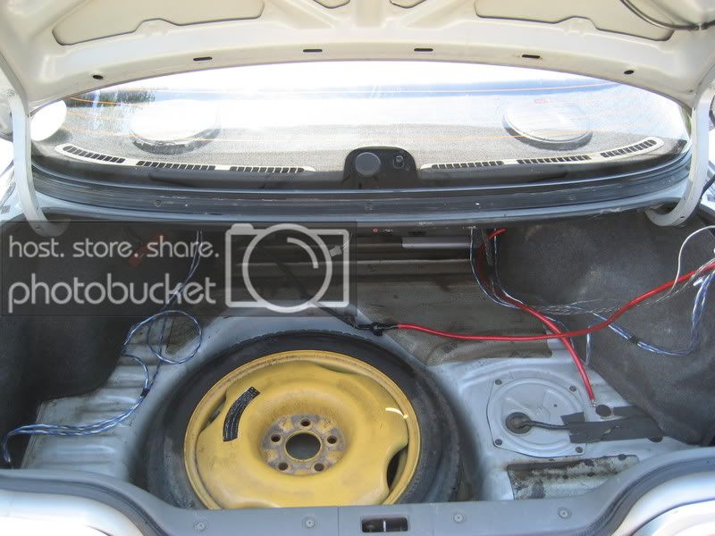

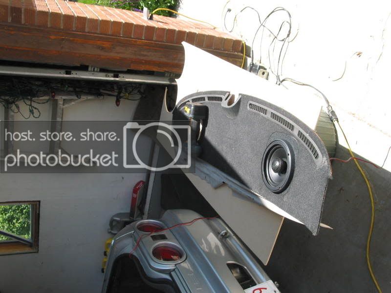

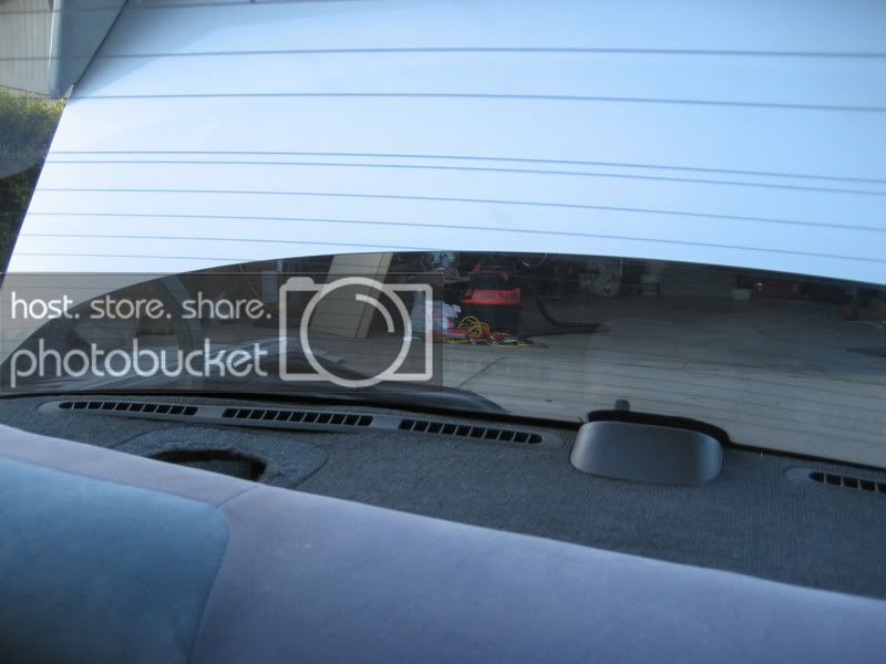

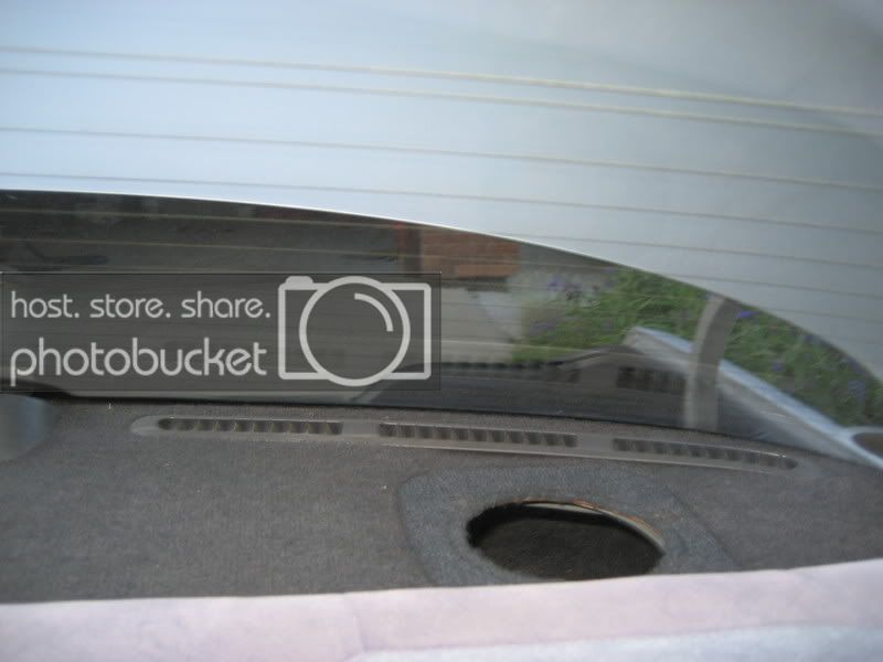

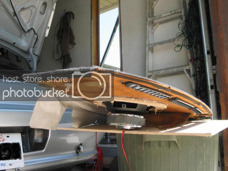

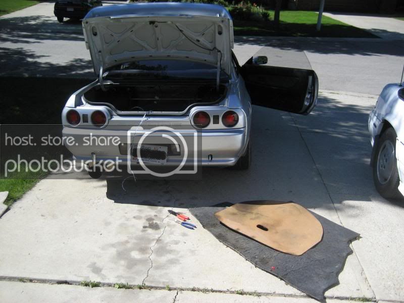

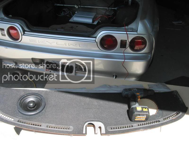

well i wasnt going to do the rear speakers until after he got back, but he told me to have another day and get em done. turns out they went in far easier than i thought they would be(i thought the rear deck would need some cutting, but it didnt). after i got all four installed i took a listen. and ****. these speakers sound awesome. and they actually have really good bass. the rearview shakes a little lol. and they kinda pick up the lows and make your feet shake a bit. overall they get loud and sound wicked. and i dont mind having speakers behind me..but i did still set the fader farther up then most people would. but as long as the customer is happy, thats all that maters. and i guess i will see how he likes them when he picks it up later on. here are a few pics from last night/today
i also just noticed how dirty the carpet is on the rear deck. lol i will shampoo it when it comes out for deadening in a few weeks.

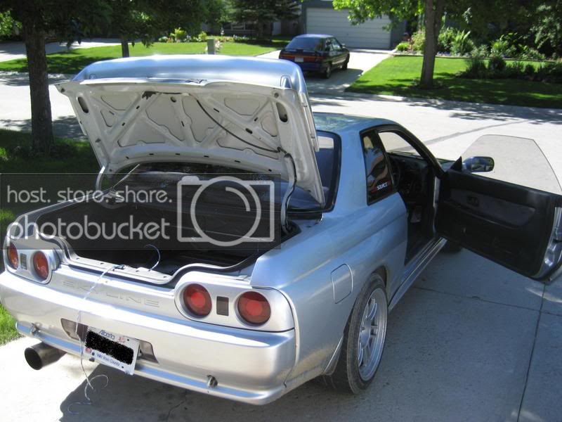

ahaha you edited out the license plate number on the 1st picture but not the 9th picture is pretty much a close up it. Nice work, besides that.
lol ya im editing them out right now. its probably not a big deal, but i wouldnt want to risk it. and thanks:)

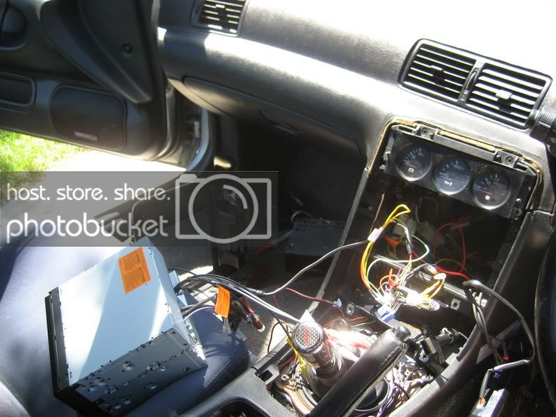

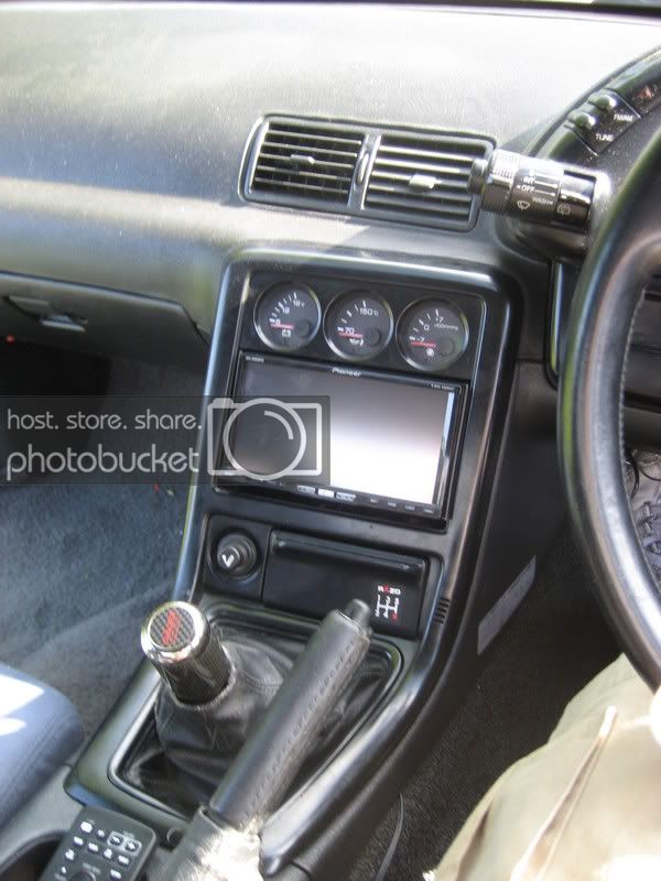

well after installing the dvd indash i realized it has some weird engine noise. i relocated both the head unit ground and the amp ground three times. i also grounded the rcas which helped take away most of the noise. however there is still a whining that comes out of the speakers as i accelerate. i worked for three plus hours ttrying to locate the source but it still is there. after consulting my friend who is an installer i realize it may be alternator noise. anyhow the dvd unit is wicked. it has a has a real nice picture.

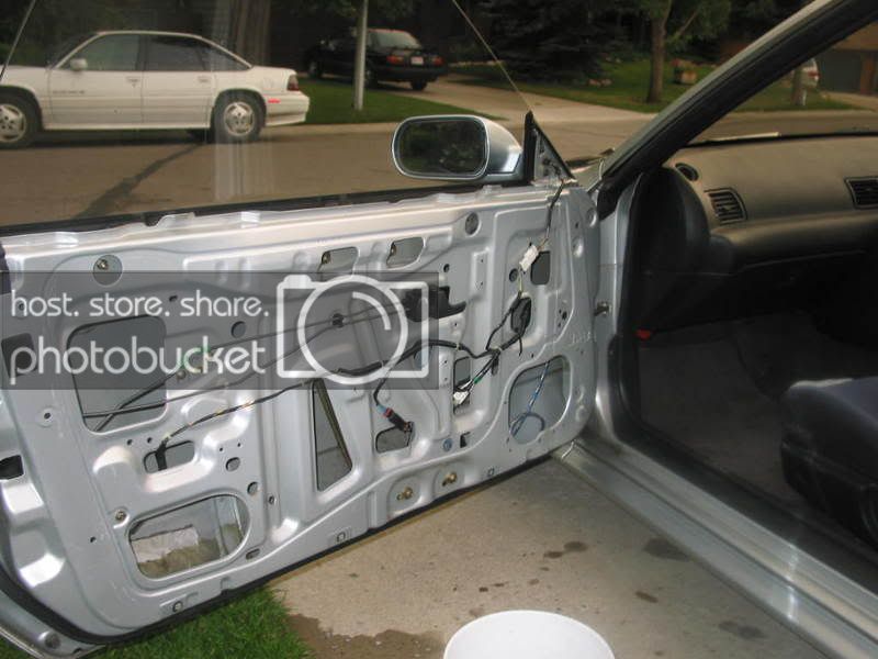

so far i have used gasoline (will use rubbing alchohol on the next door) to remover the silicone holding the factory plastic cover on. then i used heavy duty degreaser to remove all the gas/grease. then used soapy water to cleanse the rest of it. now its all good to go for the dynamat. the whole door will be deadened, along with behind the speaker
