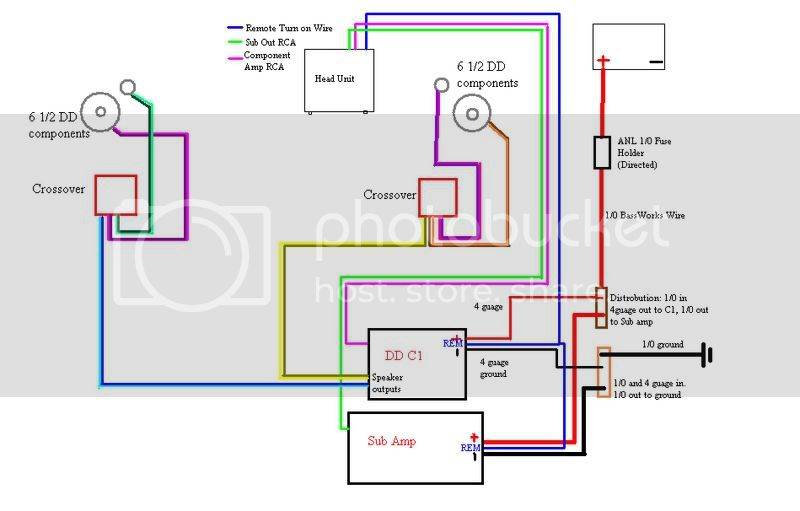

As of now it has some japanese aftermarket deck that doesnt even pick up fm stations and crap sony speakers all around. so obviosuly it is time for change... There will be two or three stages to the instal. First off i will be installing all the wiring, headunit, ipod, component amp, components. will be something like this minus the sub amp. also the bassworks 1/0 is actually going to be 2/0 welding cable. the 4 guage is directed..and i do beleive the rcas are also directed.
