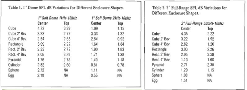

i feel the spheres are better, but a cylinder is capable of being as good if not better based on Dickason's measurements. but note he is discussing mounting on the side - not the top.

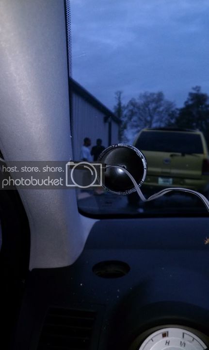

I finally got these done today and I was NOT expecting the huge difference these things made. My tweeters were initially on the dash facing the respective headrest. Now they are about mid way up my pillars, same aiming and it made a world of difference. My entire stage seemed to just open up. Also, even though the tweeters are actually closer to me than they were before, the vocalist seems to be right about at my windshield wipers instead of right at the tip of my dash. Instruments/musicians that were about halfway between center and far left or right now have more definite placement and my high frequencies seem a lot more airy with the tweeters being pretty difficult to locate by ear. Overall, I am very impressed and this is using the PVC end caps. I will be changing to wooden spheres some time next week.

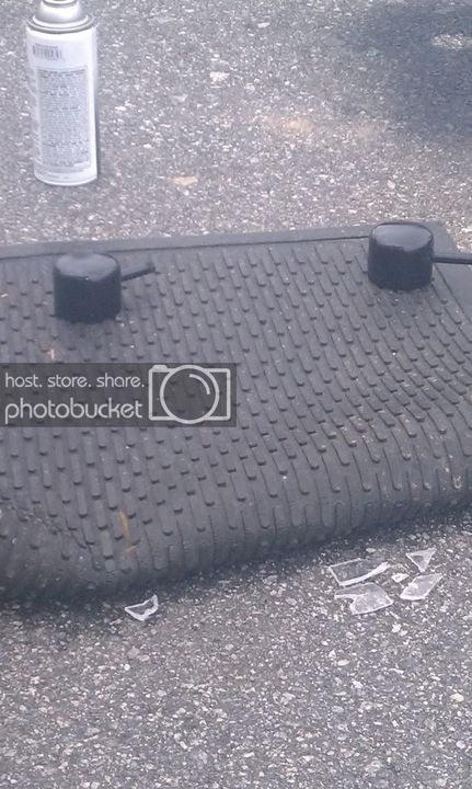

Thats right after they were sprayed. I should have let them sit a little longer as some of the paint came off when I went to install them. Not a huge deal since I'm going with the wooden spheres soon.
This is before I put the tweeter in. I didn't take any shots after the tweeter was in or of the other side. I can tomorrow when its brighter outside though if need be.
I also didnt intend for them to stick out so far but it was what I had and I dont think it looks bad, so I left it. I might switch up to shorter "threaded nipples" later though
