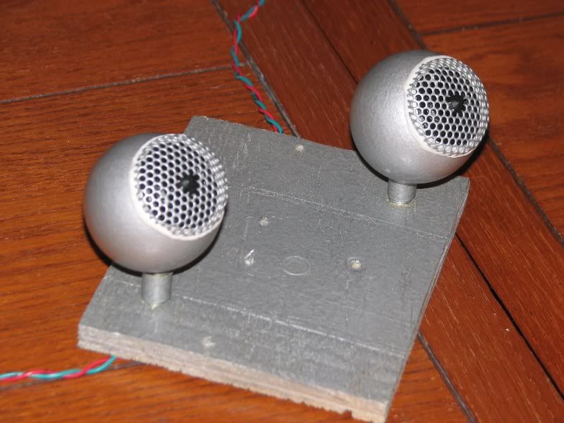

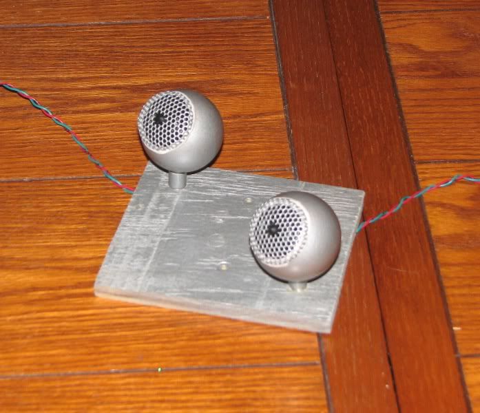

the real trick is figuring out aiming and the angle at which you should drill for the threaded rod - relative to the angle of the apillar.
i realized my angle is more than i intended, they will fire across more than i intended... so i may remake them. but for only a few hours - not a big loss. i'll run these for now. finish pics coming later tonight.
I used some rope caulk to temporarily hold the tweeters in place and also hold the grill on. i want to test before i make these permanant.

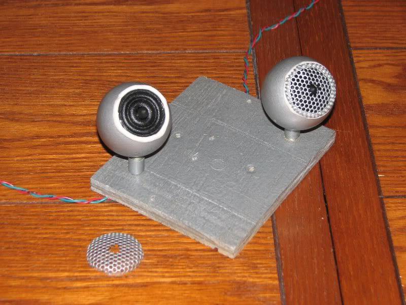

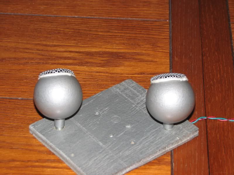

i'm also taking a different approach. instead of having the grill flush with the sphere, i have the actual tweeter cone flush and the grill protrudes - should be better, we'll see.
these vifa are tough since you have to make your own grill. normal tweeters are MUCH easier to finish off.
