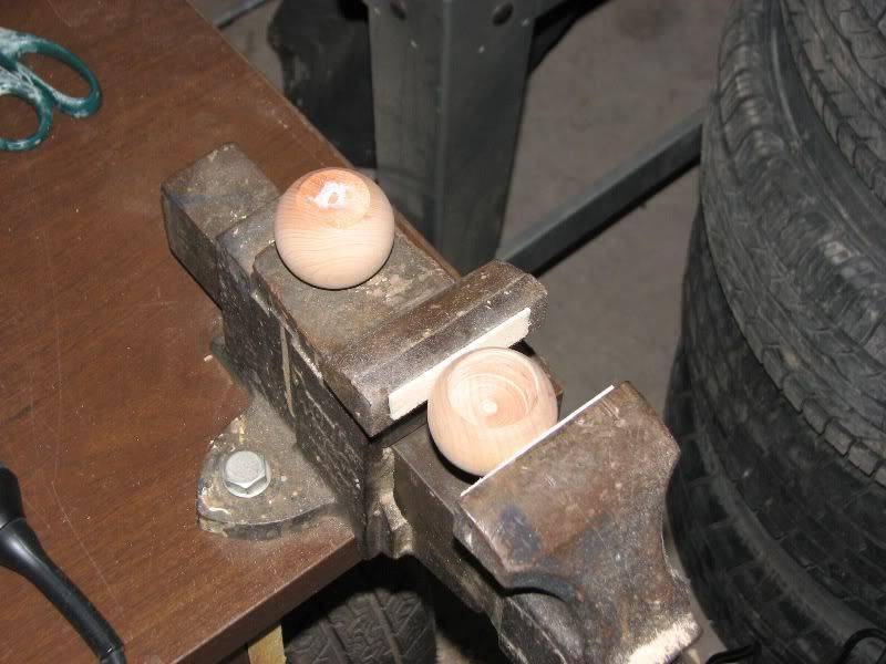

I started making another set last night, worked on them a bit more tonight.

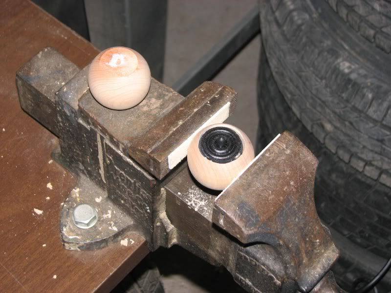

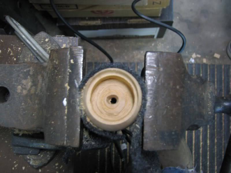

I buy solid wooden spheres ($1.50) - like knobs or post tops, at my local Hobby Lobby. i hollow out a cylinder, (using Forstner bits, hole saws, dremel, etc.), drill a hole for threaded rod, and then... i'm not sure where to go next for a nice finish.

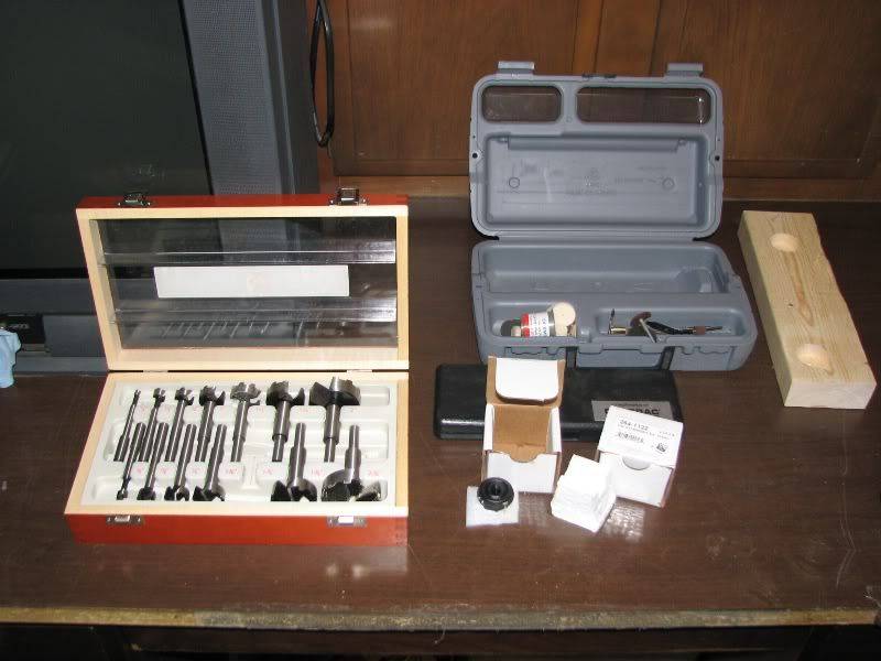

tools i use

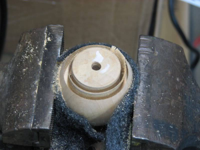

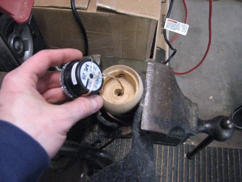

i used double-sided foam tape to hold the sphere in the vice without making marks. works well.
I had to dremel sand the opening a bit larger in order to fit. the Forstner bit was either too small or too large. //content.invisioncic.com/y282845/emoticons/frown.gif.a3531fa0534503350665a1e957861287.gif

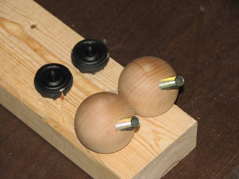

rods screwed in

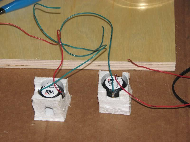

wires soldered on tweeters

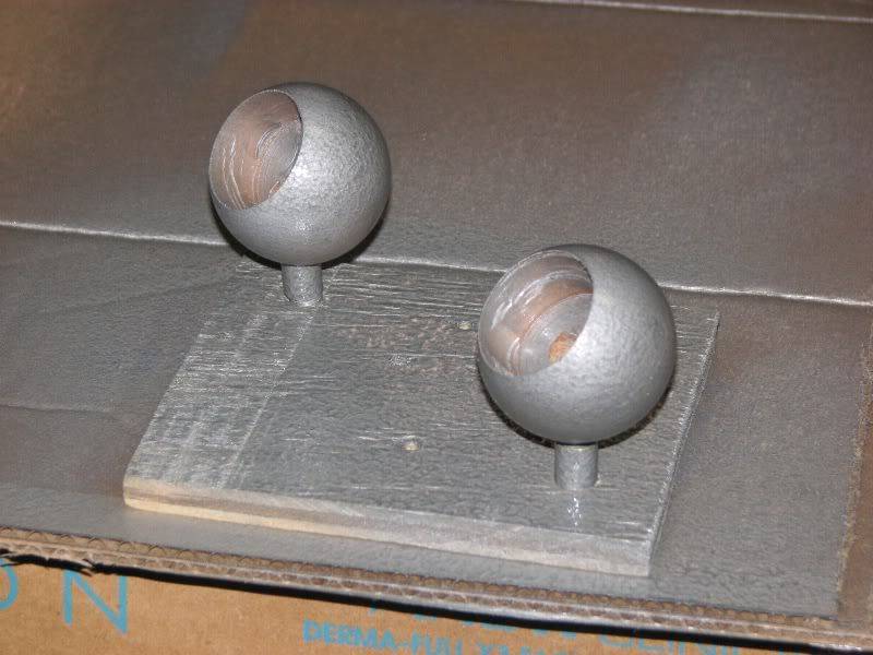

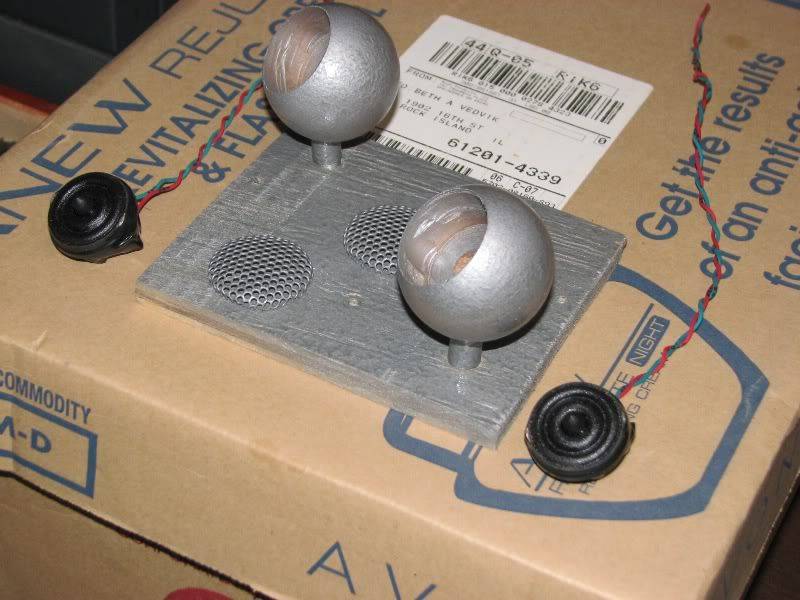

going with hammered silver paint (to match my painted interior)
painted and waiting (pic taken 2 hours ago)
i haven't decided how best to finish off the mount. there is a gap around the tweeter face due to it's construction. the widest flange is in the middle. so i need something to create a smooth transition. and then the grill - the Vifa doesn't have one. i have one, but it's larger than necessary.

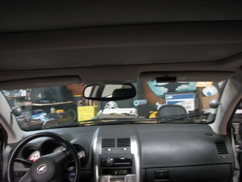

in the scion (temporary - we'll build another set)
threaded rods
mounting
aiming with foam and laser pointers

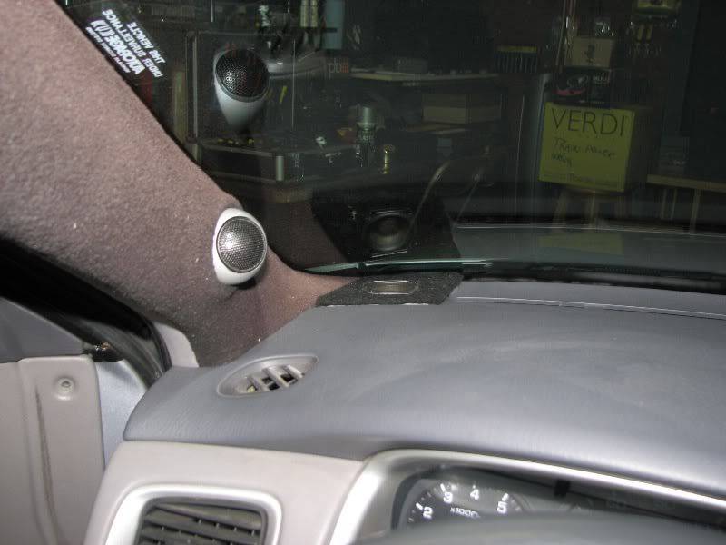

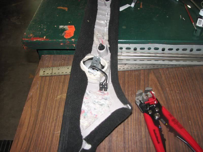

currently i have spheres in my apillar pods - i can rotate and adjust aiming - some Rockford tweets
i also played with these old Alpine tweets
but i have this version (painted)

aiming the tweeters toward you eliminates dominant windshield reflections.
firing across had reflection issues that resulted in phase interference.
reflections in the scion are off the nearby side window - which extends the soundstage width to beyond the side mirrors. it's cool.
the spheres in pods i have now are ok, but not ideal. course, they are just some random RF tweets i had laying around. they sound good for what they are.
