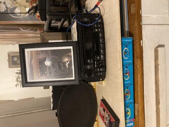

This is my completed project. Needs some led lights going around it. It runs on 2 car batteries and plays radio and cassettes. It plays static and few sounds. But big improvement. I’ll make it into a home system when I add more to it. That frame is from the car I took it from. 6 x 9s mid range.
