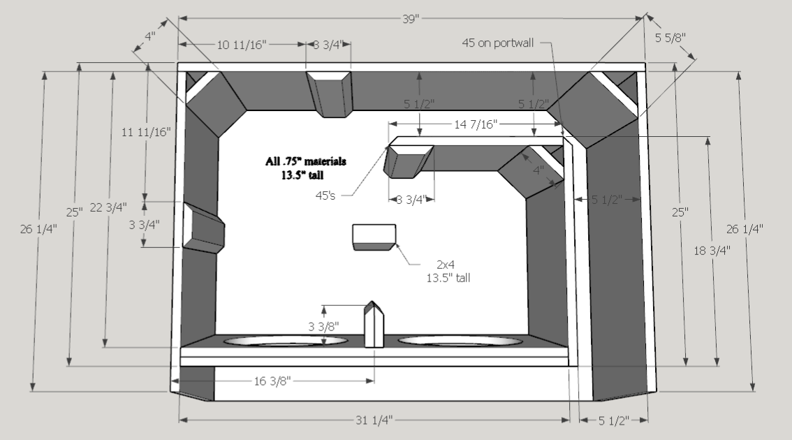

To build one you can't use external dimensions without experience and understanding port area/tuning even if its given. Getting the portwalls dead-on takes knowledge. This is a 3 common wall sub/port on face trunkwalled design /w/ minimal materials for 2 Zvx-12's and a 4.5K wired down.
I feel a bit more knowledge would be involved figuring port length than a calc gives. Consider power levels/vehicle/listening habits and you get a custom design. End-correction as well... it's all involved in being accurate, T/S parameters plugged into a modeling program on your power is the best way.
I dislike inaccurate ported enclosures myself... low tuned even
Above Zvx-12's wired low on 4.5K is the plan... space limited and trunkwalled... a custom enclosure is more than volume/tuning.
He wants output in the 30's and under, Sql?.. ok then... it'll need to be tied together tight and deadened to the max but I suppose it could be called Sql. Saturn Aura... its gonna be torn apart at .5

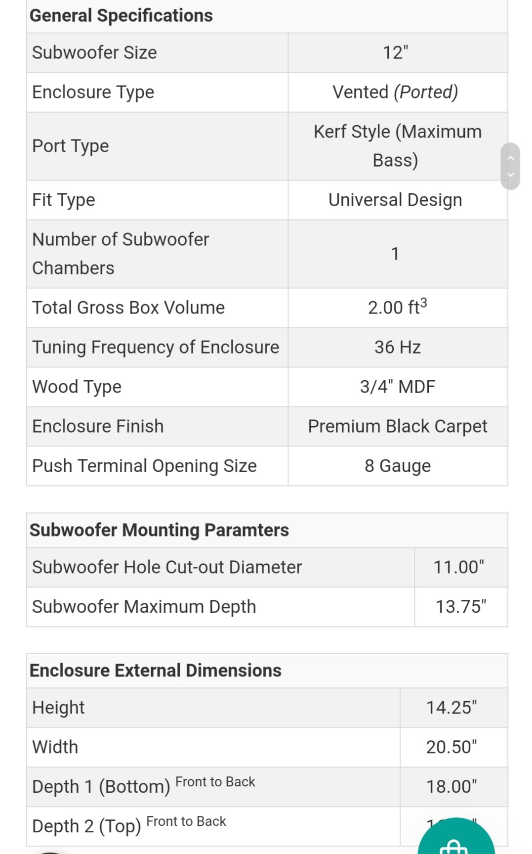

The other can be found on eBay two dollars more, I believe it is 5/8 mdf is that the same as your suggestion? I'm leaning toward yours
The Skar one is at least 3/4" MDF. Just get a black sharpie if you don't like the logo. Of course, a custom box will always be best. Maybe, @shredder2 can chime in on if this port dimension will work for your sub.
