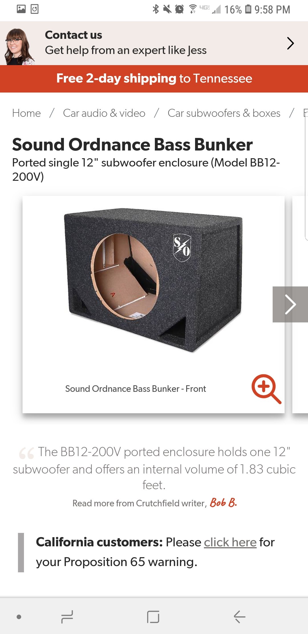

Ordering a 1.83 sound ordannance box off crutchfield to make sure I get it rigbt, the box I have I think is sealed and only 1 cubic feet, do you think going from sealed to ported and adding .83cubic feet will make a big enough difference it'll be noticeable ?

It might suffice for added output in the 40-50hz range and make you happy, which one did you get?
S/O prefabs are just that... prefabs with higher tuning and mass produced, building a custom design for that P3-12 eventually should really make a difference. That S/O enclosure is probably nowhere near this size...

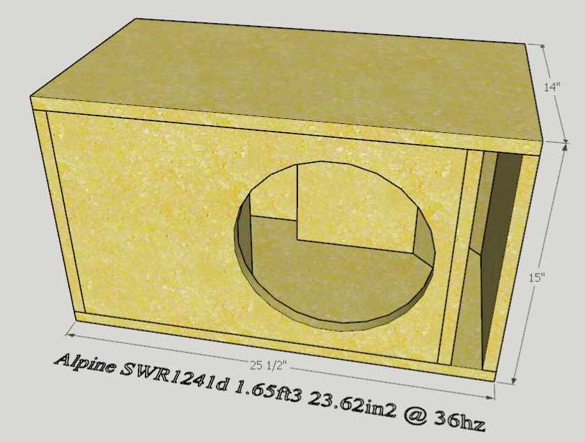

1.65ft3 net after displacements... it's for a similar sub and made a big difference over sealed.

How much would this cost to build And what materials would I use ? Also how do you get it to "tune" to a certain hz
Port area in a certain volume tunes an enclosure, It's best to learn to model any enclosure on your power but with only a 600rms amp @ 2 ohm in a sealed enclosure... I'd expect noticeable gains even with a prefab... just not great low-lows.

I thought so... lol... yep... that thing sells and might bang (or maybe not?) but not dig well. The cost to DIY a single 12 enclosure is $40-$50 in materials, as long as you have basic tools (jigsaw, screwgun)... any big box home improvement store can usually make the larger basic cuts, so assembly and cutting the hole shouldn't be too hard.

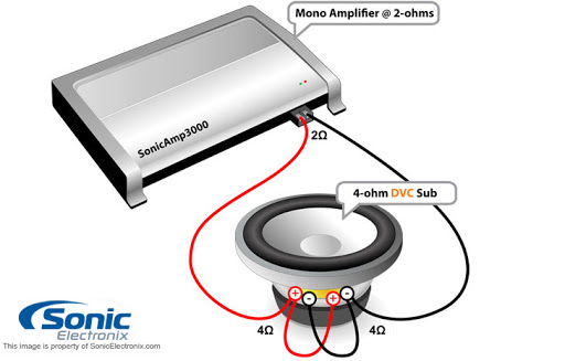

It sounds silly but pull the sub out of the box and triple check that the wiring is like this pic.
