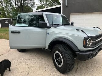

Do you prefer to keep a sub in the stock location? There are some 8" subs that can be pretty loud. Not like a 10 or 12, but still pretty good. What year is your Bronco?
I wanted to keep it all hidden and save space but after doing this mod.. i'm thinking i might as well go with a better set up.
My bronco is a 2024, just got it a few months ago.. love it !!
