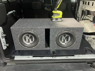

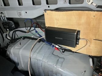

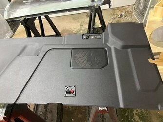

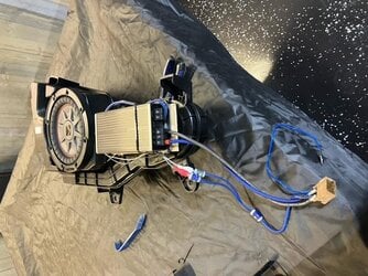

Well the end result for my bronco was keeping the kicker key 500.1 and running a wire to use an external box. So far .. I'm very happy. That little amp is impressively powerful for how small it is. It bounces these Memphis 10"'s easily and puts out big clean bass.
I did try a sundown amp I had but I couldn't get it to sound good vs this kicker amp.. quite different.
I have a set of Memphis 12's as well but not sure that amp can push those so might just stick with the 10's .. although I think the 12's are less watts then the the 10's. :unsure:
Anyway.. pics show what all i did.
Thanks for chiming in everyone. Anytime I have audio questions I come here and you all are very kind and helpful.
