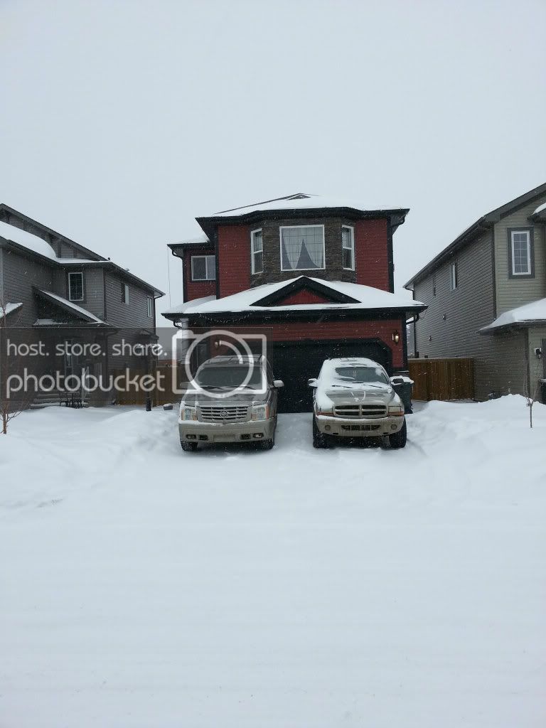

ok so im finding hard to get motivated when this is what my house looks like!
its probably also a good reason why my amps havent arrived.
well despite all the snow and cold, the amps arrived today. I was nervous about the condition they could have arrived in givin they were shipped across the country and crossing the boarder but they showed up in mint shape.
