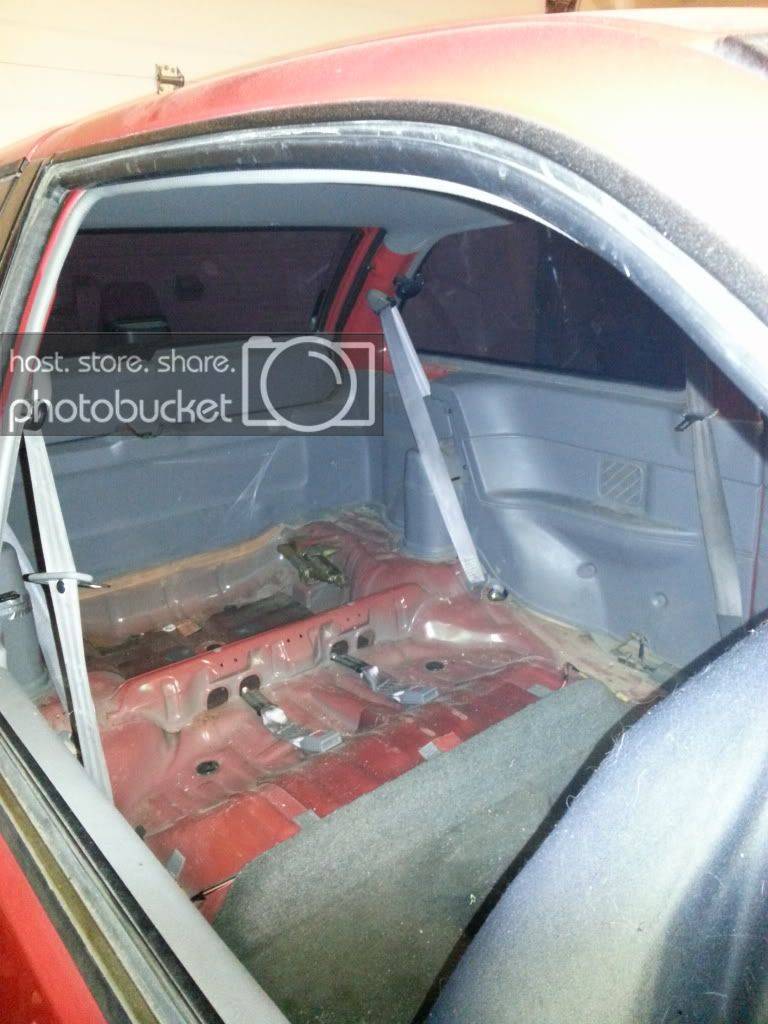

street max build on the CHEAP!!!

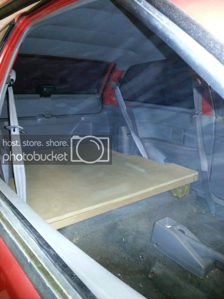

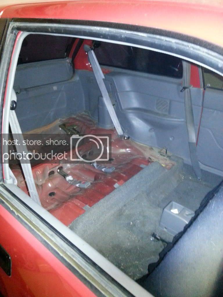

im ripping out the seats and making a sub floor now.

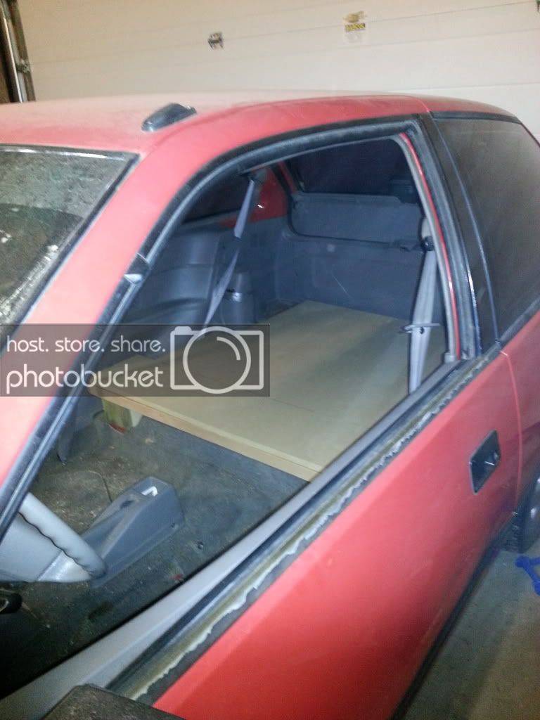

it does seem like its just flying by,... unfortunately the wife wants me to stop for a while,.. so heres where i leave it... FOR NOW!
sub floor is in but needs some final tweaks
this is where i left it last night

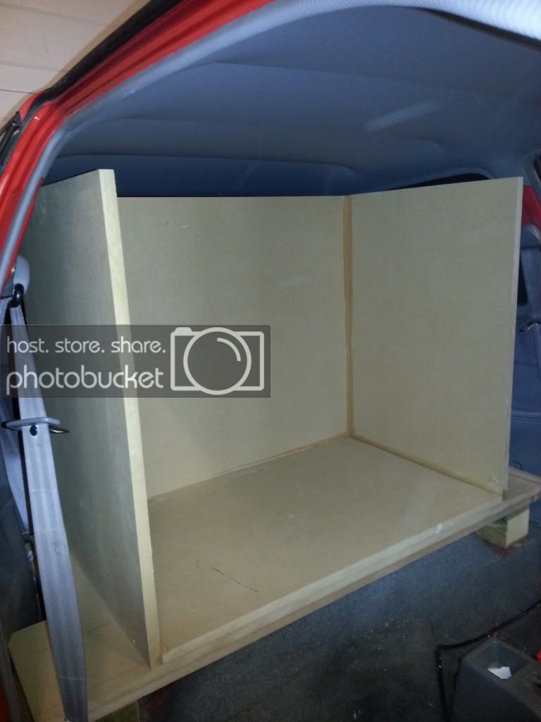

so I never did say what size the box was.
thought I might let everyone know now....
box is 10.5 cubes gross for 2 Atomic - 15"
port is 210 sq in 2.9 cubes disp.
should tune to 50-55 hz

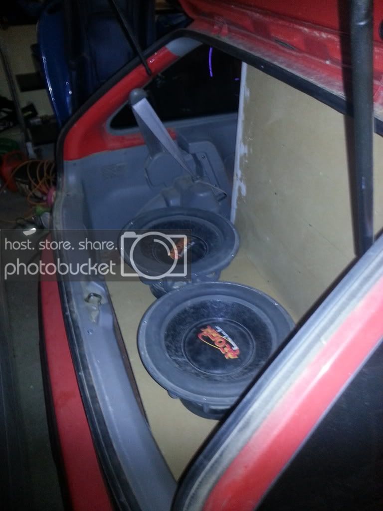

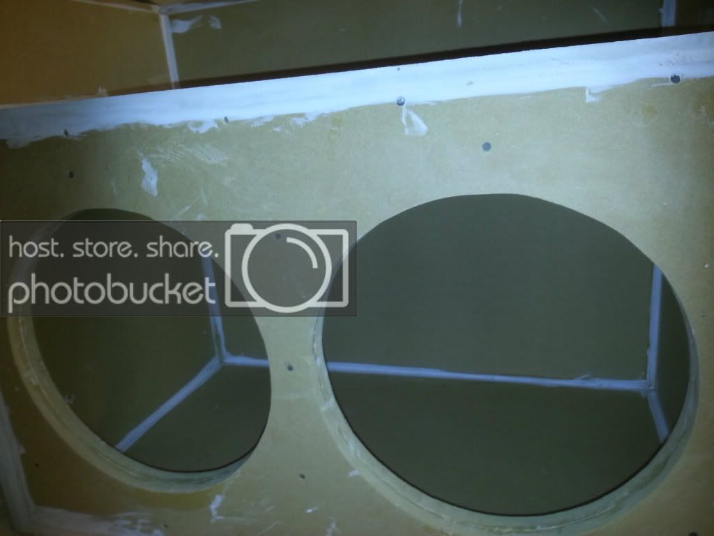

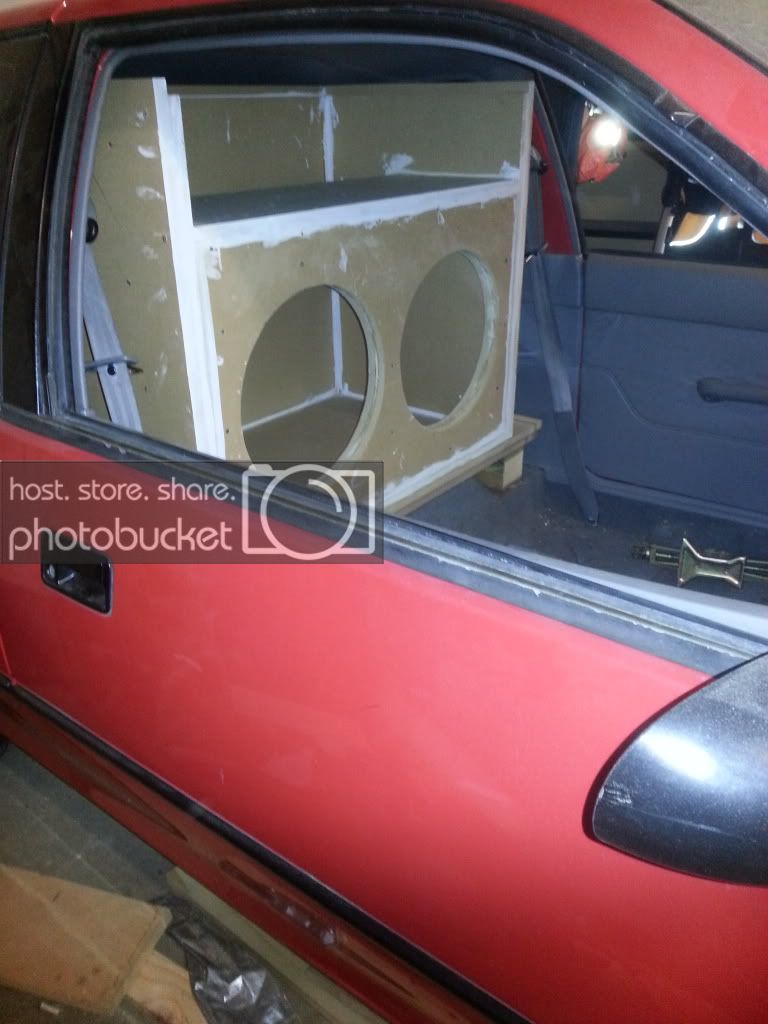

the wife says stop... NOW?? im so close!!!
heres where im at.. the picture is taken on a side... port should be on top of woofers
im going to try what TEAM RIPROCK did before they went to extreme in 2002 with the port on top across from passenger to driver door rather then typical drivers side
