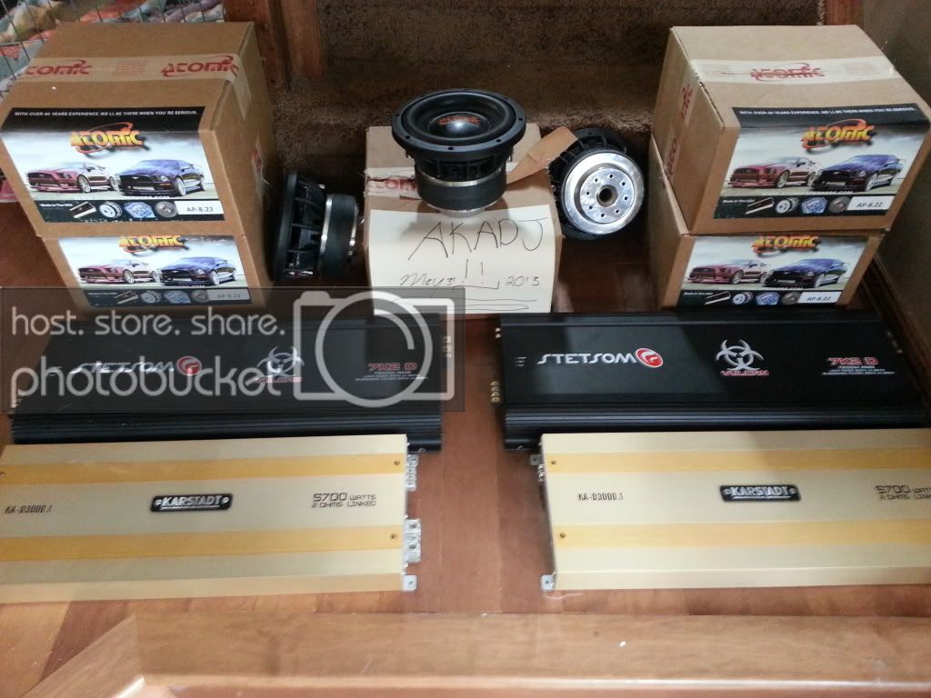

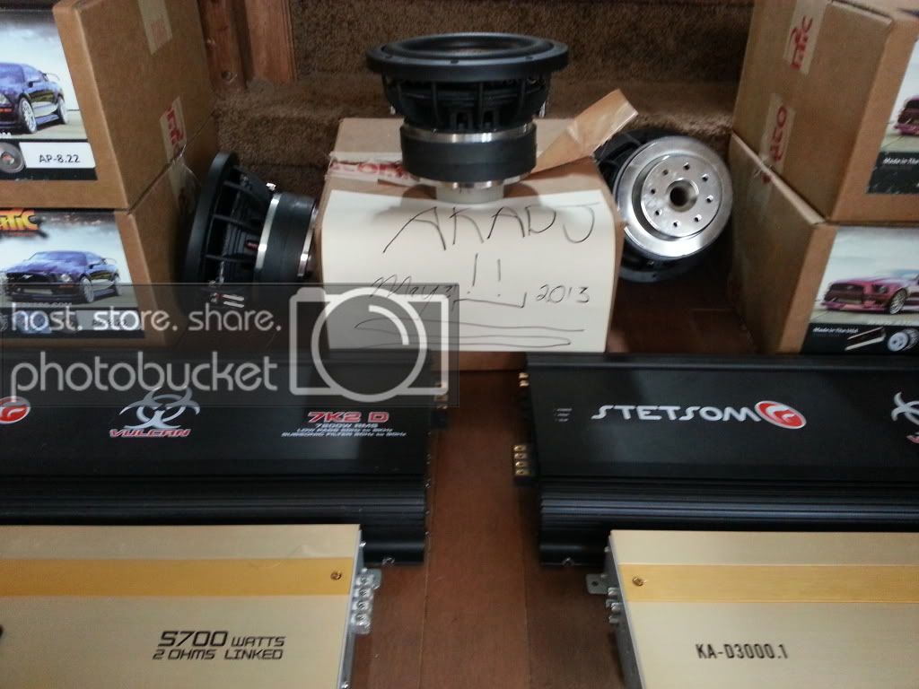

Here's what's come in the mail as of this far... ENJOY! !

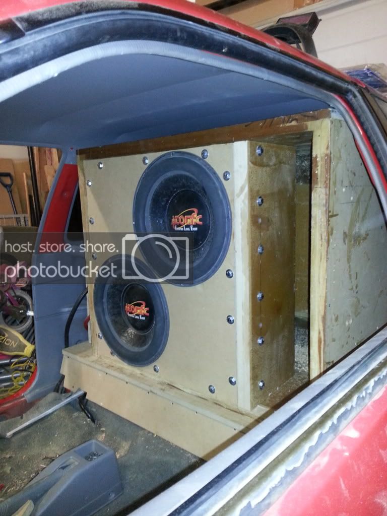

Well I'm starting on making this a 6th order series tuned bandpass wall in the metro.
Here's where I'm at now.

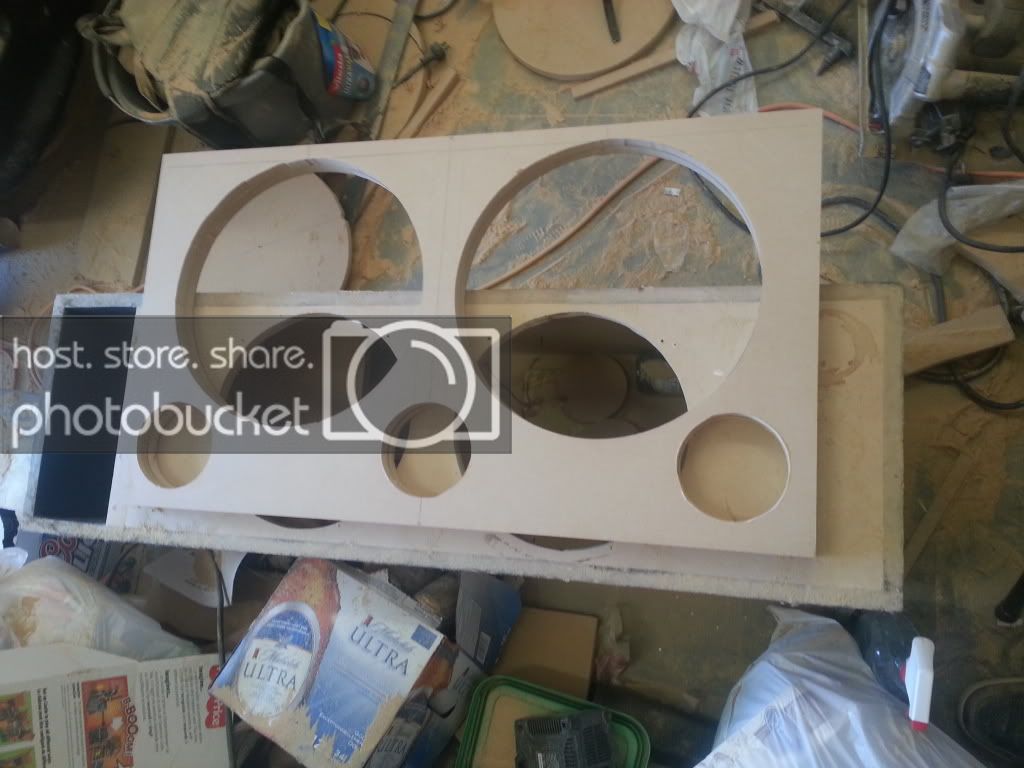

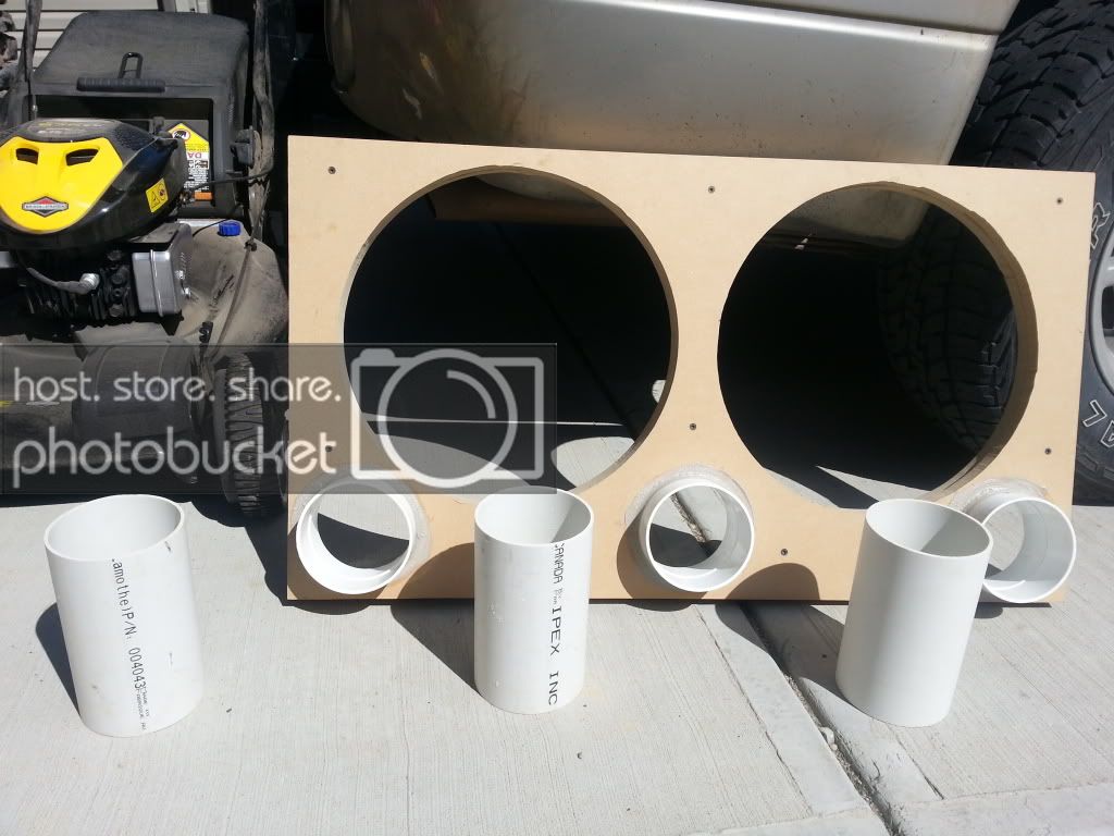

The inside baffle for the two 15's with three 4" ports

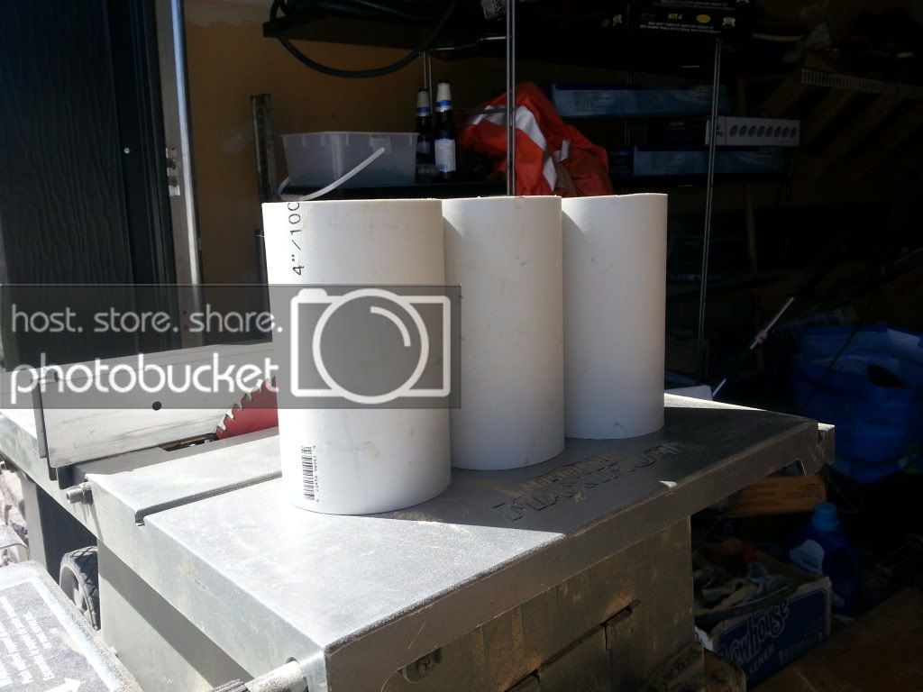

The first set of ports all exactly the same size
The baffle with the couplings so I can swap ports

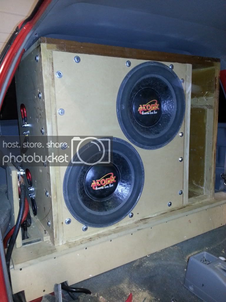

So I started messing around with a 4th order bandpass ... Then went to a 6th order series tuned bandpass and couldn't break 148db legit on The dash with two audio pipe 1500D's

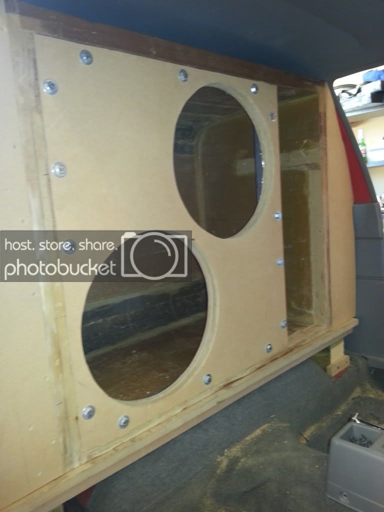

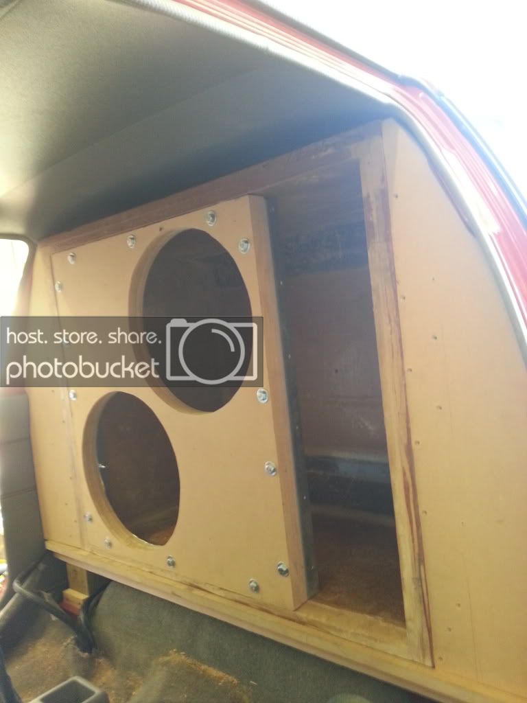

But I've decided its time to go back to basics...The front baffle wall and port are completly removeable and bolted onto an angle iron frame!!
More to come over the next few days!!
OK so I tried it and I'm exactly where I was with the original box design.. But I went the same port area and length as the first design (12" long) so I figured as much ..
Two things I noticed was my tuning is lower now just like Will Lievers 55hz second thing I already knew would happen but is serious amount of sawdust collection in the passenger side of the enclouser.
Next on the list is to shorten the port by half.. (12" down to 6") second is to add a rounded corner in the passenger side
