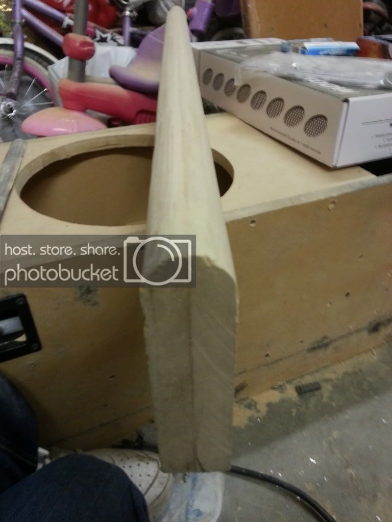

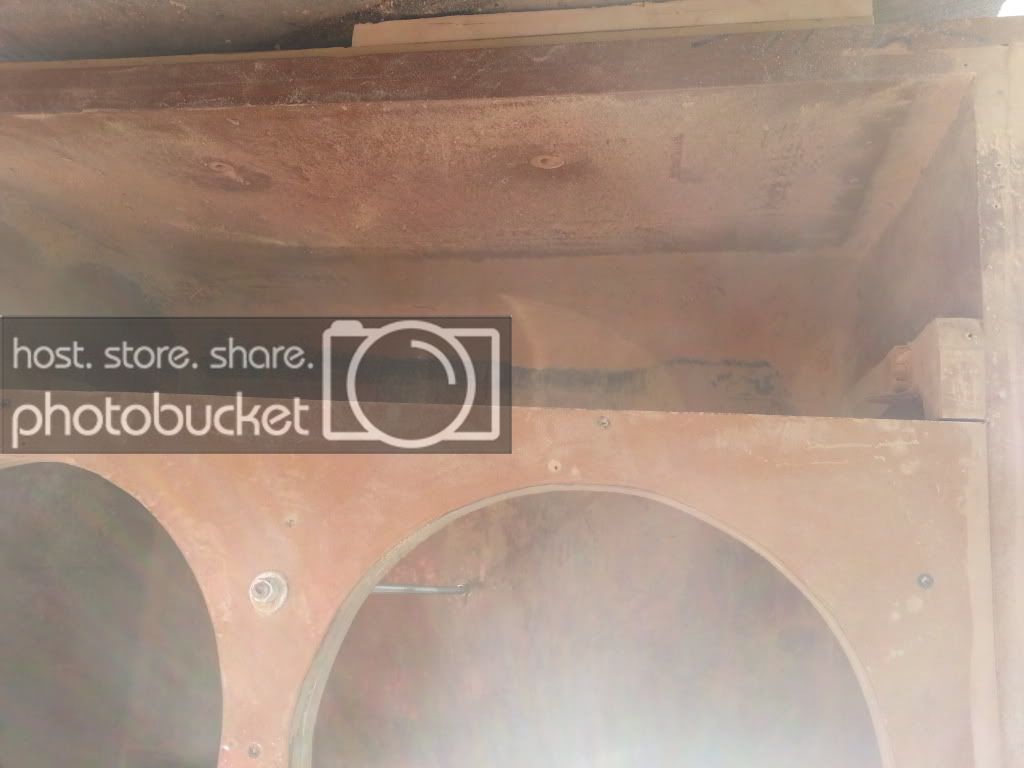

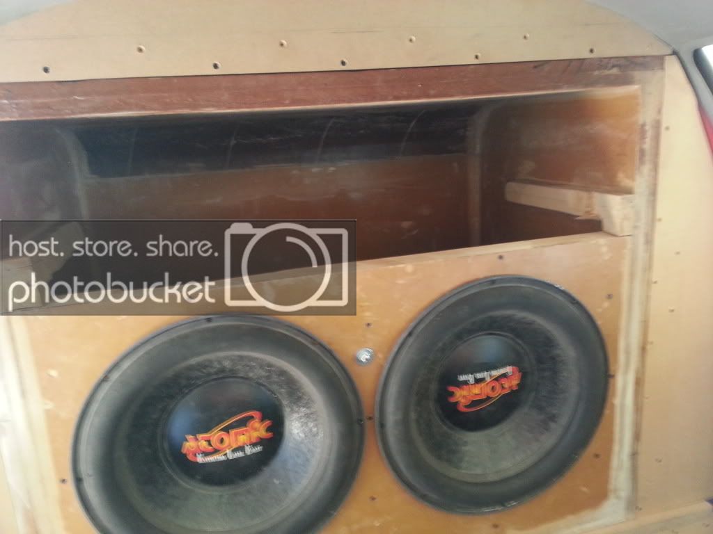

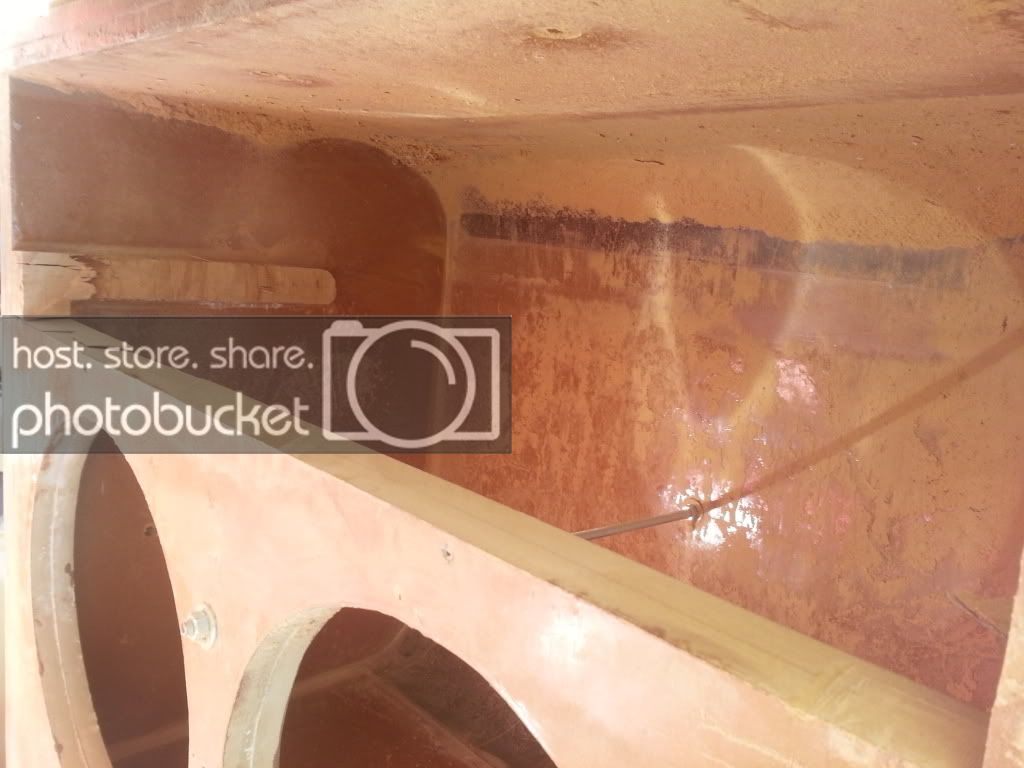

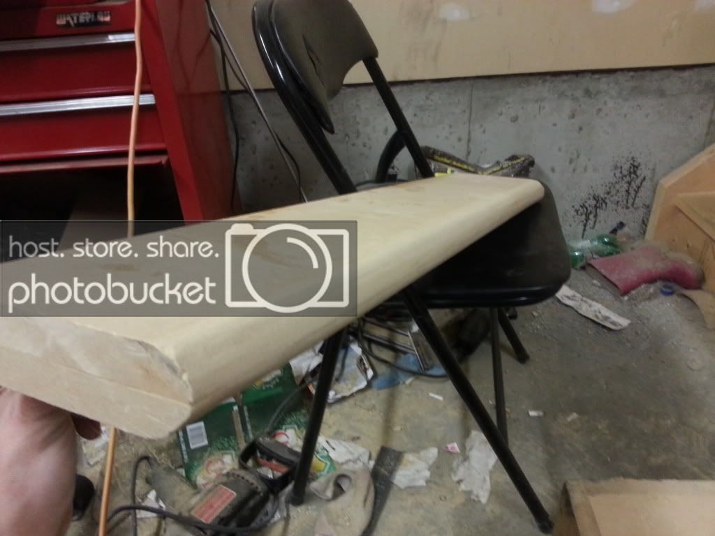

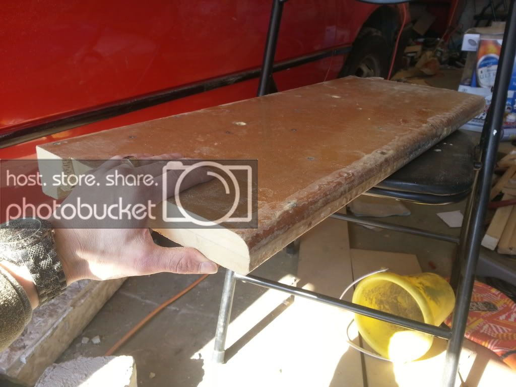

I've started on removing the port and adding an additional 100 square inches!!
I tested it the way it was in the last picture just to see what my max frequency was with zero port length and to get an idea of how long of a port to add..
73 hz was the peak slp which is way to high for this class so im gonna try adding 7.5" of port length and see if i can get back to 60hz
I went down 3 db at 60 hz but went up 3 db at 73 hz the way it is now
