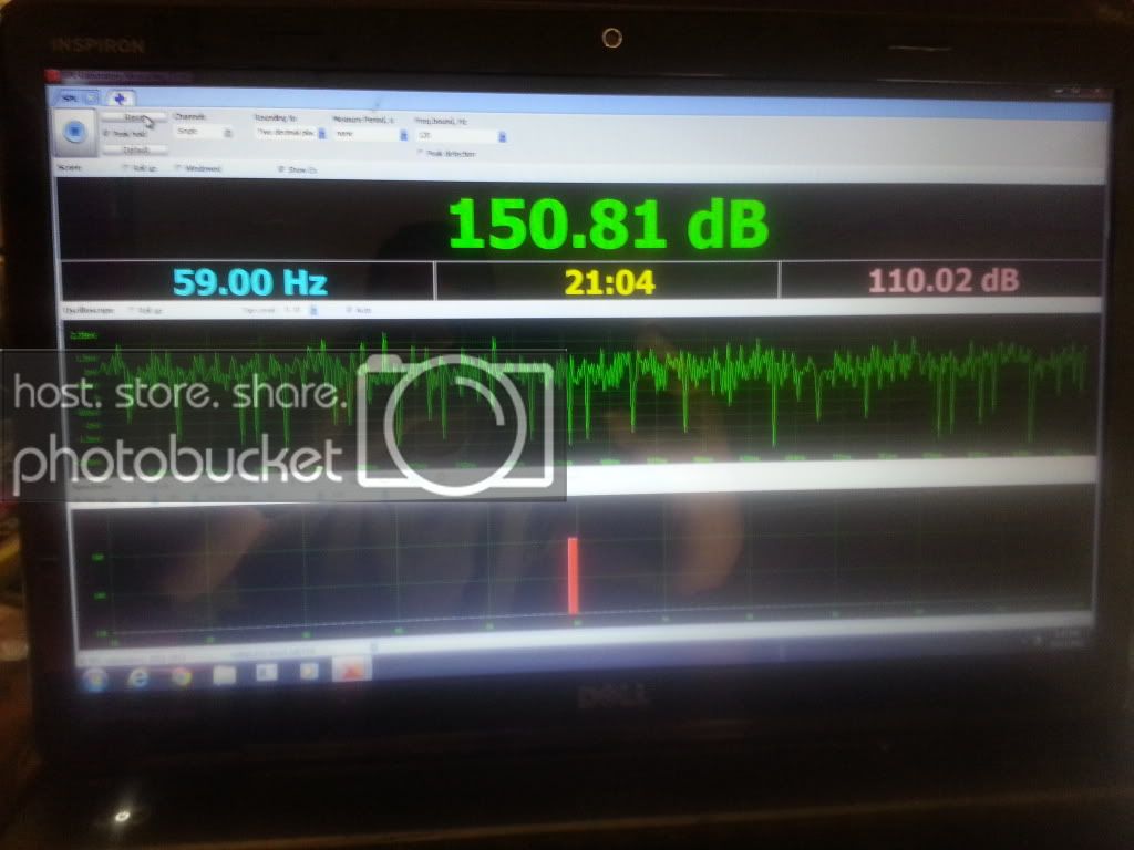

OK so I'm done with this box.. For now anyways. I thought I would do a quick mod or two before I slamm SERIOUS POWER at, it. Here's where we are at with just...
-One 3000 watt KARSTADT amp.. A lot of peeps said.." WTF is that garbage!" Or "next wolfenhagan" LOL
-One stock 55amp GM Metro alternator
-One battery, a D3100 XS POWER (under the HOOD!)
-And like a ton of hard work/testing!
I will test it Tuesday with the two amps strapped and then with ONE Stetsom 7K2D, but I had to see where one amp left off in score!
And of course I made a video to back the numbers but haven't uploaded it yet

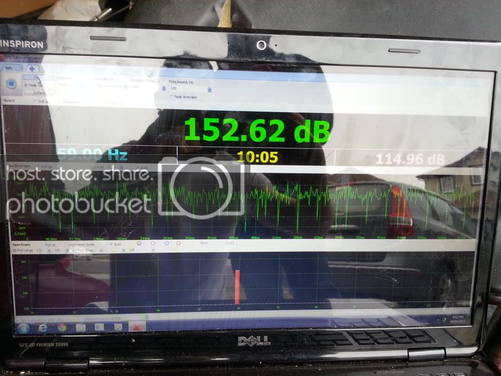

Ahhh so testing today was not the score I was hoping for but considering my electrical (stock 55amp alternator) I think its a wicked gain!!
So I tested both Zenon amps strapped at 0.5 ohms rising to 1.6ohms and they were drawing so much current it was stupid, my voltage dropped down to 8.8 volts (which is no surprise) and didn't want to do any damage so I just stopped and pulled them out. SPL was 152.5dbs
Then I tried the 1 Stetsom 7K2D 18 volt edition and my voltage only dropped to 10.05 which is still terrible but I clamped 6500 RMS out of it at 10 volts, starting at 0.5ohms rising to 0.9 so I'm happy with that. SPL after testing it off a battery that wasnt fresh off the charger and burping different amps all day was 152.62 i did do a 152.85 but with no pics. I doubled my power and got a 2db gain...was hoping for around 2.5dbs but what ever. I'm going to look at getting a custom alternator very soon and sound deadener.
...not by just throwing more power at it based on the results thus far.
The box still needs quite a bit of work - on 6500 watts, you need to get it up into the 157-158 db range (so ~5db gain just in the box/car with current power).

I dont really know how long it stayed at 6500 watts and when my car reached 152/53 dbs. i couldnt watch all meters at the same time... IE voltage input, AC amps, AC volts, SPL meter.. lol but im sure it wasnt long!
I will continue to get the box more efficient that is for sure, i just want to get the voltage sorted out first so any mods after this point at high SPL will be more accurate.
