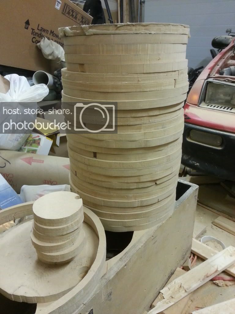

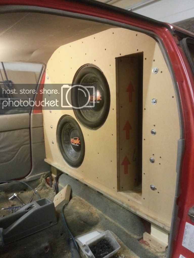

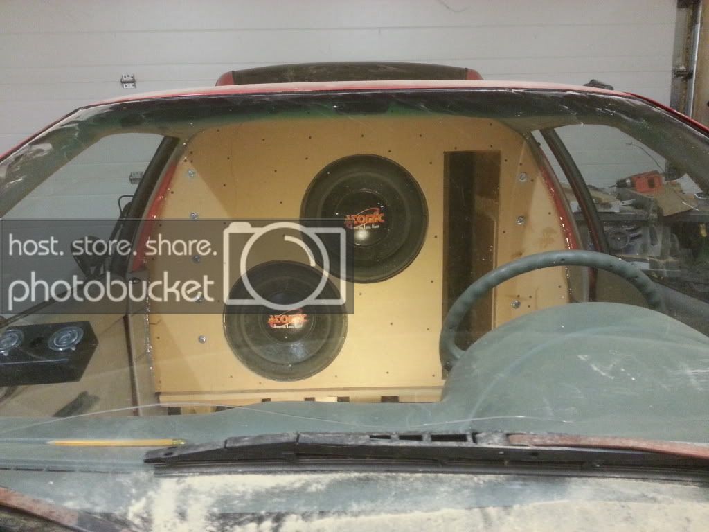

Pics?!
It doesn't look a whole lot different, most of the work is unseen ya know... Adding more wood and baffles everywhere.
4 layers thick on the sides, top, and back.
2 layers thick on the bottom.
7 layers thick on the front baffle.

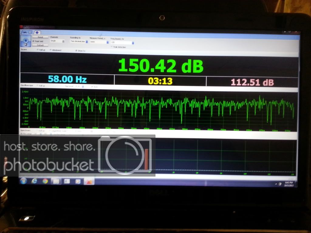

Tomorrow I will run it on the meter and see what happens.
I'll take a video and record the...
DC voltage/amperage draw
Output AC voltage/amperage
And of course the SPL
Here's the video I promised
The AC amperage output meter went over limit but its usually 46 amps.
I don't know if there's a way to post the YouTube video so it plays on this webpage so I'll just throw up the link.
0.5 ohm starting impedance
1.2 ohm box rise
14.5 volts starting
10.98 volts dropping
55.7 AC voltage
46 AC amps
75.2 amps of current draw is what my meter picked up,.. Maybe I had it set wrong, I think it should be higher like 175.2 amps.
2562 watts clamped
Set with oscilloscope to 0% distortion
Looks like its coming along well.
Be sure to round over the back-side of your baffle (behind the woofers), should be several tenths gain there...
Power wise, I would estimate you can get it up to the 153ish range with pair of 15s on 2-2.5kw.
Here's another test.. The first one didn't have all the runs of power wire hooked up to the battery.. Just one positive and negative.. and in this one they are all hooked up.
Still climbing!!
