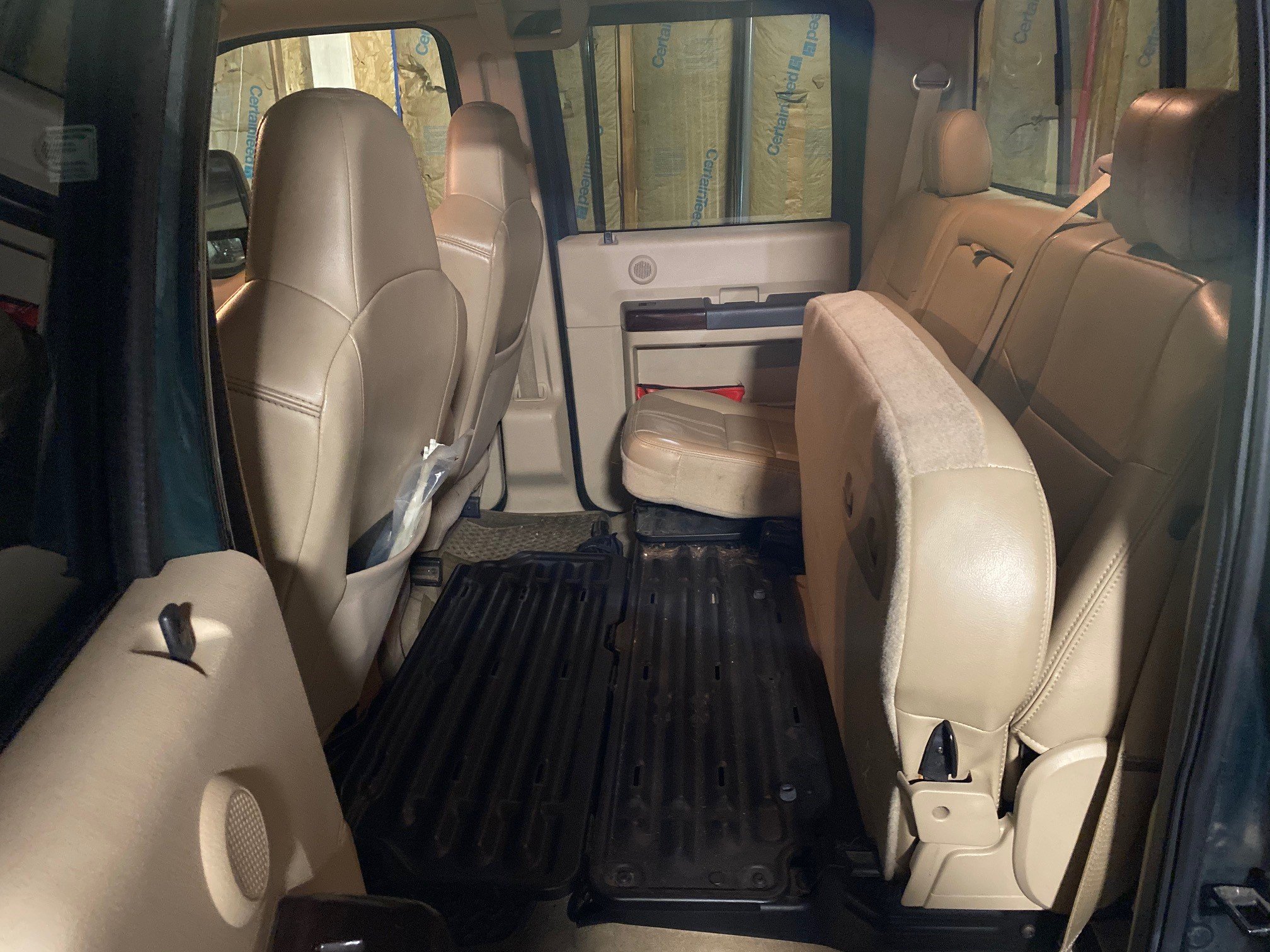

I have two vehicles, a 2008 Ford F-350 Super Duty Crew Cab (full back seats which fold up)

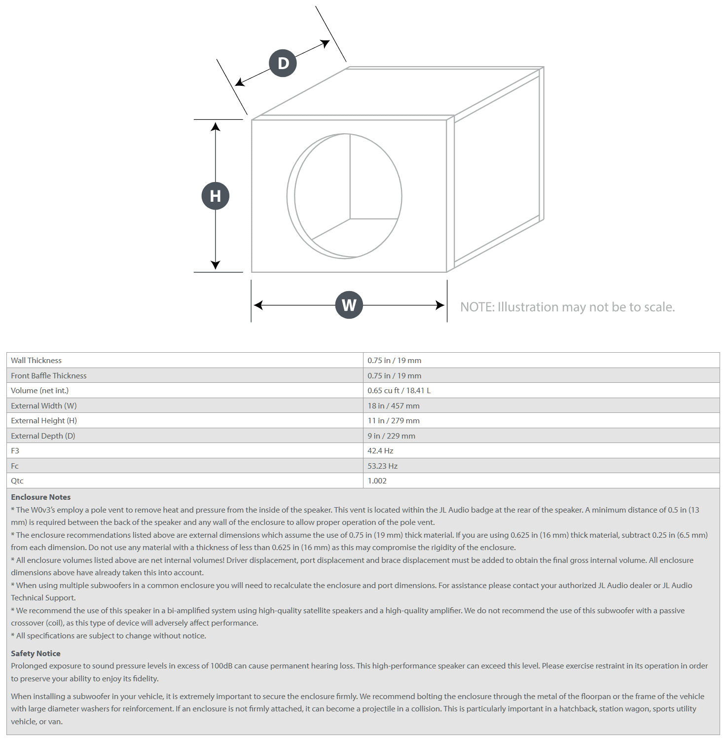

On the sub's webpage (above), they list and show the exact dimensions for both a sealed and ported enclosure (they suggest that a sealed enclosure is smaller and better for all-around response). So, I assume that a sealed enclosure will give me the most flexibility in my multiple vehicle design, and I'd most like mount the amp directly to the enclosure itself (unless that's a bad idea for some reason).

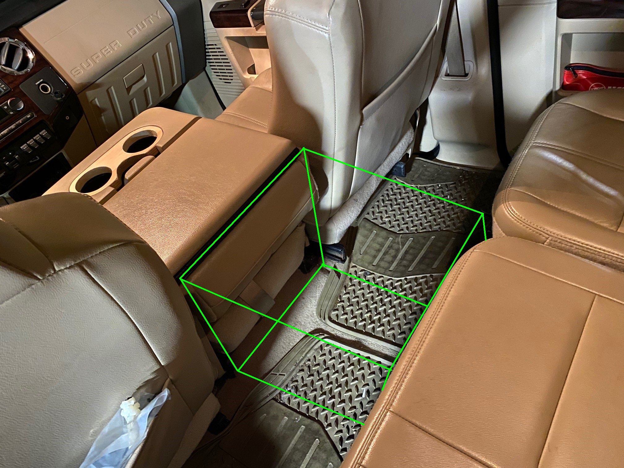

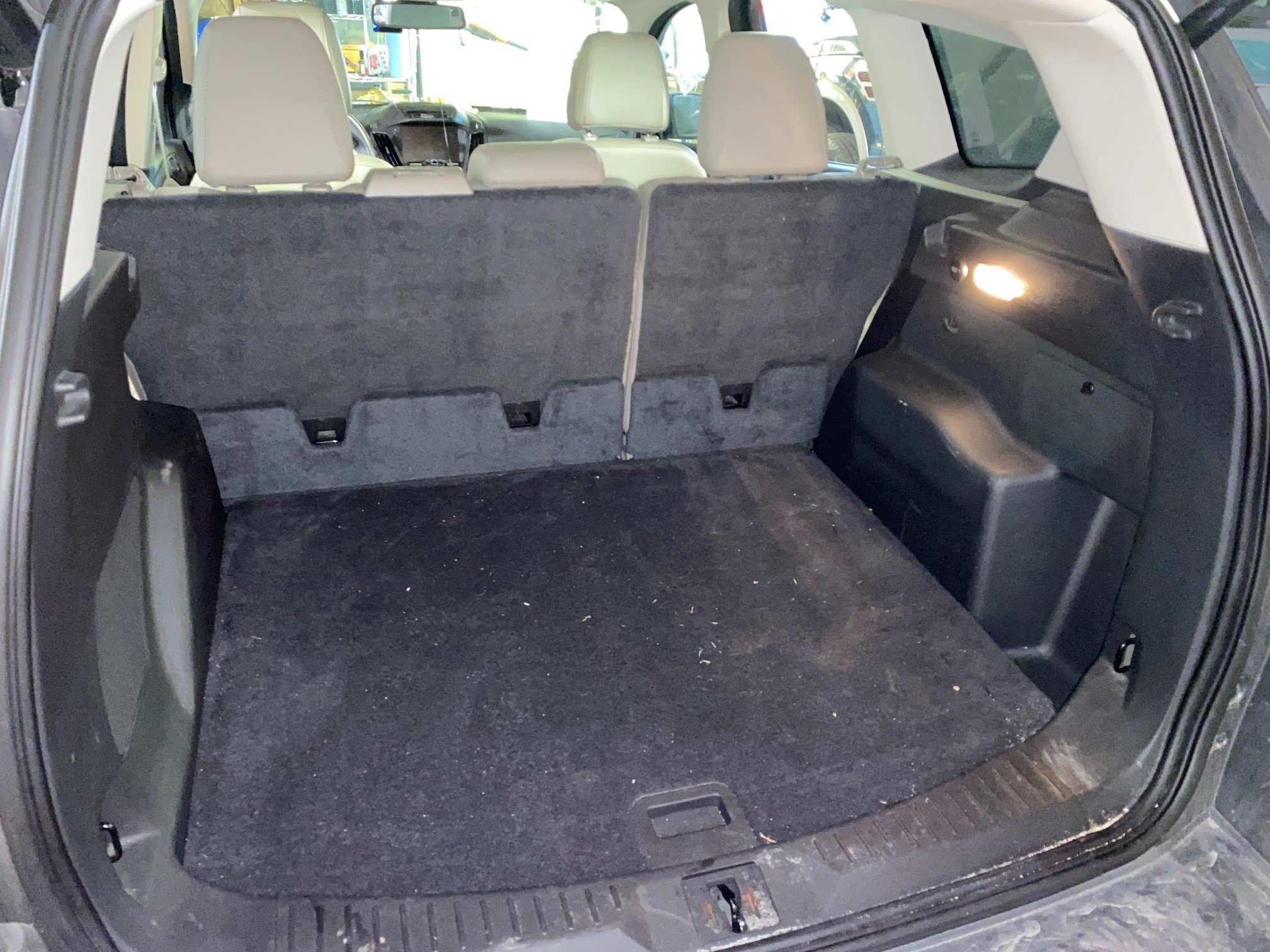

My main concern is the shape and which box to build. I could build a basic rectangular box, or a long & tall thin one. Since the Escape will hold anything, I feel like I should focus on making it fit snugly in this area of the F-350:
21591
Also, a box with their exact dimensions below would fit within this space, but should the sealed box be exactly like that, or can it be modified as long as the interior volume remains at least 0.65 cu ft? And, is that simply the minimum interior volume, or should the interior volume be as close to 0.65 cu ft for the best sound and broad response?

With sealed enclosure the only important dimensions are that it has to physically fit the subwoofer's basket + an inch for venting. If it doesn't have vent holes from the magnet you can get even closer (but touching the other side of the box isn't very good). The rest you're free to use whatever dimensions to achieve the proper space. Also in a sealed enclosure as you go smaller you turn the sub into an air cushion suspension where you get worse and worse efficiency (worse than sealed already is which is the single worst efficiency box type besides free air) and as you get larger than their recommendation you end going towards an infinite baffle setup where the subwoofer is freer to flex, but also freer to hit xmax if you go too far with it. The measurements that manufacturers recommend are generally to get the best of both worlds. In terms of sealed enclosures you're going to get a very even response curve with no peaks, which is the best for any instrumental music and especially kick drums and bass guitars, but not too good for deep tone hip hop and rap music.
With ported they tend to be bigger and those are actually tuned to a certain frequency which is where the peak occurs. A lot of cheap ported boxes are tuned to 35hz which will sound good with deep tone hip hop and rap music, but sound muddy for bass guitars especially. The main advantage to ported is that you get way more effiency and thus can make more noise with a smaller amp and subwoofer rating, but the disadvantage is instrumentals.

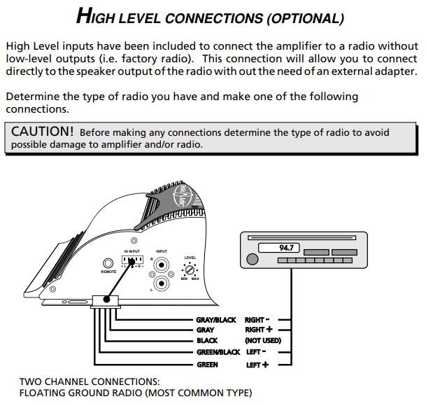

Thanks. I'll stick with a sealed box then, cause I'm after sound quality rather than "loudness". Also, the amp has a high level input, but I'd need to find (or fashion) 2 plugs, one for each vehicle. That way I eliminate the need for rca's and LOC's.

general assumptions about box design types without factoring in cabin gain is dangerous. Without a proper loading wall you will get absolutely no bass. Massive cancellation issues in a truck, going sealed is pretty much bass *******. The type of woofer used has to match with it too. The Theile small parameters used to calculated the efficiency bandwidth product will tell you if the sub can thrive in a ported or sealed or 4th order or 6th order or 1/4 wave transmission line etc... Not every sub will sound good in a sealed, in fact most higher powered subs nowadays hot on the market are absolute garbage in sealed(extremely stiff suspension, high FS, high motorforce aka BL, low QTS high EBP and some sealed boxspecific subs (softer suspension, lower FS, shorting rings higher QTS, low EBP etc...)
Sealed box would only work in one of his cars. while it'll be completely and utterly useless in the truck. Anyone that's tried a sealed box in a truck knows how finicky the cabin gain works with no real loading walls.
