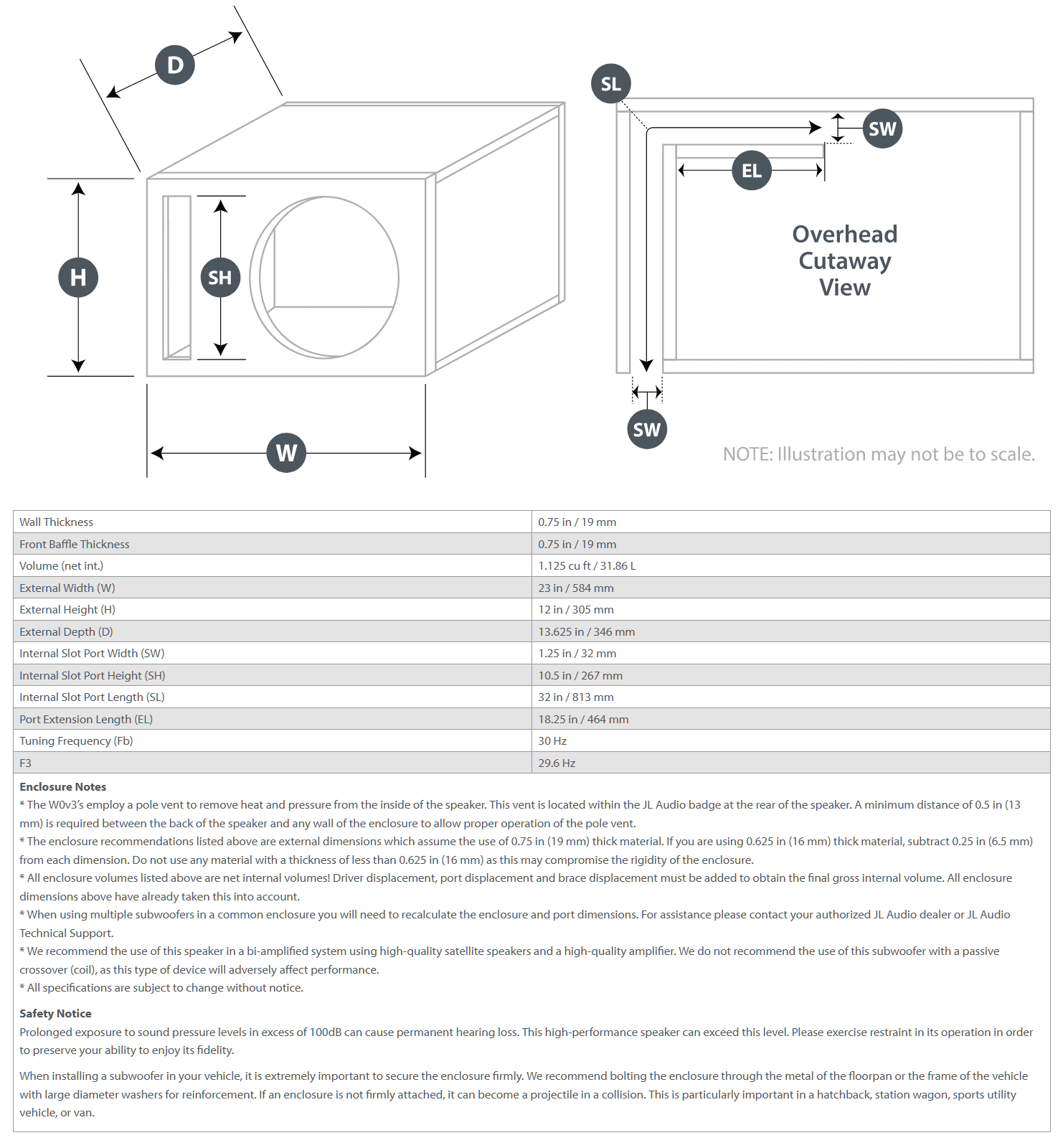

Also, does this help?
21647
Build that design, it will accomplish what you are looking for.
Switching to a round port will make the build easier to cut and assemble. (6 sides and 2 holes)
You can even go to your local lumber store and have them cut the wood to your dimensions so all you have to do is assemble it.
Ill agree along with this.. I mean. Its a 300 watt sub.. and maybe 150-200 rms of true RMS amp power. He is not looking to shake windows out of the truck and looking for a simple enclosure that adds some kind a of bass to the vehicle rather than what he has. I say do it and get busy man. Run IT!
