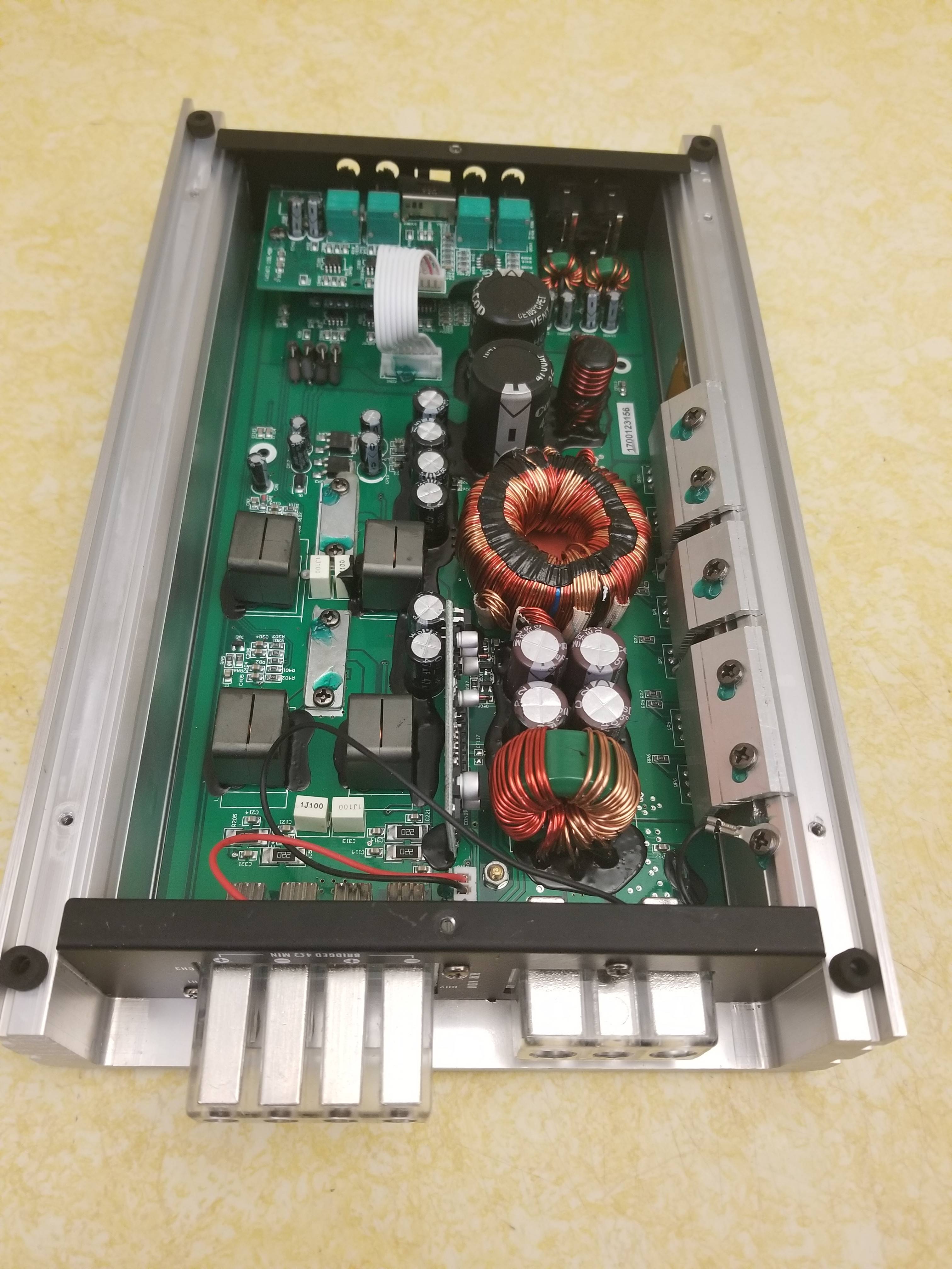

FYI, apparently the new soundstream tn900.4's are not the same as they were. There is a new thread that talks about this (started today) so hopefully you got the older board. Where did you purchase yours?
ordered from amazon and it arrived today, here is the link https://www.amazon.com/Soundstream-TN4-900D-Tarantula-4-Channel-Amplifier/dp/B009NLNY14/ref=sr_1_1?ie=UTF8&qid=1523080897&sr=8-1&keywords=soundstream+tn4.900d&dpID=41RVSF8uDxL&preST=_SX300_QL70_&dpSrc=srch
i have the amp in my hands now, how do i know if its the old or new version? only negative thing i can say is that it didn't come with the 4 gauge to 0 gauge reducers that it says it does online.
[quote name='Clifff150']FYI, apparently the new soundstream tn900.4's are not the same as they were. There is a new thread that talks about this (started today) so hopefully you got the older board. Where did you purchase yours?[/QUOTE]
@Jeffdachef here are the insides of the amp, I'm assuming i got one of the new crappy ones?
