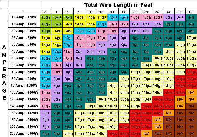

that chart doesnt show my amperage i don't think. I'm calculating 300 amps for my mono and 90 amps for the other, total = 390. front battery to amps will be no more than 17 feet.
the chart shows at 250 amps at 16 ft that 3/0 is required. so if I'm doing 390 amps at 16 ft wouldn't i need like 5/0? or am i thinking about this all wrong lol
Lol. 16ft seems low. Curves n such of the car adds length. Always get more than u think. Two runs of 1/0 should be fine. You also have to remember that music is dynamic and youll never be pulling a full 320 amps at any given time.
