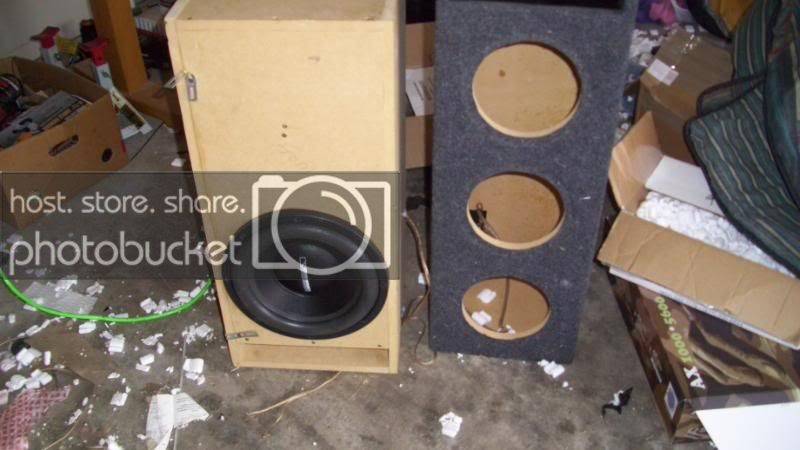

Here is a pic. 30 inches wide by 14 deep and 14 tall. 2 cubes tuned to 32hz. is braced and built with HDF or Truepan, not Home Depot MDF. Built with 2 inch brass screws that were countersunk.
