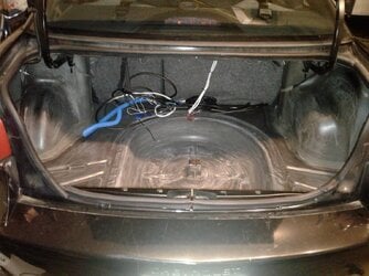

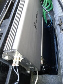

Rear, picked up some stainless steel bolts to do so. Here's some more pics of the build. New rcas, the Knuconceptz, they are massive. The thick black on is my 9cable speedwire for volt meters and then the bass knob and remote turn on cord. Trunk is empty. Nxt will be taking out the old nvx ofc 1/0awg and putting in the new gp ofhc 2/0awg. Then onto trunk mods to fit in new box. Amp rack is still up in the air though.

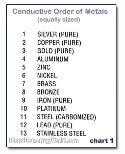

Can't find the chart with the actual numbers but stainless is MUCH worse.
Oh well that is helpful. I will get zinc then. Much higher in conductivity plus it's esy to get at hardware store.

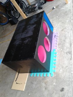

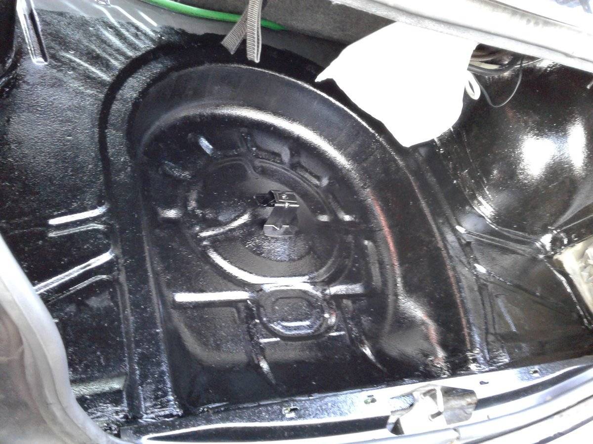

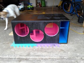

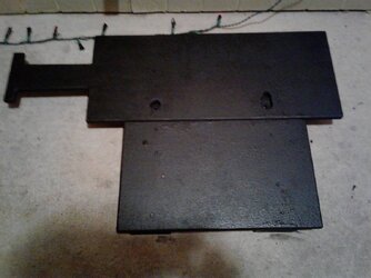

Okay well box is done and last final coat of bedliner is drying. This is my first time using it as the s***s expensive. I didn't realize the vapors, fumes, were so strong that they'd leak into the house from the garage. Like wow. Cost was $20 just to bedliner box. Neways it is done. Anyone have any ideas of a better durable waterproof coating that'd be cheaper and just as effective? Next on the list is trunk prep I'll be doing to tonight.  Gotta cut some pieces out to make it fit, gonna bedliner the spare tire area as well as some other spots. Another $20. But should be good after that. Oh and still have to run new power wire and redo the big 4 then amp rack n what not.

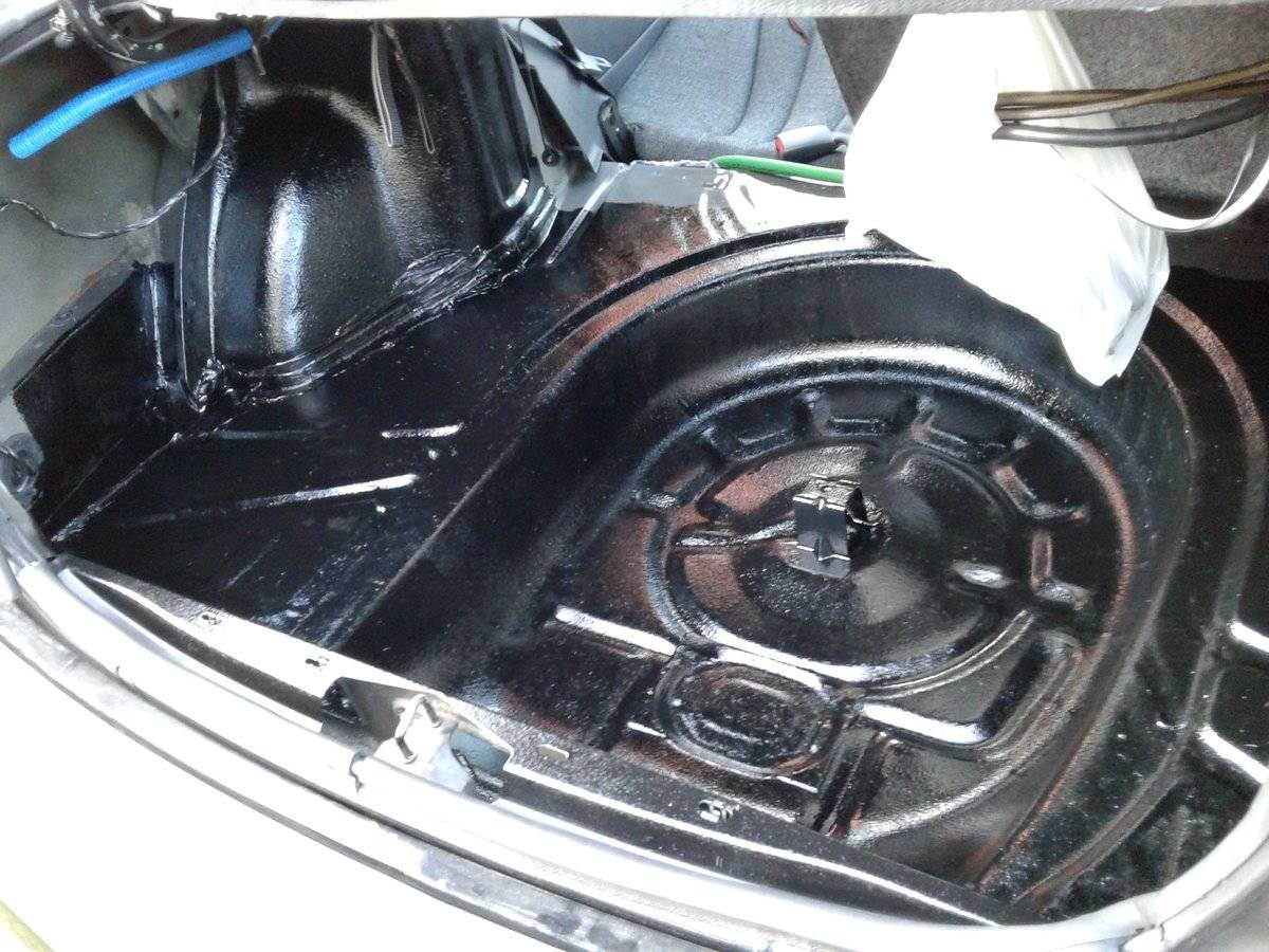

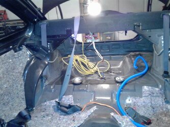

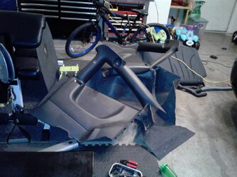

All new wires ran and new power ran. Pieces grinded off smoothed out, trunk ready for bedliner. The wires now run behind the quarter panels in rear above the suspension and even got the blue one, which is A/C to fit.

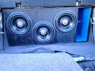

Car all put back together and everything is done bed liner trunk and now waiting for it to cure. I tell u the vapors from this is intense. Had to get a mask.

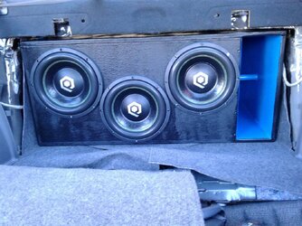

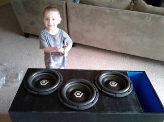

Test fit subs and amp rack drying.  Will mount with 2x4 and double rubber to back of box. Lil man decided to pose for pic.

Came out pretty nice.  Are you going to seal off around the edges?
It did. Still gotta bolt it down to frame. Few minor things. I haven't decided to yet.  I doubt I  will as I won't be losing much through the tiny gaps.

Ah good to know. Thank u. I was thinking of expanding foam but how tacky. That rubber seal would actually look nice. But I'd probly end up just cutting a flush mount beauty plate over the entire front with an entire different color and gasket over the edge to create a perfect seal held in by magnets to be easily removed. However, that is only if it starts to stinking in the summer time. It's almost all done and wired up then I'll take some pics n show how it turned out. Definitely not how I wanted it to but f-it. Good enough. Box ended up being to tall and had to take out auto trunk opener. Or the spring loaded bars.

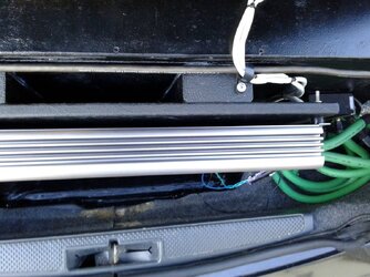

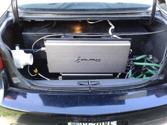

Build is all done! Now I'm having one major issue. The amps are vibrating like crazy. Ugh. Fml. All done started playing music then that happened. So the amp rack is bolted to the back of the box via a 3/8 thick threaded rod about 4 inches long. Then I glued two pieces of rubber together ( old xmas matt I  recycled) they are almost half inch thick then 2 2x4s. The amp rack is screwed to the 2x4s then the amps themselves are on rubber ft. They are vibrating but the box isn't.  Plz help. Should I  replace the 2x4 with 3 5/8 mdf glued together. Would that work?

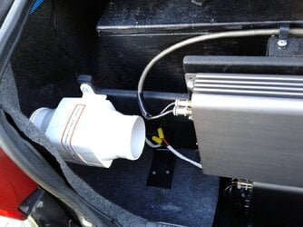

Also build pics. So the bus bar and all wires were suppose to be hidden inside the spare tire well. But ended up scratching that as it woulda been a pain in the arse. I plan on putting all this into new vehicle so made sure to cut the ofc wire a bit longer. And wires better hidden. Was gonna paint fan. Neways here are pics.
