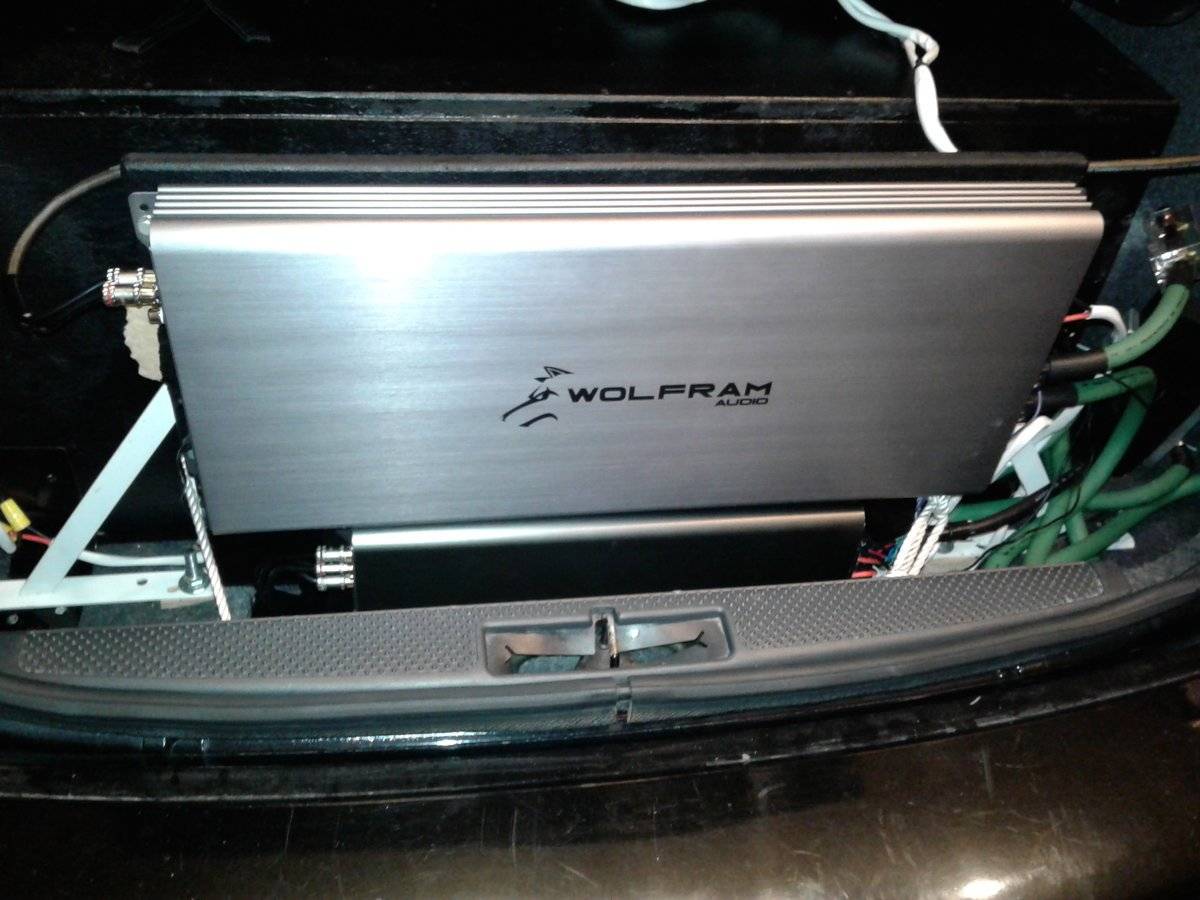

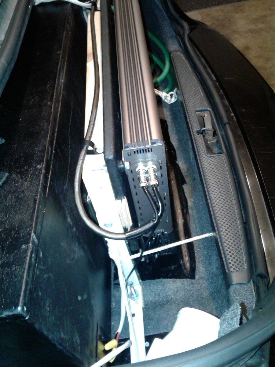

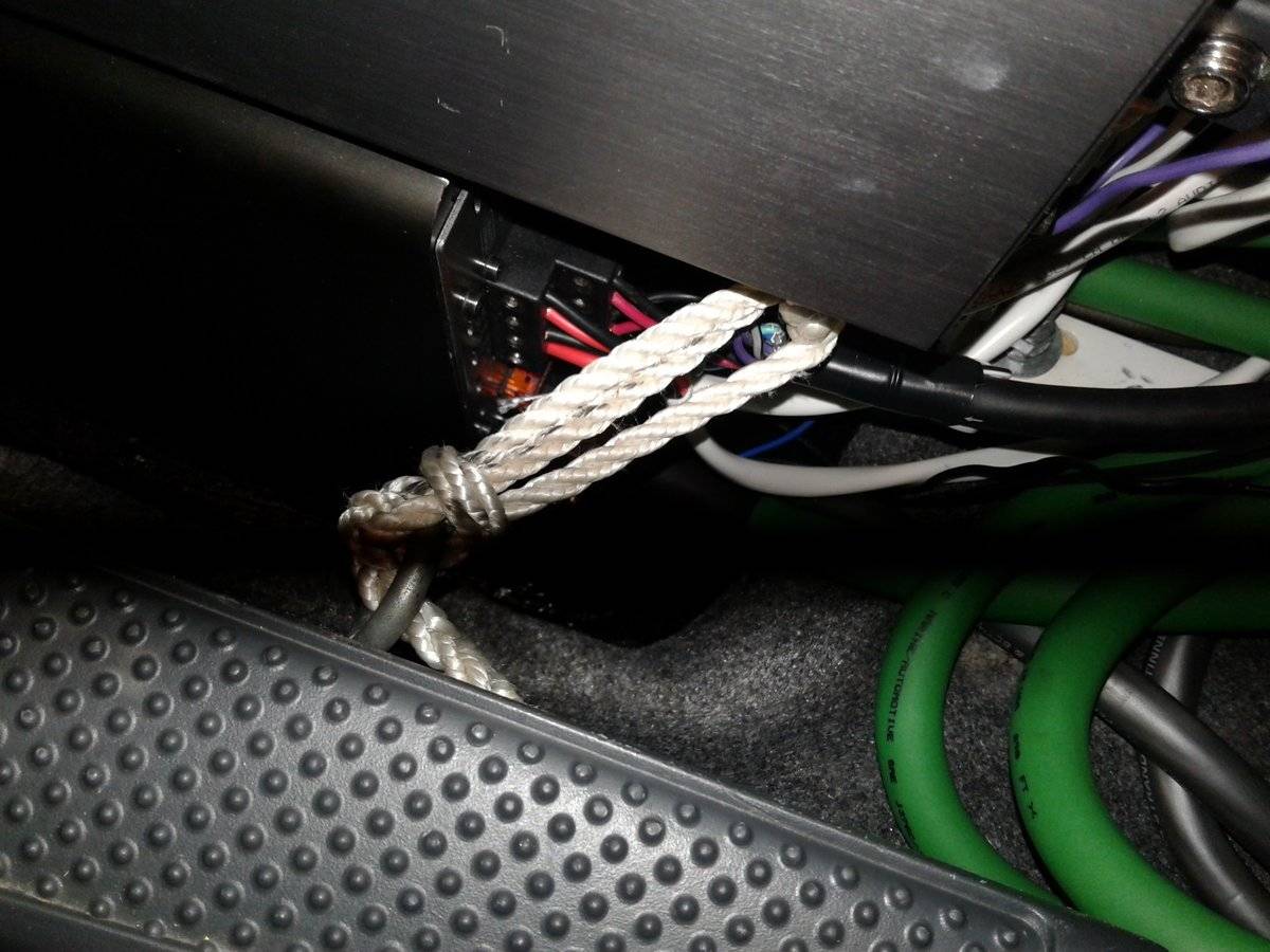

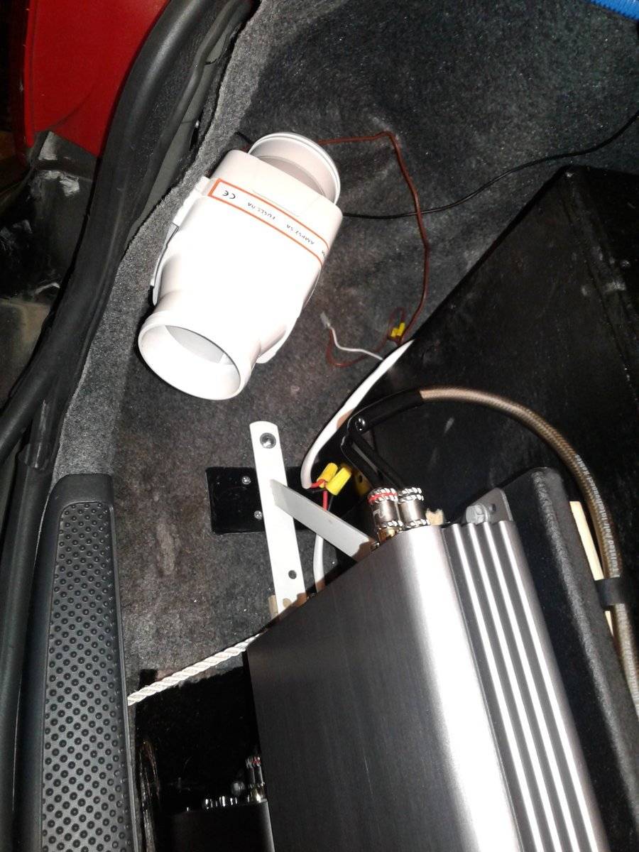

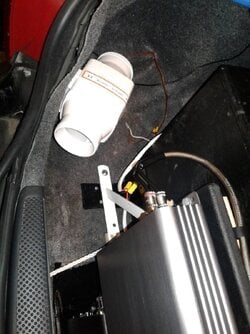

Okay so I  hope this works. I built the amp rack out of 2x4's stacked and glued then screw amp racks onto them and bolted down Amps with rubber boots. I have the L-brackets one on each side, bolted to frame of car with 3/8 threaded rods and additional bolts in holes. I also have two 4 inch wood bolts attaching the L-brackets two amp 2 on each side. So after this I  tested by as u said sticking my head to amo and vibrated the shit outta me. So I  figured I  needed perpendicular support to amp rack. Only option as seen in pick was eye bolt and rope tightened down and had to move fan (fan should be fine there as it'll move plenty of air and the a/c pipe is right behind it up high) I'm hoping that this fixes the issue. Any ideas if this doesn't work to reduce vibration? Maybe rubber between L-brackets and frame of car??

For now I  still have vibration on amps and rack. Gonna try a piece of rubber between L-brackets and frame. The vibration is almost gone but not quite.

hispls this is the amp rack  of box and the current issue.
