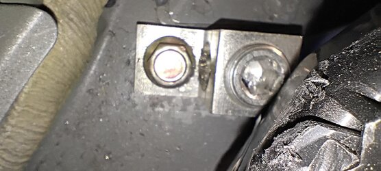

I really appreciate the feedback and in a positive, professional form, I been stressed out for months on this voltage issue. There are 2 more things I thought I'd bring up, I set my gain with an o scope and went a little higher than 75% and signal was clean. I also was never able to get the amp bass knob to match the dash voltage, it (amp) would max at 11.9-12 volts but if I had the A/C maxed I can get it to 13.5-14v.
My amp ground was on the exact opposite side of the factory ground location in the trunk. I used a knukonceptz ground set screw block.
The voltage reading discrepancy is normal. First off from what I see online, your battery gauge on your dash is analog so no matter how you read it it's going to be slightly off. 2nd is the wiring path to get to your gauge cluster will cause voltage to drop off due to the resistance from the long path and skinny wires. Testing it at your amp there is little to no resistance so your reading will be more accurate. For instance my bass knob has a built in voltage indicator and it usually reads .3 or .4 volts off what I read at the terminals with a multimeter.
Grounding location isn't as important as how clean the connection is. Obviously there will be spots that will give you no complete circuit because there is no path to the battery ground terminal. Your amp is working so you have a circuit, but it could be that the connection isn't great. I can't see how well you've cleaned up the surface of your ground location cause you have the block on there, but when you should have bare shiny metal for the best connection and make sure the entire block is making connection. If there is an air gap between the block and the ground surface it won't make good connection and will corrode because heat will build up between the block and ground surface.

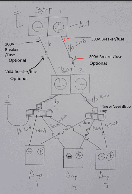

This covers the gamut. Let me know if you have any questions.

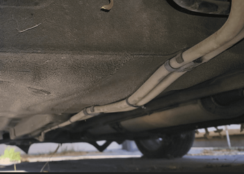

The fuses marked optional are there because I run the wire under my car to the rear and up through the sheet metal. Even though I use 2/0 gauge nylon gromets, in the event they loosen or crack and the power line or ground gets worn thorough, I have the extra fuses/breakers to prevent fires on either end.

My LifePo4 is almost the same as the AGM. The charging voltage is the qualifier and 13.9 - 14.4 to 14.8 isn't significant enough difference to warrant an isolator.
but if you want one, I had this one laying around and used it anyway. It allows me to shut the rear setup off from the primary electrical with a touch of a button.
