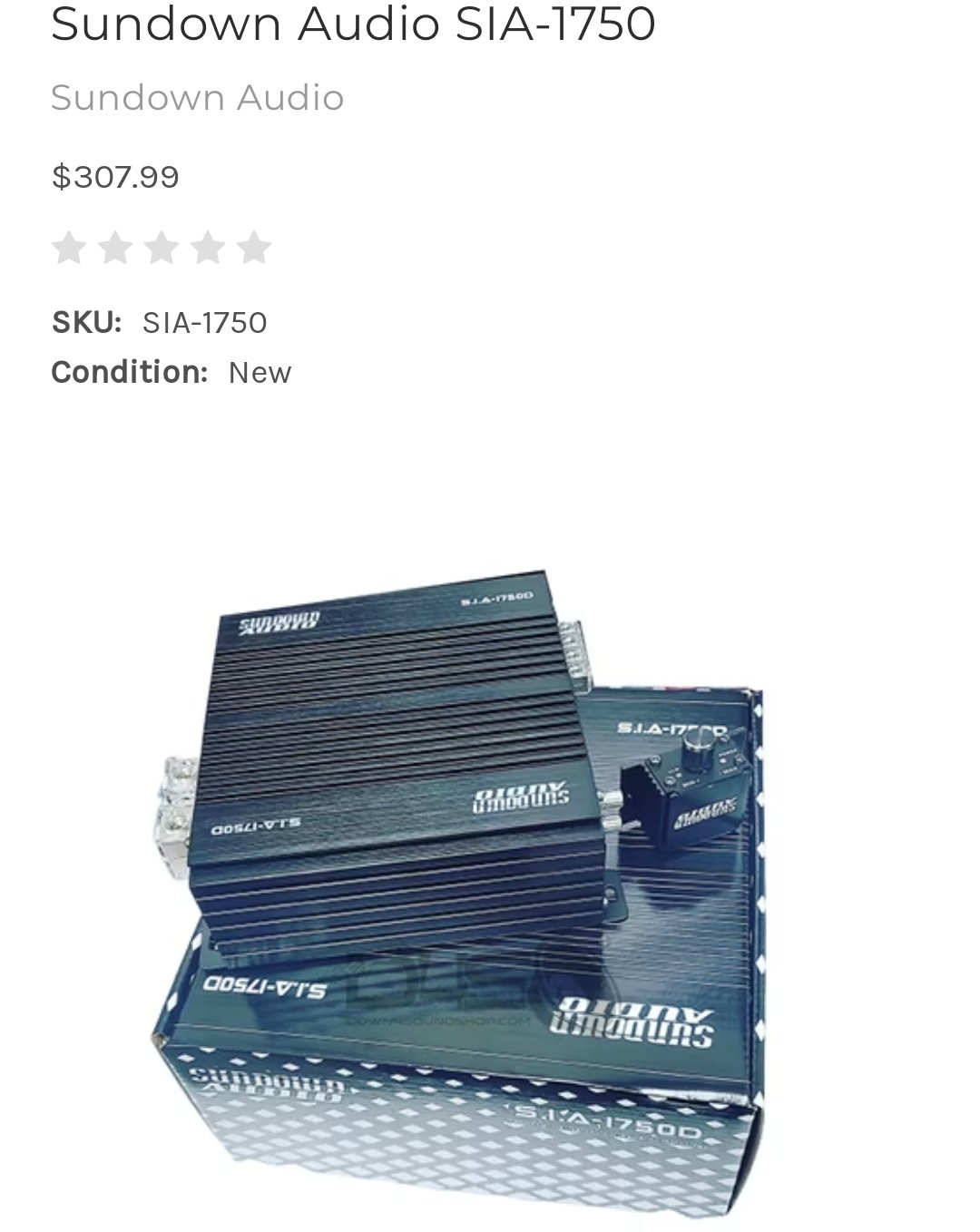

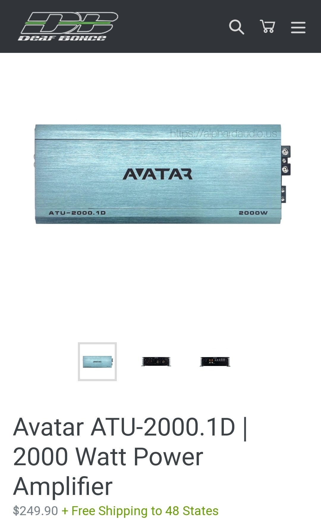

Either one of these. Make sure that you have a bass knob with a clipping light as well.
