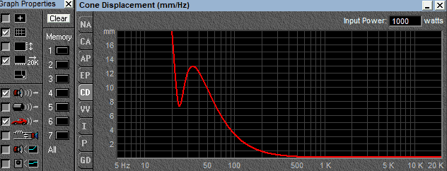

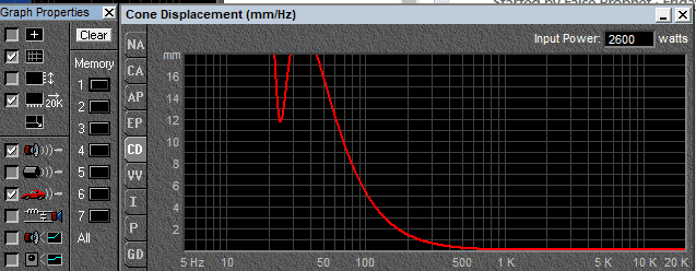

At the given Pe rate of 1000 watts, in a box with a Vb of 4.69 cu ft (that is after displacement for port, driver and braces (about .35 cu ft) your cone displacement is as follows:
Okay at 1000 watts
Not acceptable at 2600 watts

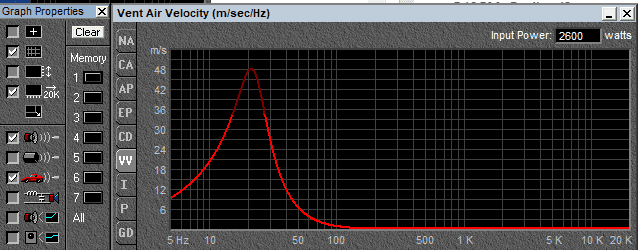

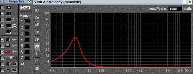

Vent velocity with a 6" round (didn't calculate a slot port, don;t know the dimensions but the area of a 6" port is 28.27" sq Inches) vent that is 22.35" long
Acceptable at 1000 watts
