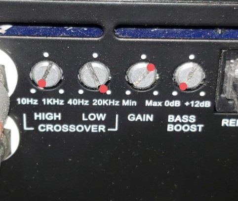

I ended up getting the SIA-2500. It puts out good power on my stock electrical with the gain adjusted accordingly. Have it on my American Bass Hawk 1244 in a box I built 2.0 net tuned to 30hz 24 inches of port area. The only problem I'm having is that the sub is playing well above 80hz which is the crossover point I have set on my headunit. I noticed it because I was watching it while the intro to a song was playing and before the bass dropped I could see the cone moving with the vocals slightly. So I went on my frequency generator and set the frequency to 120 and it was coming thru the sub nice and clear so I went to my amp to check the crossovers and they looked fine. So I turned both the low pass and the high pass to their lowest settings and it did nothing. So I went back to the headunit and set the lpf to 30hz and it made most of the high frequency go away but I could still hear lower male vocals.
Any solutions?

Is there a db/octave slope setting on your crossover? Are you sure that head unit crossover applies to the sub amp RCA’s or is it just the sub amp’s crossovers you’re having issues with?
Are you saying, also, that your sub amp crossovers on the amp itself aren’t working?
Sorry didn't word that well. What I meant to say was I had the crossovers set the same way on my headunit and my old SFB2k and I did t have this issue. The slope on my headunit is set to the default -12db
Set that at -24 db, if you can. Is the head unit only a low pass filter? Do you have crossovers on your amp?
Yea it only has lpf that I can see for the sub. It's Kenwood unit. The amp has crossovers, but last night they didnt seam to do much. It's the same layout as the picture that Bobby posted
What’s the db/octave slope on your amp? It should say somewhere close to the amp crossovers.
