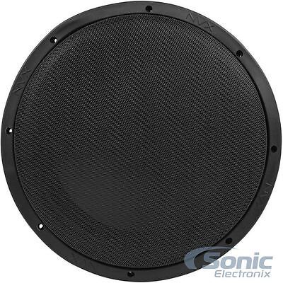

The NVX linked to are very good subs. Way above factory grade for sure - even good OEM's won't compete. The frills are pretty stout and for most of the stuff you'll throw on top, fine. Thatis a beuaty of a box and should work

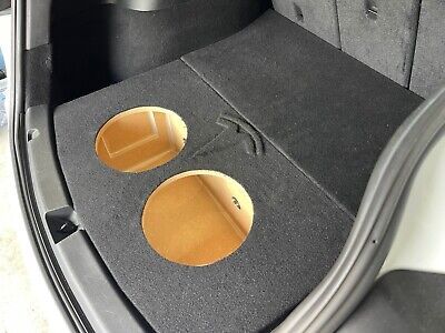

Revisiting the https://www.zenclosures.com/category-s/215.htm indicates that the chamber for the box listed above is 1.4 cubic ft, which is WAY too small for dual ported 12s. That said, it would be aswesone fro two sealed/stuffed NVX 10s

If you went with a rear firing box, you will need something in the 3.85 - 4 cubic foot range to go ported. That's a pretty big box!
Dual NVX carbon 10s (stuffed cavity) in that Tesla box,will handle upwards of 1600 watts and that's pretty damn loud!

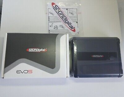

Solid amp 800 watts at 2ohms
