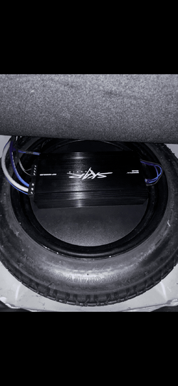

I’d like to utilize his existing bass knob. Does that connect anywhere to one of the running wires to the amp somewhere? How does this work so that it’s functional when everything is hooked up.
Those are usually amp specific; but you can check the wire behind it to see if your amp's knob can plug right in.
The wire should be in the trunk. Check to see if it fits into the amp (amp off).
The plot thickens.
This is the setup in my old Acura with my amp. Is that grey wire on the right side the bass knob wire by any chance?
