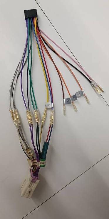

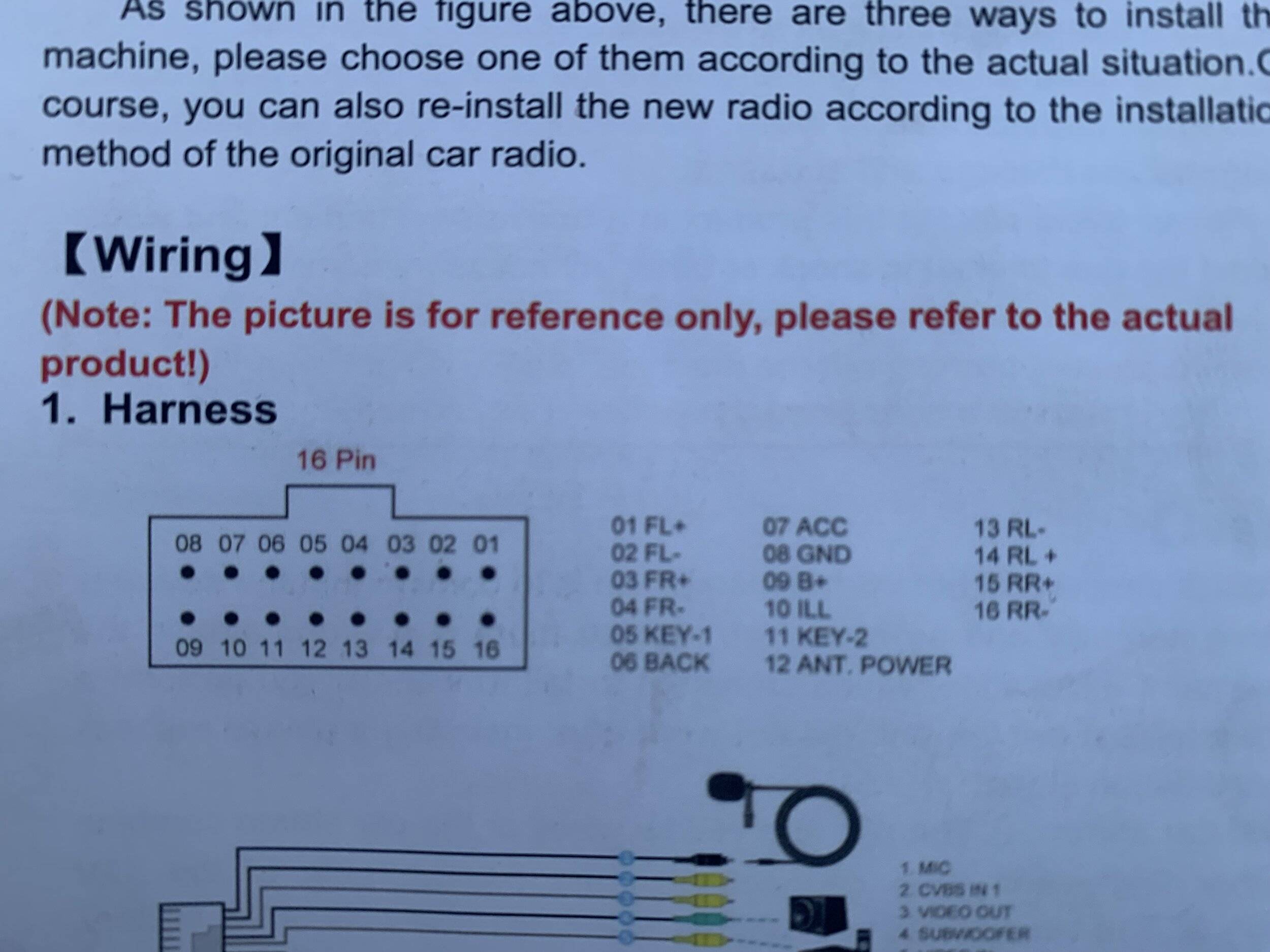

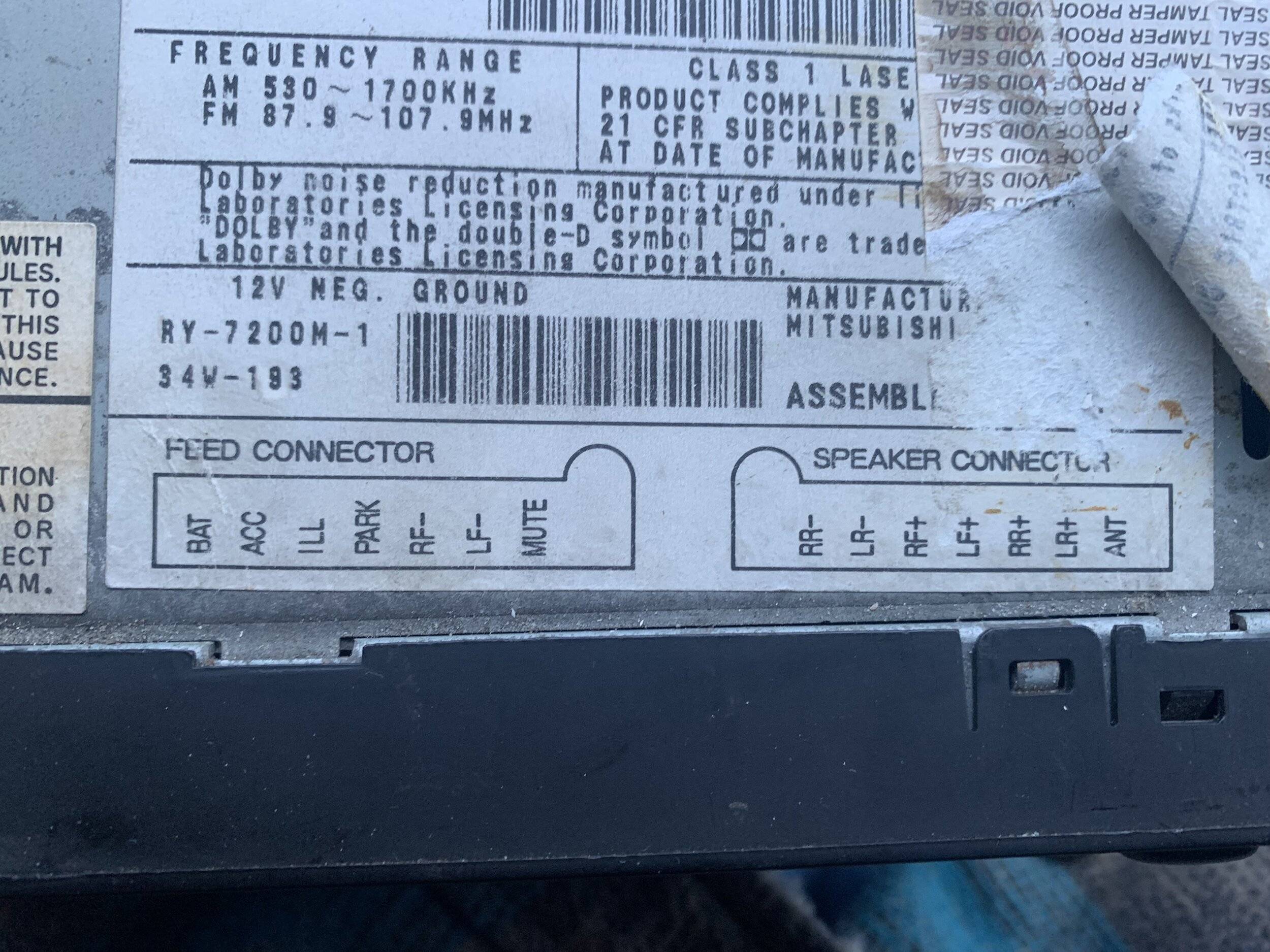

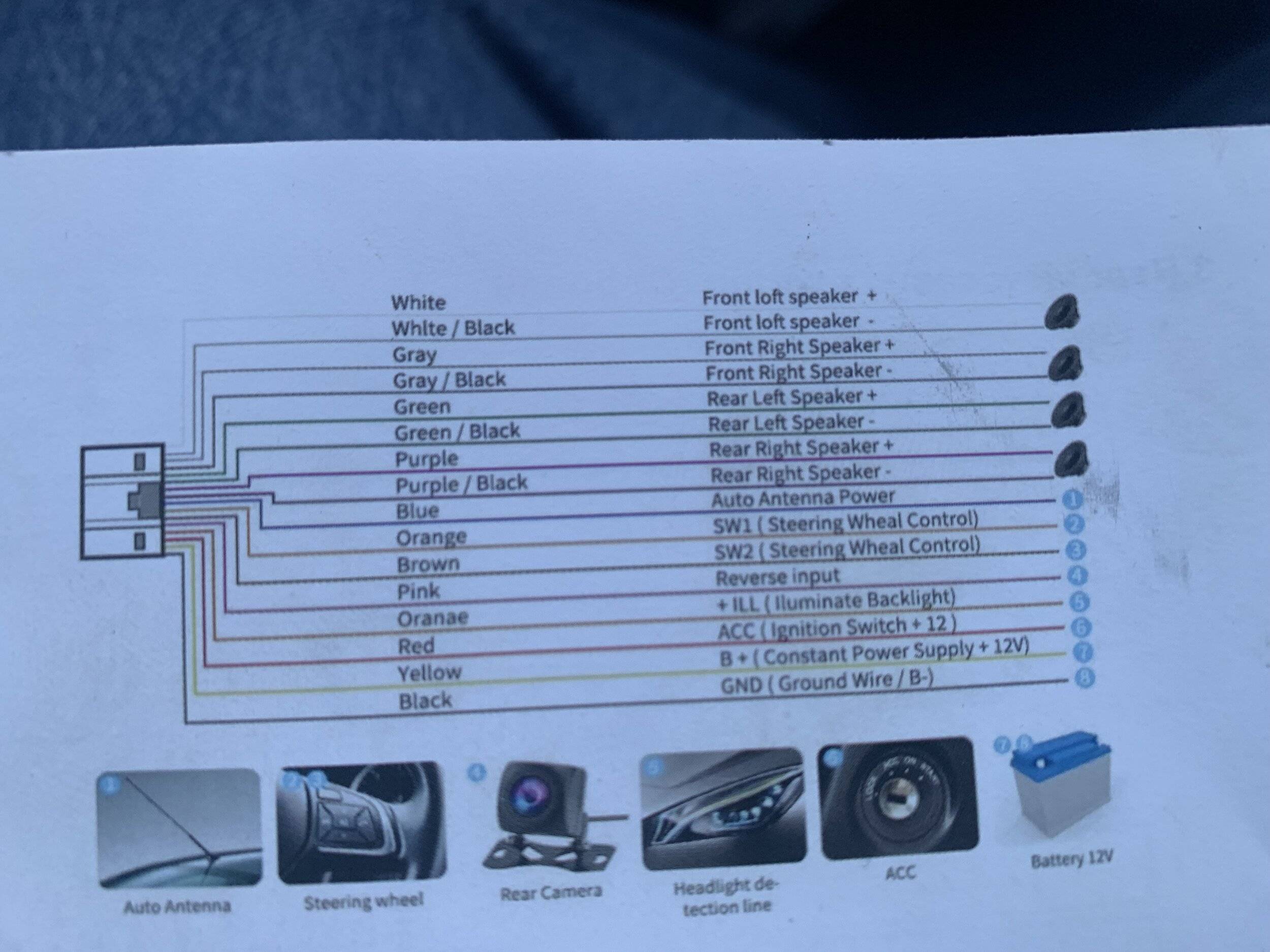

Here is the wiring diagram from the original radio as well as the new radio. We aren’t sure which wires to connect to which other wires(from the back of the radio to the cut stock wires). The speaker wires will be easy enough to figure out, it’s just the power, ignition and ground we’re not having luck with. We wired the head unit right to the battery (+ and -) and it fired up. It’s the wires in the dash that have us confounded

Acc is trigger wire to turn radio on
it's pin 7
Bottom diagram its red
Gnd is ground pin 8
Black wire on bottom diagram
Head unit ground wire can also just be grounded to some structural metal inside the dash
Bat or B+ is power pin 9
And yellow on bottom diagram

On the head unit some of the wires are piggybacked and split off into TWO wires. Why would that be? Can we just twist them together or do they have another purpose?
Thank you for all your help! We got it working and figured out the speaker wires. I do have questions- 1- what does the “illumination” wire do?
2- what does the “park” wire do?
Are these needed or can we just tape them off, as the unit appears to work without them being hooked up.
Illumination is probably for your dash dimmer to dim headunit with dash
Disconnected it will probably just stay at a fixed brightness
I'm not sure what park wire does
I'm suspecting to sense when ur in park for something that does something 🤷‍♂️
