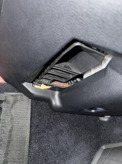

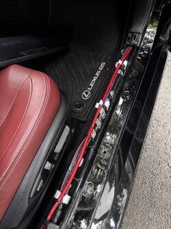

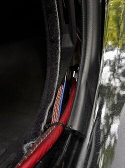

So the RCA’s are definitely running up to the front and towards the direction of the factory head unit. I’m going to post the photos separately. It won’t let me on mobile.
If that is the case, you can just ignore those. What you want to do is connect the LOC to the OEM subwoofer wires. Use a digital LOC so you can have a remote wire at hand.

I don’t think he did. It’s very hard to install an aftermarket radio in this car. And if he did what would be the reason for him spending $600 on a CarPlay module…
Good point. Only reason I assumed aftermarket radio was because the remote wire also runs along the RCA cables. I thought about the LOC being behind the radio but it would be harder to install it there than out back so it kind of made no sense.

I’m not sure how difficult it is to remove the radio. But it’s definitely not as easy as other cars. I don’t think the LOC was in the front. I suspect that it was in the trunk of the vehicle, as so does my local audio shop think the same. This explains how the dealership could’ve easily removed it for themselves, rather than the thought of them taking apart the dash and radio to get behind without knowing if it was truly there to begin with…
